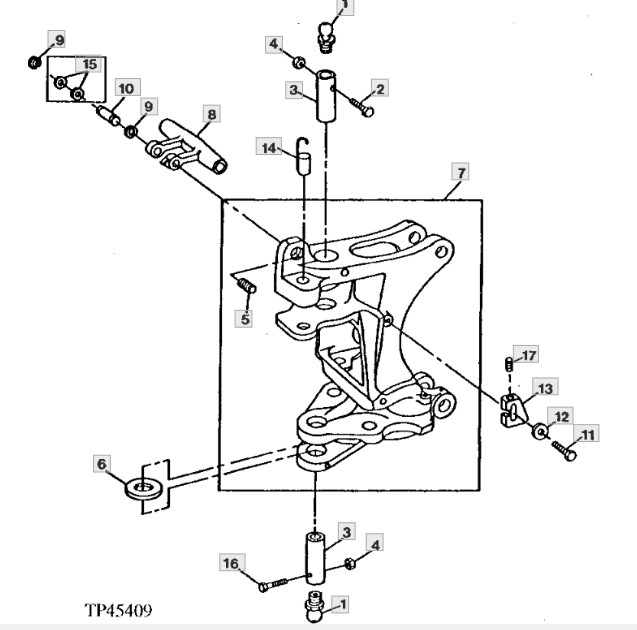

I have a 310D that I've owned for over 20 years and the backhoe section is getting a little sloppy and it looks like I might need some line boring done. Does anyone have an idea what that would cost per section In other words let's just say for two holes.

This from a machinist friend that does line boring of all types of machines:
"First of all backhoe towers are made out of manganese steel they are not weldable. If you weld on them they get harder than diamond and you can't machine them out. They get brittle and they break if you bore them out and you put a bushing in there it's like a Band-Aid piece upon piece and all the original manganese steel was nasty it lasted a long time the bushings will just mush out he won't be happy. Pretty much as far as cost goes it is pretty much when you show up how dirty it is how wore out they are there's a lot of parameters I can't give you a price per hole"

You are right as boom and dipper are formed metal that is welded together with replaceable bushings. The tower or swing frame as Deere calls it (#7 in the illustration) is cast and this is the piece that gets a little slop causing a lot of play down the backhoe. This is the part that would be line bored and bushings installed, if available or procured somehow and the part I asked him about. The tower on older backhoes such as a 310D do not have bushings from the factory installed in them.
The other parts of the hoe with bushings already are pretty obvious that the bushings can be replaced without much trouble and most people would not let them wear to the point that they would wear into the frame. If they did, the hole could be welded and line bored to be refreshed so that a bushing wouldn't mush out.
This is what most people in California refer to as the tower, so it may be a regional term. Anyway, so much for answering the OPs question.

Suggest that the OP do his own research on bushings and pins. PDFs of 310 parts manuals are free online
keyword is : Swing frame.

Interesting read from a different forum about a swing tower in TN. Also a poster from MA, so I guess not a regional term, rather a Deere term.
Searching Swing Frame or Swimg Tower yields similar results.
Also Wengers and Broken Tractor call it Swing Tower....potAto/potato.
Broken tractor shows a S/N break for bushed towers, but that should be obvious to the owner:
