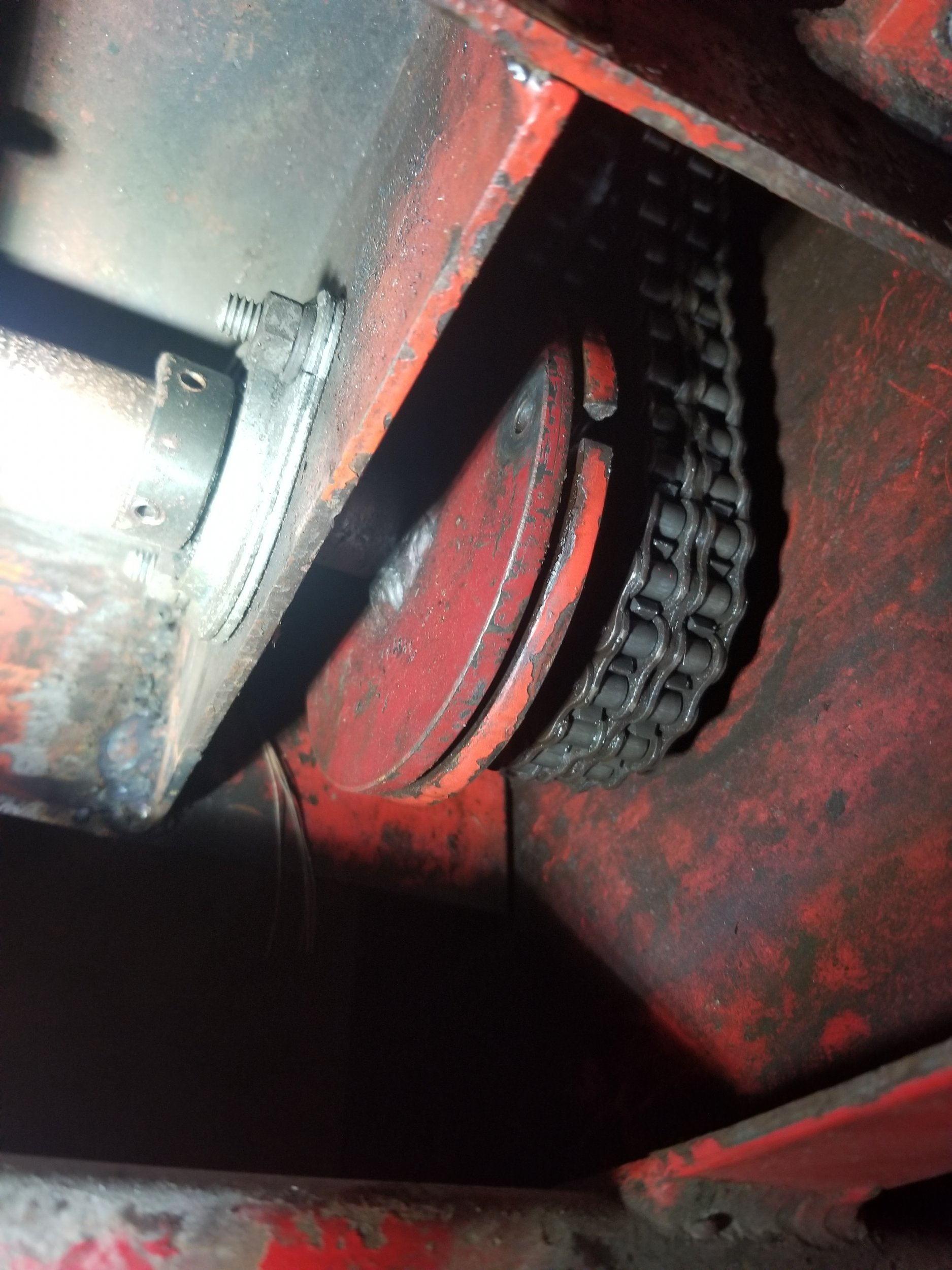

Hoping someone might know what i need here.
This is a shaft driven snowblower on a 322d groundsmaster. I just got it have not used it yet. i noticed the blower spins freely and opened up the gear box. Looks like the 2 disc were connected with a shear pin that broke loose. One has a 1/4 hole and the other a slot...although it looks like the slot was cut into it or broken away.
Does anyone know a shear i should put in here...may i can use a #2 bolt?
Thanks for any help.

The manual or parts diagram should show that.

I cant find the parts diagram anywhere. For the steering....they just need a lot of weight.

Suspect would be grade 5 since grade 2 smears real bad when they shear.
