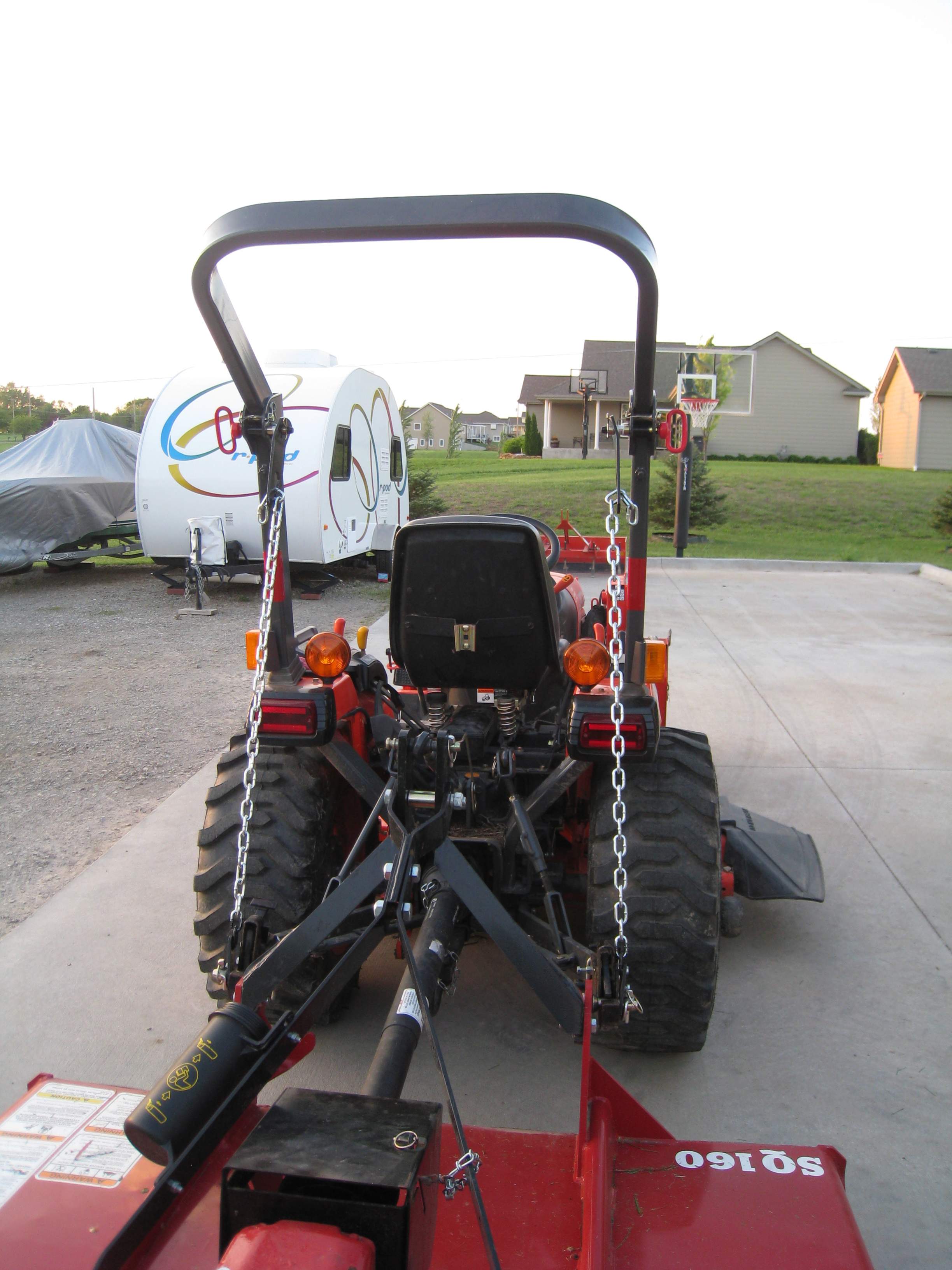

Below is a link to the type of chains I use on mine when I am using the rotary mower. I still bump the control up when the chains get tight, but it gives an easy way to tell when the front of the mower is getting too low.
Mower Deck Height Stabilizer Kit -- Finish Mower & Rotary Cutter Parts
I have the Bush Hog Squeeler mower that you are probably referring to. It has worked fine for me. My tractor only has 21 PTO HP, so if I let the weeds/grass get too high, I have to get down to low range to mow, but were talking tractor hood height. The B3300 25 PTO HP, so should be able to handle that mower pretty well.
The 1/4" valve will not hold a implement at a fixed height. To get a feel for mine, I put the box blade on and raised it to the top. It dropped about 3/4" in 10 minutes. So if I use the rotary mower and start mowing, the front of the mower will gradually drop as I mow. So if I don't have the chains on, I have to reach over and bring it back up whereas a tractor with position control would hold it at the height set. That really only bothers me when I am using the rotary mower. It doesn't bother me when I use the box blade or the MMM.
Nice link on the chains! I'm trying to get a handle on whether LTL or a dedicated 20' open rack trailer is going to be a better deal, and how much, for ocean freight. I have spoken with Barlow's and they have yet to answer a couple of questions but I'm of the belief that as it stands, while they are a bit less expensive on the tractor, shipping a thousand miles inland is going to eat up the difference.

I actually ordered the chain set I got through Yesterday's Tractor. It was the same product, a little cheaper and cheaper shipping, but that site had better pictures. The other thing I added to mine was telescopic stabilizers like used on the B2630 & B3030. The other B's come with turnbuckles which are a pain to adjust and I bent the bolts a couple of times. Also with the turnbuckles, when there is not something on the 3 pt hitch, the arms sag in, making it harder to use the drawbar. This company sells it as a kit, but it is just a bunch of parts, so maybe where you get the tractor from could change it out if you wanted. Although the B3300SU is not listed, I'm sure it is just a B3200 without the mid mount PTO and a loader packaged in.
