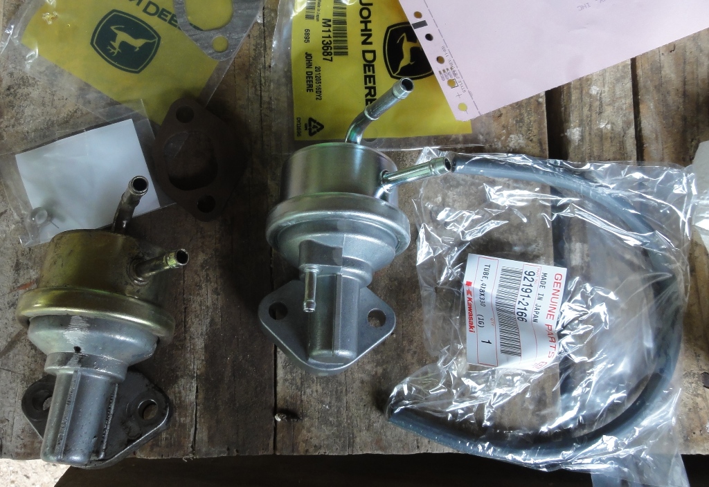

I had the similar issue with a LX188. The mower was running and I just luckily happened to see something leaking all under the front.
There is a fitting on the pump that can open up and I have no reason what is the design reason.
But it was indeed spitting raw gas all over the muffler and it's a wonder I did not have a major fire.
I ordered a new pump and it came with a extra hose to hang down below the mower.
The old pump is on the left and the new design on the right has the extra hose.
This is a different part number to the one on yours so I do not know if the like this or not.
I know it was scary to me when this happened.
When something abnormal happens inside the pump it starts pumping gas out this overflow.
I just do not know the reason for this yet.
The little hole on the bottom was where the gas was coming out.

Well for those of you that have one of these with the little hole in the fuel pump I would check into the recall, and possible go ahead and replace it even if JD will not pay. I know the older LX188 had this and with the muffler below, and it's dangerous.
I do not know if this is a high pressure relief or what, but when the pump malfunctions gas pumps out.
The new design has the relief hose that would pump gas out underneath the mower. (Away from the muffler, but still a concern)
The wild part on mine was that the engine never stopped running. Not even abnormal, just with gas spitting down all over the muffler.
I shut it off, raised the hood, then RAN away looking for a fire extinguisher.
Mine is also a 1995 year model.
