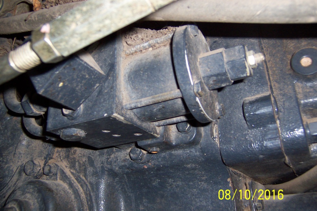

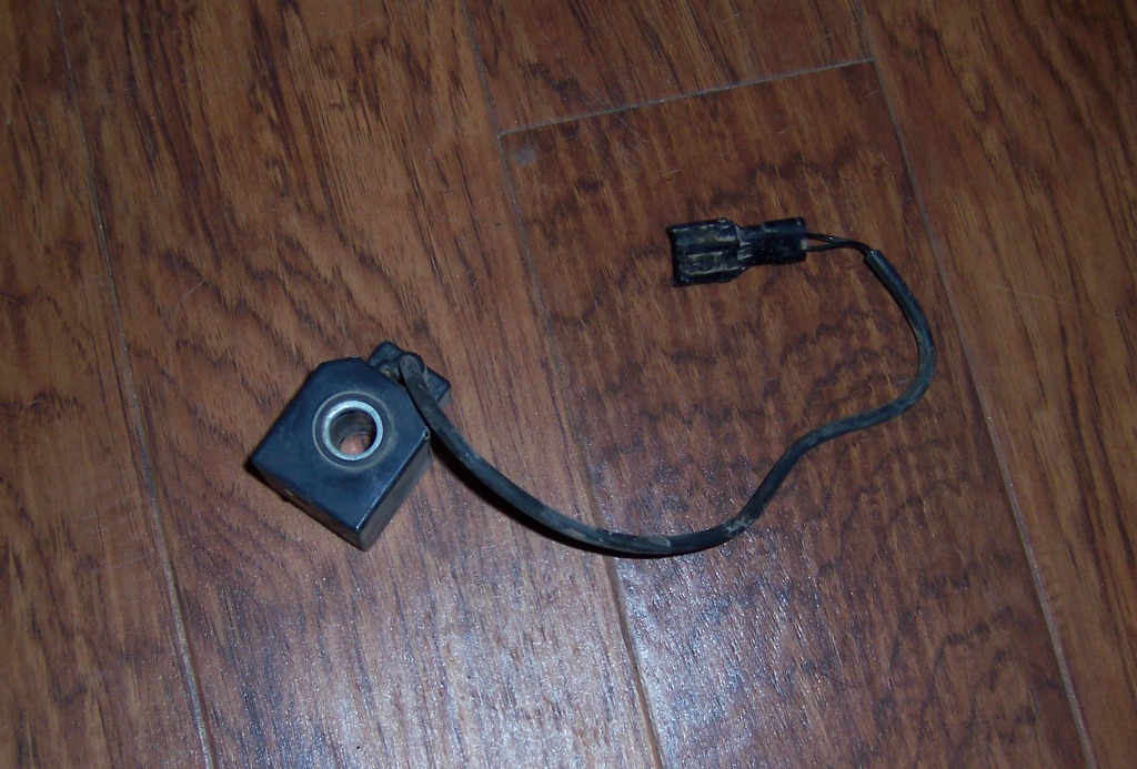

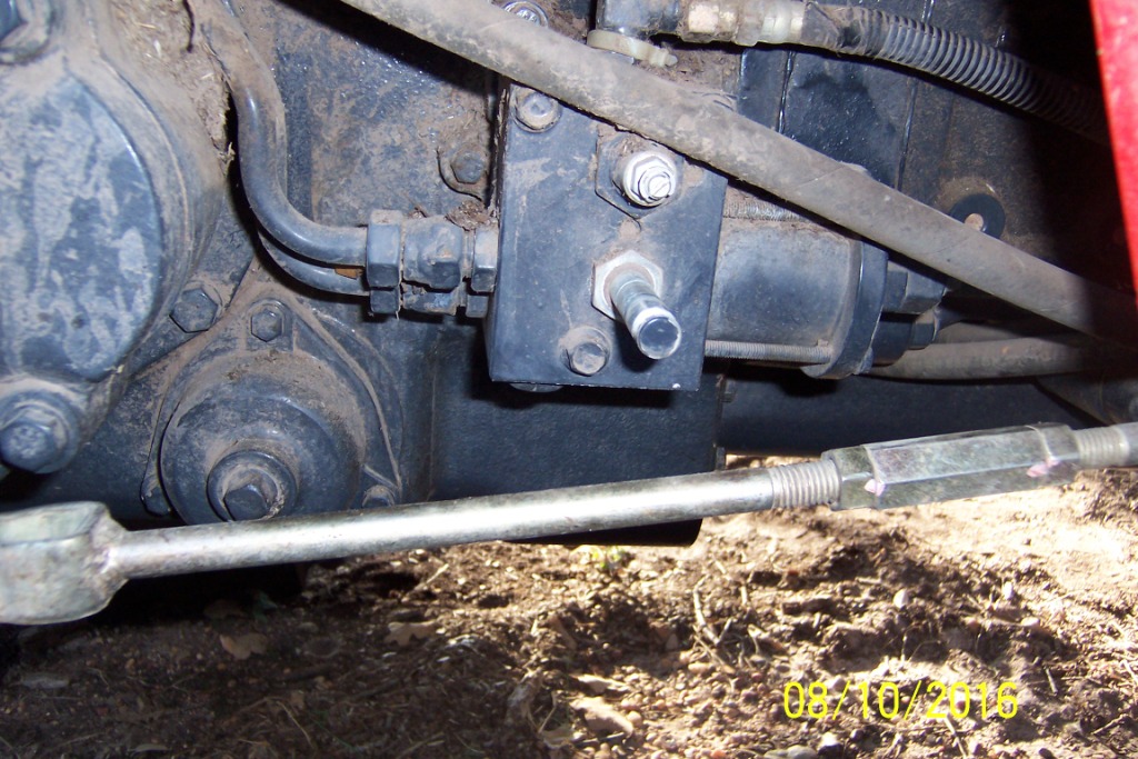

I think I have the same problem with my PTO valve. Which hex plug should I remove? I've attached pictures of the PTO valve. There is a hex plug on the over the solenoid and one on the front of the valve. I've removed the solenoid coil.

/ 3510 PTO PROBLEM #19
Here's a thread with a pic and red arrow to help you out ;)
