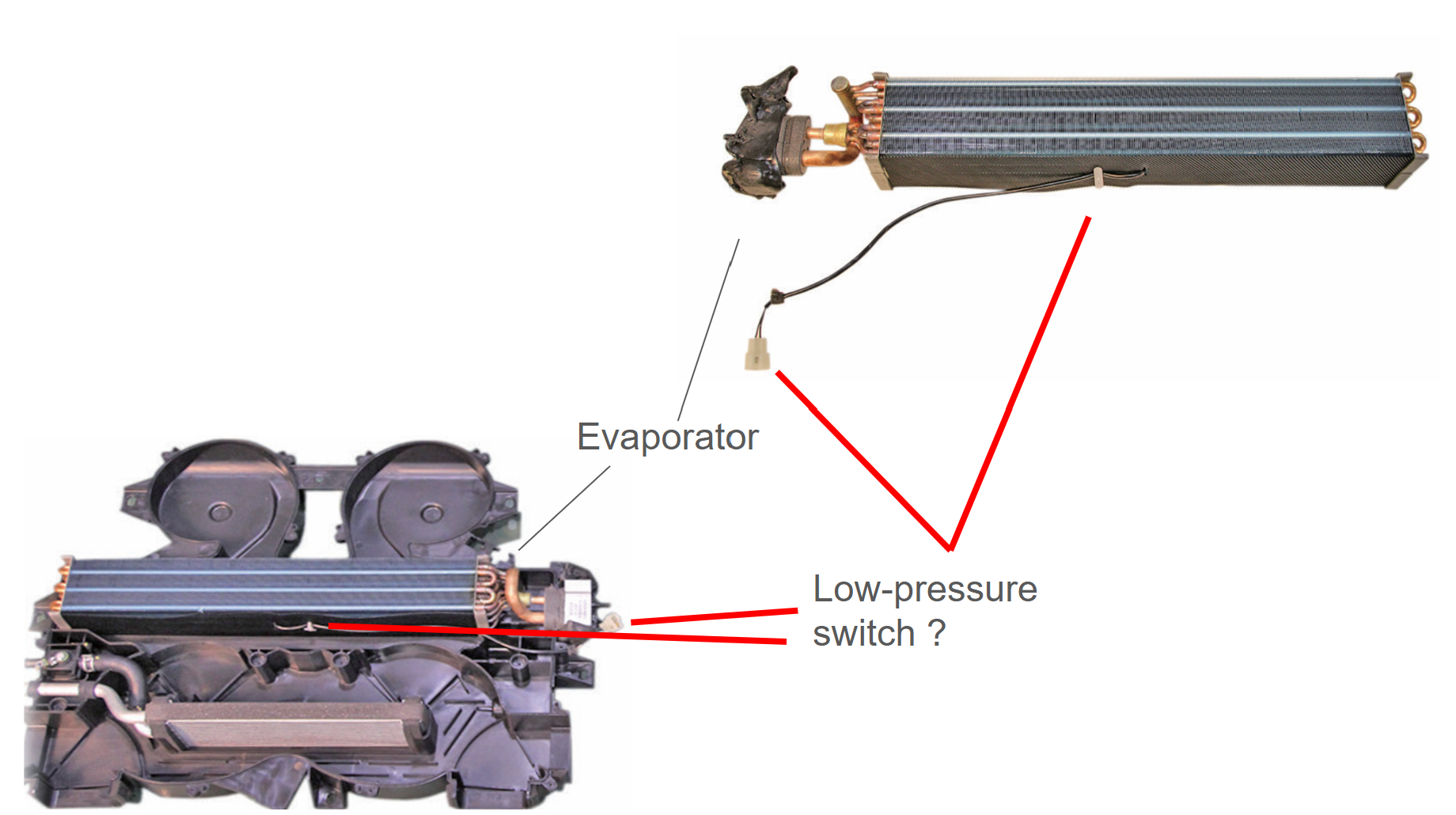

Figured I would add this my original. The AC has stopped again. I just recently decided to look into before taking to a dealer.
Symptom - No cold air, the compressor clutch is not engaging
Past work - Dealer replaced compressor, condenser, evaporator and control module (basically new system), stated the low-pressure switch was bad, this worked for a while
I borrowed gauges from O'Rileys and have tested both static (tractor off & running) and jumped the compressor (the clutch engaged and air was cold)
Ambient temp was apprx 90 with about 60% humidity. I was working in my metal garage so might have added a degree or two
Static pressure - (tractor off / on) Low - 113, High - 115 // Low - 118, High - 120
Compressor jumped (Clutch engaged and air was cold)
Initial Low - 40, High - 235 // After 5 mins running Low - 38, High - 250
Hi-pressure switch tested out good including volts
Below is from the 15 series service manual, so is that the evaporator and low-pressure switch?
AGV_vUfE0CnemhFEHw85PgJApTWCe351FFsTHSCCM7C-sMNT_15mi2VxweZMOy3wFmziOUp_7yfrFLQjsOUyQbePR1lnY_-pJIbgx_ZtScfRQES6G_4hYsVQk7ufOhPYKJbInBCrUyfFHA=s2048
If so I will bypass that switch and try it, also the manual talks about the 2 relays (AC and compressor; but I can't find the compressor relay), is it built into the compressor or I am nuts.
any other suggestions to try?
Thanks for the help
   / 3515CH HVAC #10
Pressures sound good,
looking at the upper picture I would consider that a temperature switch, not a pressure switch.
I would look at the temperature controller for the relays if not on the fuse panel.
