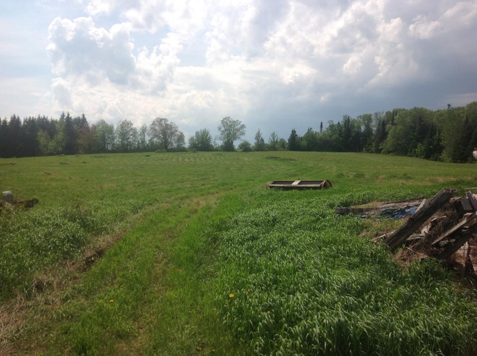

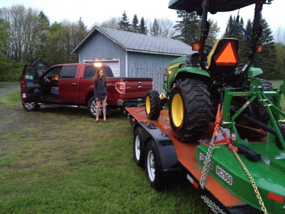

Some of my experience rotary mowing the farm I grew up on. Towed with F-150 3.5 ecoboost on a 10K 20' car hauler, Used a WDH, 270 miles each way northwestern VT to northern Maine. Truck handles this very, very well, 12MPG+, 6500lb trailer w/xtra fuel, tools, rigging but no loader.
3520+RC-2060, cutter offset 6" to left (swing+used universal draft pins on Imatch to relocate attachment), track on inside of front right wheel, R4's, flipped wide, no ballast. .9 gallons / acre, 1.5A/hr average, 1.25GPH mowing light to moderate brush at 3 to 5.5MPH. Very wet, nor-easter all weekend, tractor floats extremely well on soft ground - I leave tracks in the sod with my boots but no wheel ruts. Stability was fine. Cutter set low, stubble is at about 3", lots of ant hill strikes and a few rocks. I was a total sickle bar snob (JD5, cockshutt 30) but I'm not looking back - the rotary mower is great. Only thing it doesn't do as well is get close to edges and mow over obstacles. Tractor easily handles the mower - could do a 6' in the bushes, heavy grass not so much.
mowed 32 acres in 21 HRS, still have 14A to go.

Your GPH seems right in line with my experience using my 3520 with the RC1072.
What brand and model of the WDH do you use?
   / 3520 and rc2060 1st mow
It's a reese pro series with 800lb trunnion bars, which are about right. The shank should ideally have another 3" of drop beyond what comes in the kit to make the trailer level. Also have pro series friction sway control.
