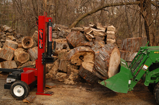

I am going to trade up to a 3520 from a 4110, I want to add a grapple for handling my logs to cut down on the hand work and back aches.
Qustions 1: how much will this rig pick up in weight, I cut on down peacon wood.
Question 2: how much rear weight would I need. I hate to fill the tires.
Questions 3: would I be doubling my working lift power with stepping up to the 3520 from the 4110.
You folks here have been a lot of help. I am posting with this post my log pile, I heat only with wood the heck with our gas company.

That setup will move them fine, but the 3320 has a very compact wheelbase, so be prepared to put a lot of ballast on the rear of that rig.
   / 3520 Jd with graple question #3
There are a number of variables that make your question difficult to answer. First, grapples vary in weight. I have a grapple rake that is in the neighborhood of 800 lbs. If you go with a grapple attachment for your bucket, then the weight will be significantly less. Also, remember that when you are hauling logs around, you really only need to curl them just off the ground to move them ... so while you may be able to move a certain log around, you might not be able to buck that log up onto an elevated surface.
I assume you don't want to fill your tires because you do some finish mowing and you don't want to damage your lawn? All I can tell you is I had my tractor for a month before I got the tires filled and the difference was remarkable ... highly recommended for what you are doing, unless you just have to have removable ballast.
On my 4320, the rear wheels can be modified to something like 8 positions ... I have mine set to almost the widest position. If that option exists on the 3000 series then do it ... especially for hauling logs where your weight distribution will often be out of balance.
