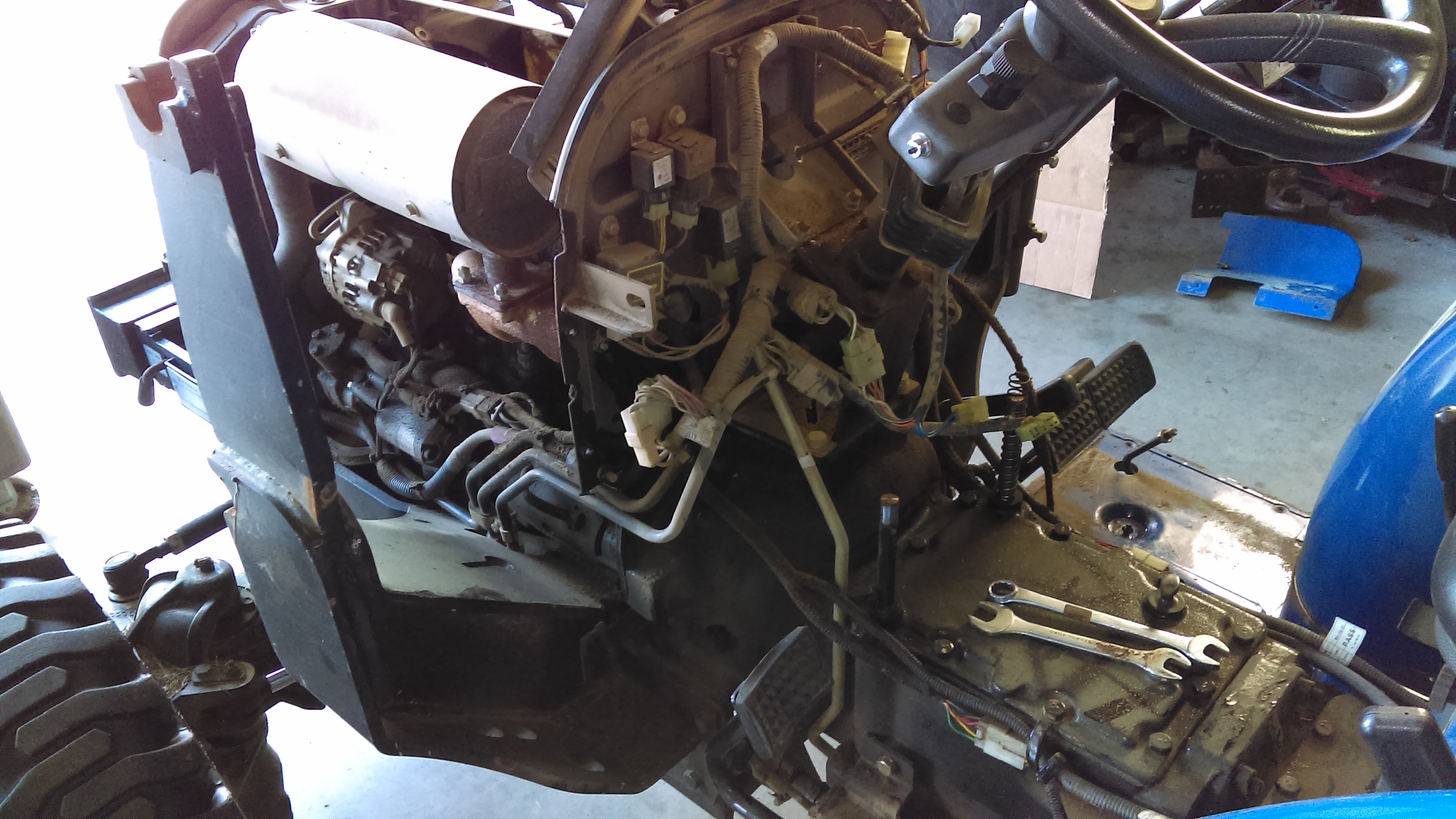

Well I bought the tractor so now I would like to know if anyone would like to recommend a place to buy the clutch. The tractor will drive on it's own but when using the box blade this afternoon I got the clutch to slip while pulling a full blade of dirt.
   / 360DTC clutch #5

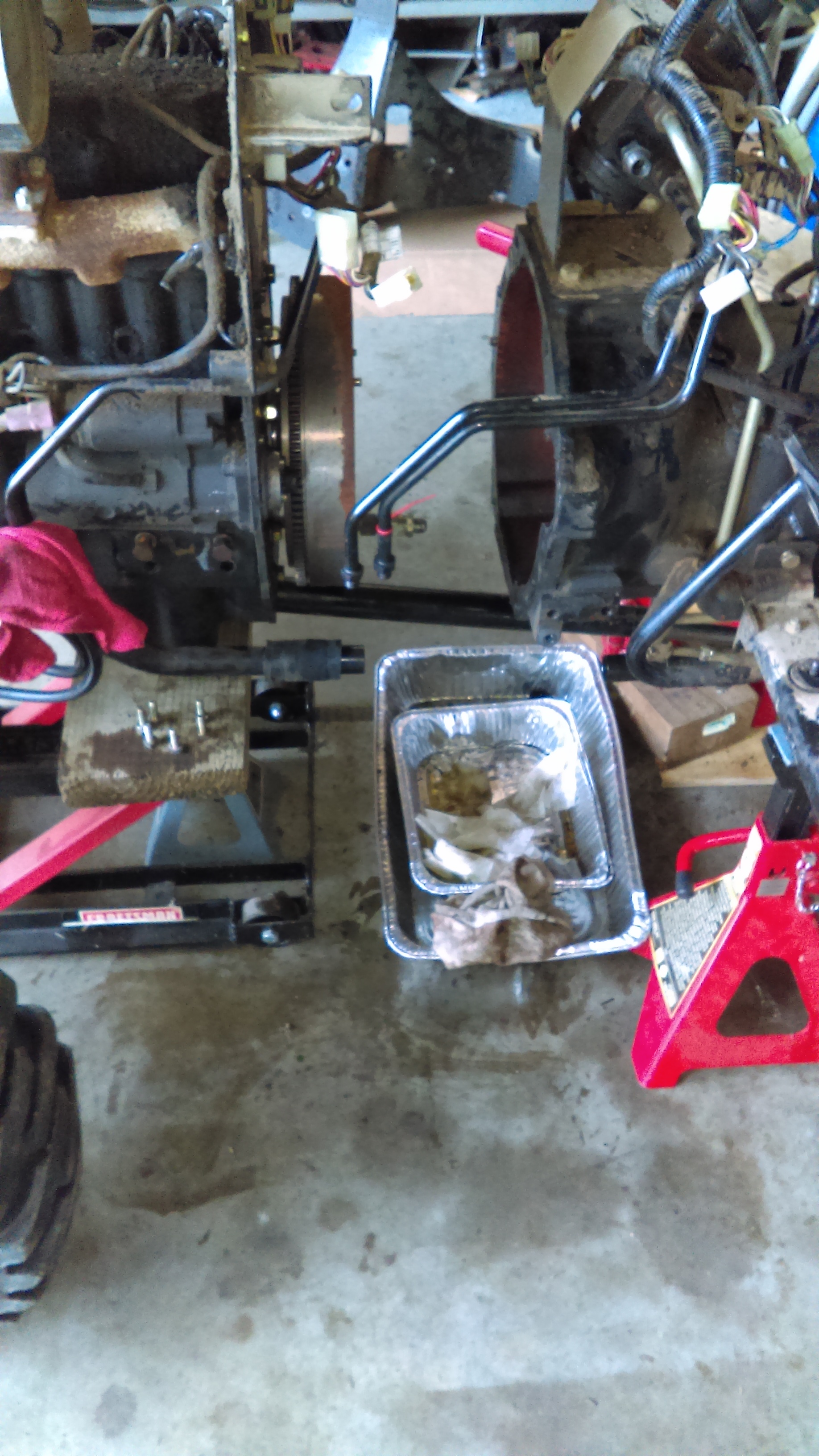

Trouble is finding someone to work on Farmtracs. You can install the clutch yourself if you take your time and lots of pictures. It's not that hard just time consuming. IMAG0402.jpgIMAG0404.jpg
   / 360DTC clutch
Thank you for the pictures bones, I will do it myself I have split other tractors to replace the clutch but may have a few questions for you, if that's ok.
   / 360DTC clutch #7
So how did it go? I am trying to split a Longtrac 360 DTC, and it came apart about an inch and just stopped. I can not get more than an inch gap between the engine and transmission.
   / 360DTC clutch #8
