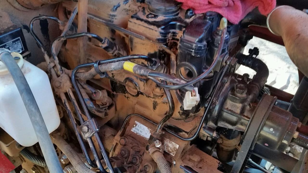

Dec 24, 2017 / 3616 - How to remove/check glo plugs Thread Starter #11 OP J JimnAZ Bronze Member Joined Aug 22, 2014 Messages 54 Location Seligman, AZ Tractor None I'm going to get someone to look at it for me. Just an FYI - it's 70 degrees here and sunny. The tractor is parked in the sun. I tried to start it and it was as difficult as it is when it is cold out. ???

Dec 24, 2017 / 3616 - How to remove/check glo plugs #12 D Dave M7040 Elite Member Joined Dec 10, 2012 Messages 2,757 Location Williamstown Ontario Canada Tractor Kubota M7040 Nuffield 465 There is more wrong than GP's. Perhaps a engine stop solenoid that is not working properly or a relay controlling it. Dave M7040

Jan 14, 2018 / 3616 - How to remove/check glo plugs Thread Starter #13 OP J JimnAZ Bronze Member Joined Aug 22, 2014 Messages 54 Location Seligman, AZ Tractor None Here is the update. Had the plugs checked and one was bad. Replaced all 3 and she started right up in 30 degree weather! Thanks everyone for your help Jim
