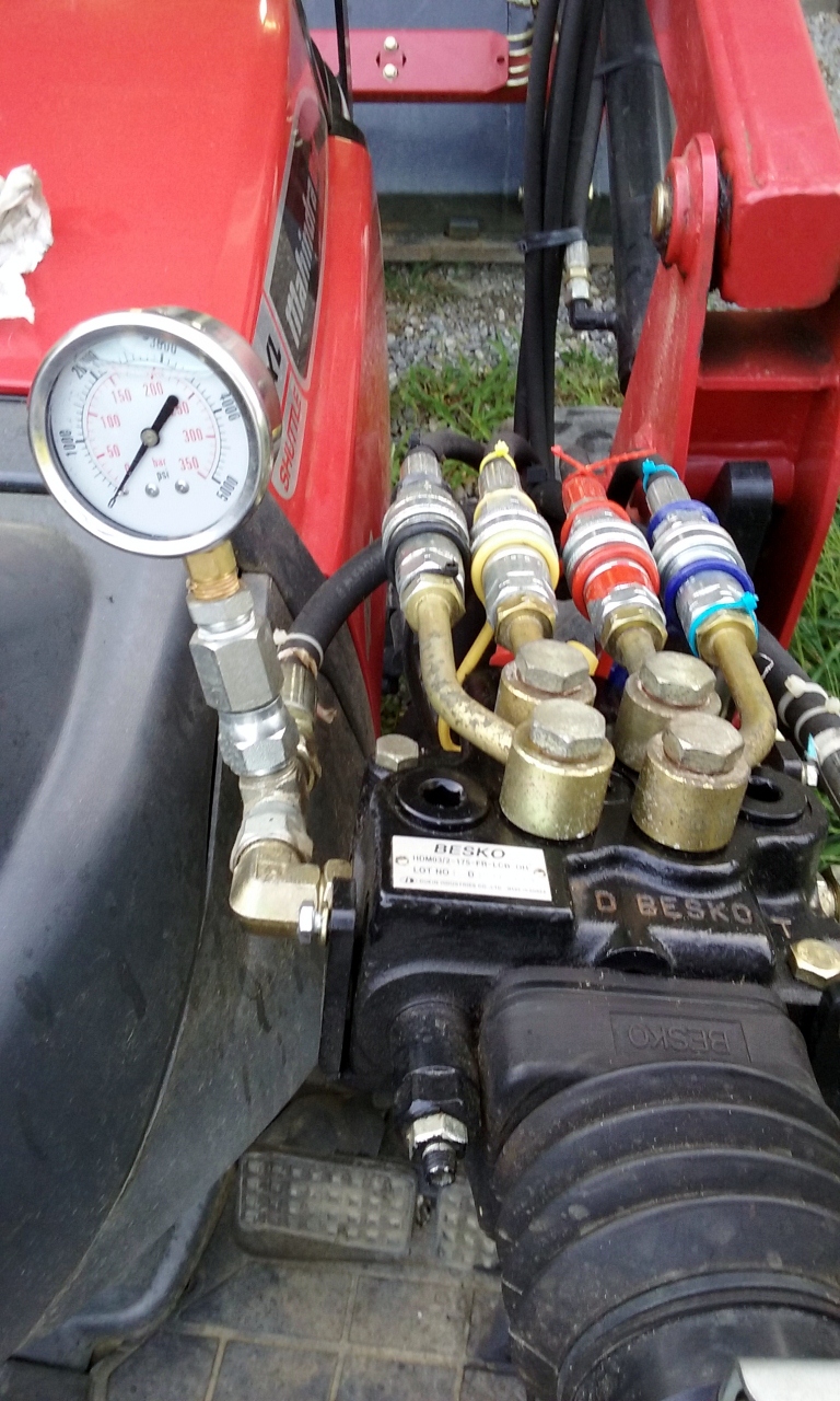

I have a 3616 with loader and backhoe and so far I love it. We're buying a lot more hay than we did when I bought the tractor, so I bought a set of ssqa forks to lift big bales, since the loader is rated at 1650 lb and the big bales are supposedly 1200-1400 lbs. When the truck showed up with 3 bales, my poor little tractor could barely lift the bales off, and only after I pulled them back against the fork uprights so they were as close as possible to the pins. The truck driver was fairly perturbed, and I hated having to wrestle with the bales and a ratchet strap.
Is there any way to bump up my lifting capacity just a smidge, or should I stick to 2 string bales? A bigger tractor is not an option as I'm still making payments on my little one.
Is it possible that the relief valve is set too low?
   / 3616 needs just a bit more loader lift #2
Make sure you have plenty of counter weight first. Loader tires, plus about 800-1000 Lbs on the hitch.

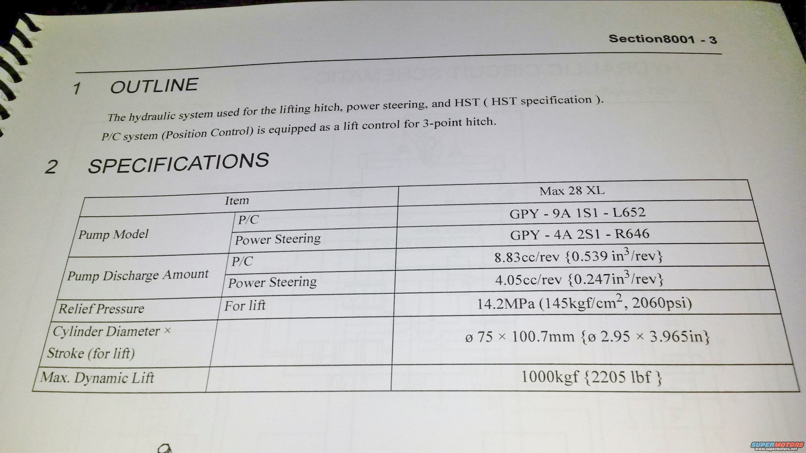

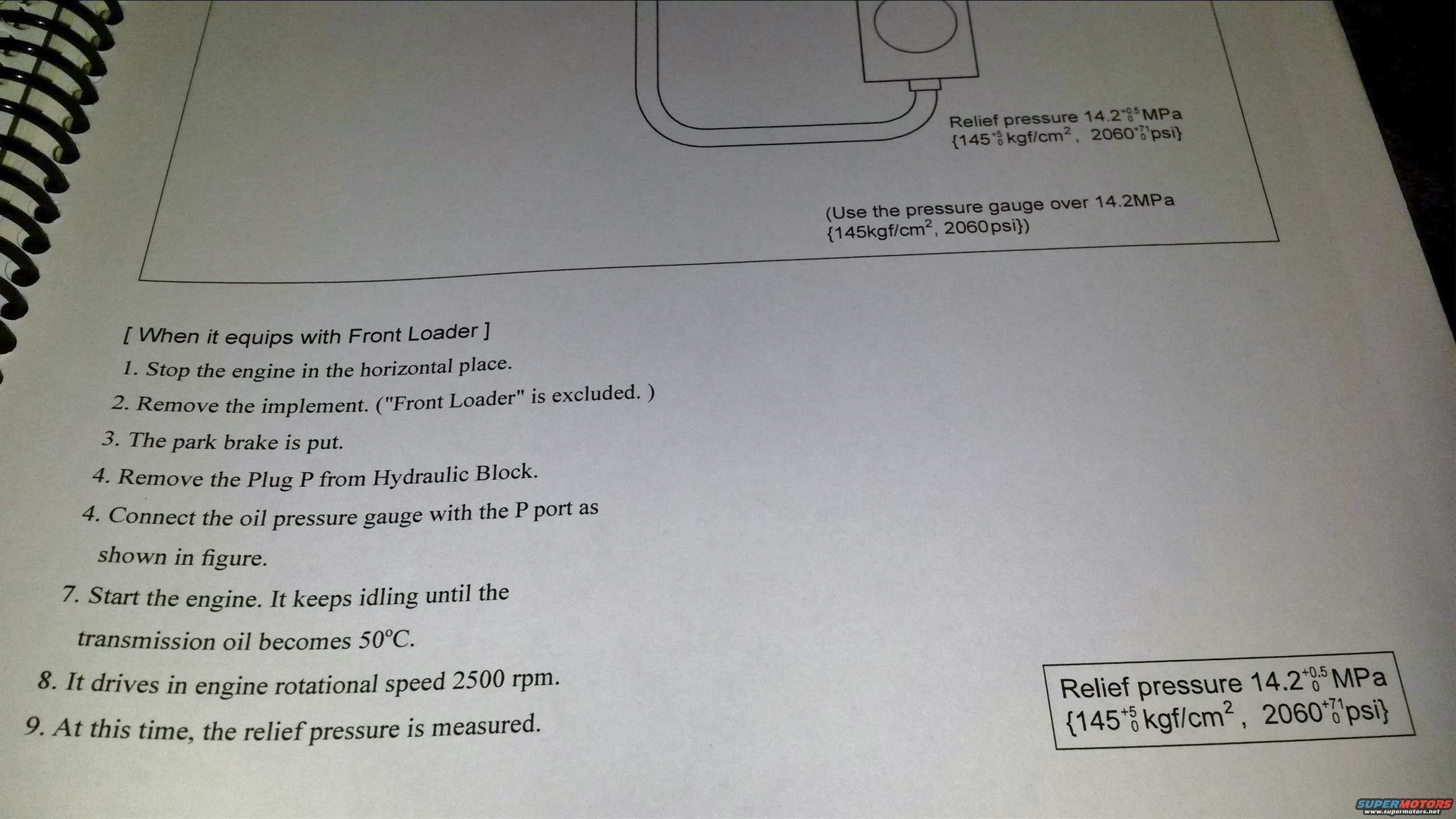

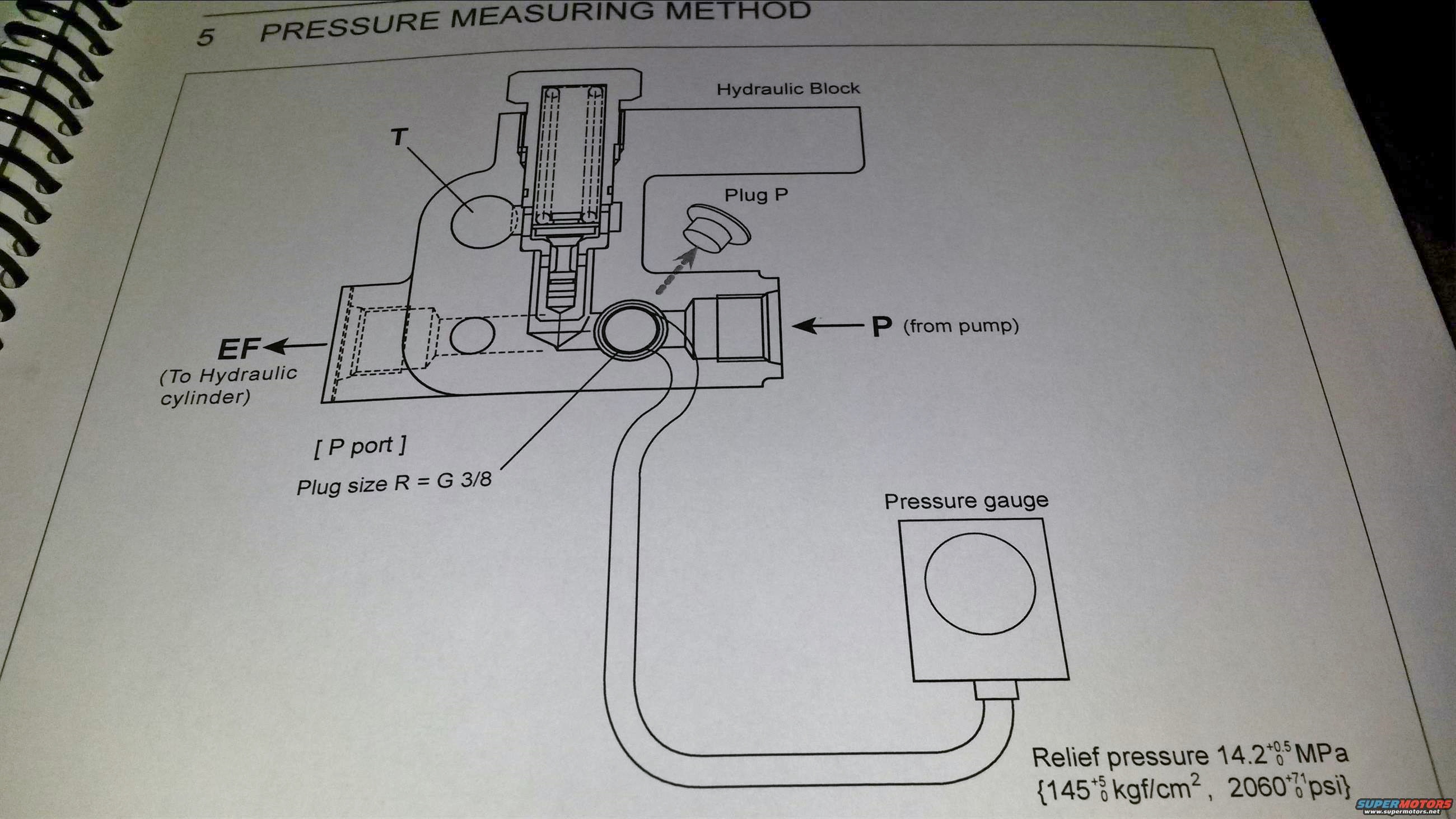

Next, get a pressure gage and tie it into your Loader valve.
As is my Max28XL, I suspect you pressure relief is non adjustable, so you have to shim to adjust pressure at the main pump. My loader valve is adjustable.
Set the main pump 50-100 psig higher than the loader relief.
Small thin 0.030" thick stainless washer work well enough. One may be enough.
Someone on the Forum must have a service manual for your tractor. Ask for the pages that apply, I've attached what I have on the Max28XL as an example.

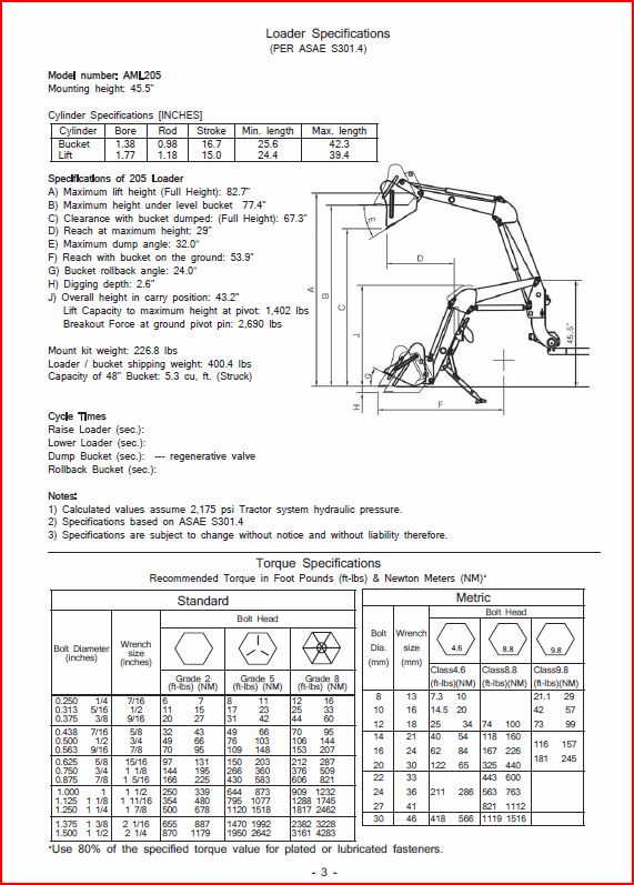

Up the pressure 10 to 15% and call it a day. Note that a 15% increase will give you more than 15% extra lift, as the pressure has to lift just the loader first. Usually this eats 250-300 psig.
I run both my L39 and Max28XL 5-10% over spec.
