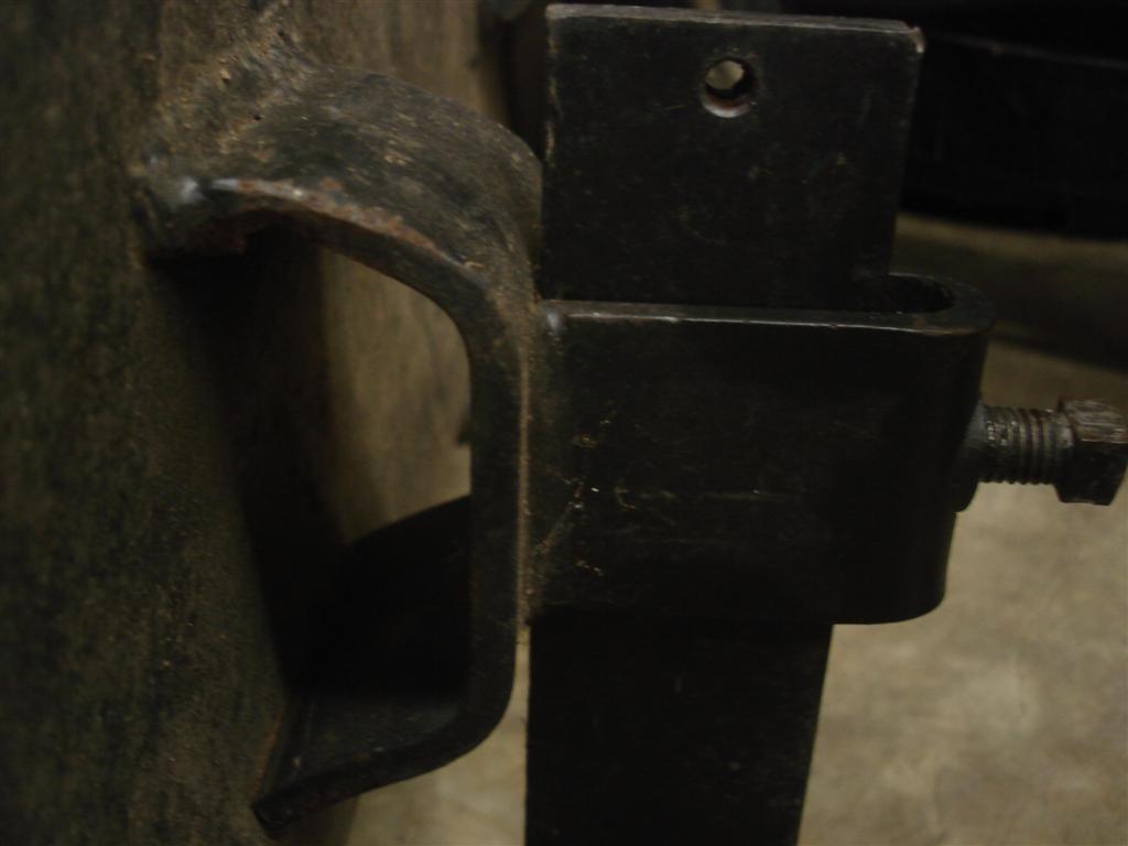

i am setting up my 366 blade on my 3520 for the first time. i clear a blacktop drive. do you set it so it rides on the two feet with the edge of the blade about 1/2" off the pavement? how about the top link? top hole or bottom? i can lengthen the link to rock it forward on the feet to get the blade closer or shorten to raise it. the feet are pitched forward. does this sound correct? do you put the bolts in the u shaped brackets on the long arms in the top holes to let it ride up & down in the U or in the bottom holes to use the float off of the hyd cyl? you guys with the new front hitch & 366 blade please give me your thoughts. thanks in advance.............bud
   / 366 front blade on a 3520 #2
i think john deere screwed up we have 2 of these at work and the skid shoes don't ride at the correct angle, but if you cut the bracket that holds the shoes off and invert it the shoes wil be level . i was wondering how long it would take before people started wondering what was up with this . we plow a lot of concrete so i made brackets to hold pick up truck shoes they will last a lot longer. hope this helps
   / 366 front blade on a 3520 #3
sorry i al most forgot top link i have them in the bottom hole and the u shape long arms also at the bottom , use youre hydraulic float when plowing , you may also have to rotate the hydraulic lines a little bit for more ground clearance the ones on the bottom at the block
   / 366 front blade on a 3520 #4
This was a problem on the older #380 blades as well. My friend Wayne first noticed it on his #366, so he cut the bracket and added a spacer at the top so the shoes wear evenly, When I got my #380 I did that same thing. Look at my pictures below>

   / 366 front blade on a 3520 #5
it looks as if when these were put together they were installed inverted . its not a dificult fix , but for the price of them you shouldn't have to remanufacture them
