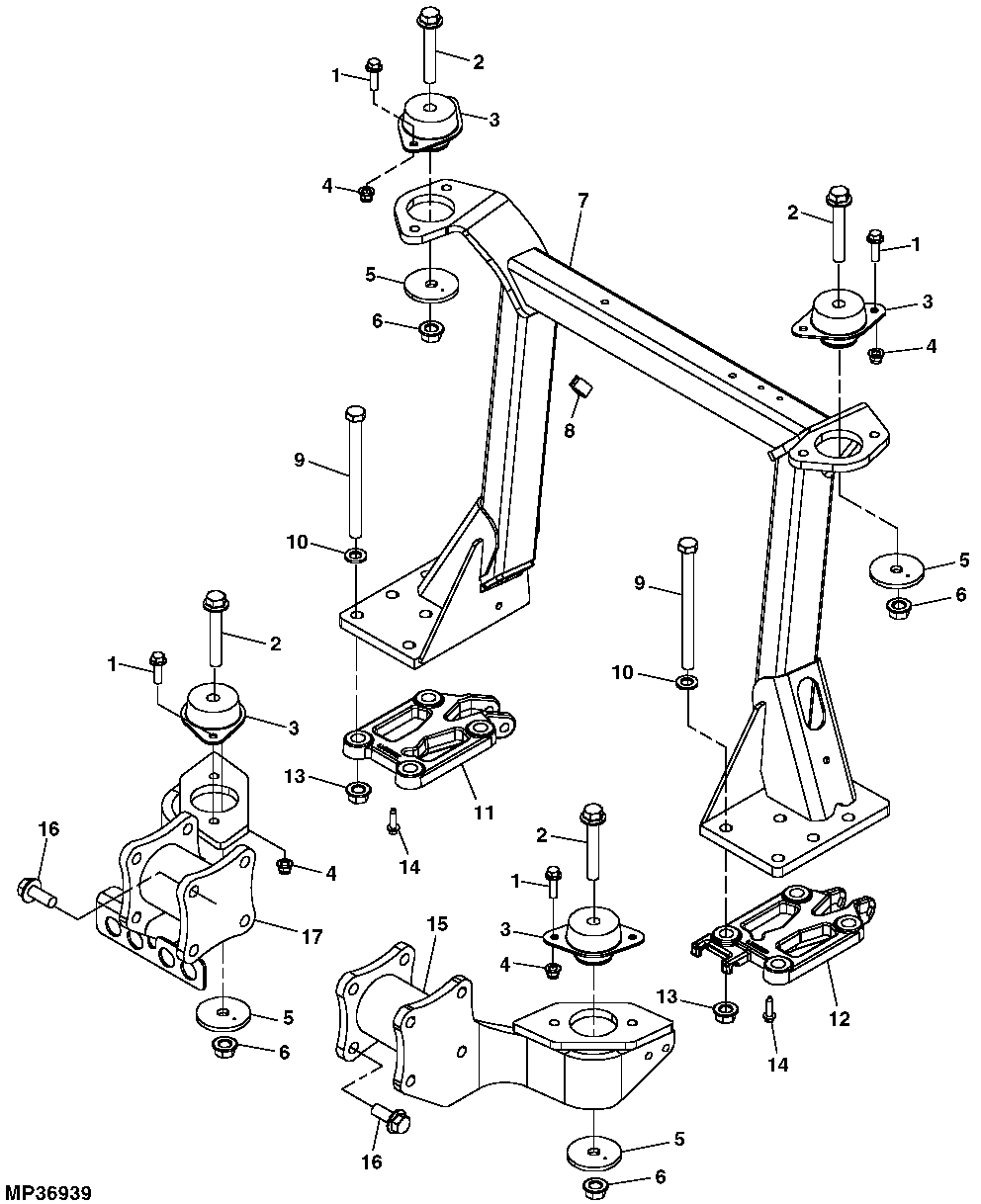

So I'm new to this. Trying to build my checklists of things I should be doing. Without experience, I'm trying to do things by the book.
My 3720 (Cab) Operators Manual says every 50 hours "Check cab protection system mounting hardware torque"
Nearly every maintenance procedure is explained in the OM, but no reference I can find to this one.
TM does not address this except with "Metric Fastener Torque Values" table.
Any ideas on what I'm supposed to do for this maintenance check?
Thanks
   / 3720 How do I "Check cab protection system mounting hardware torque" #2
Looking in jdparts I found this drawing. I think you need to check bolts and nuts 9 & 13 in the drawing. There are 8 total they are M16, so use the torque spec for that size.
