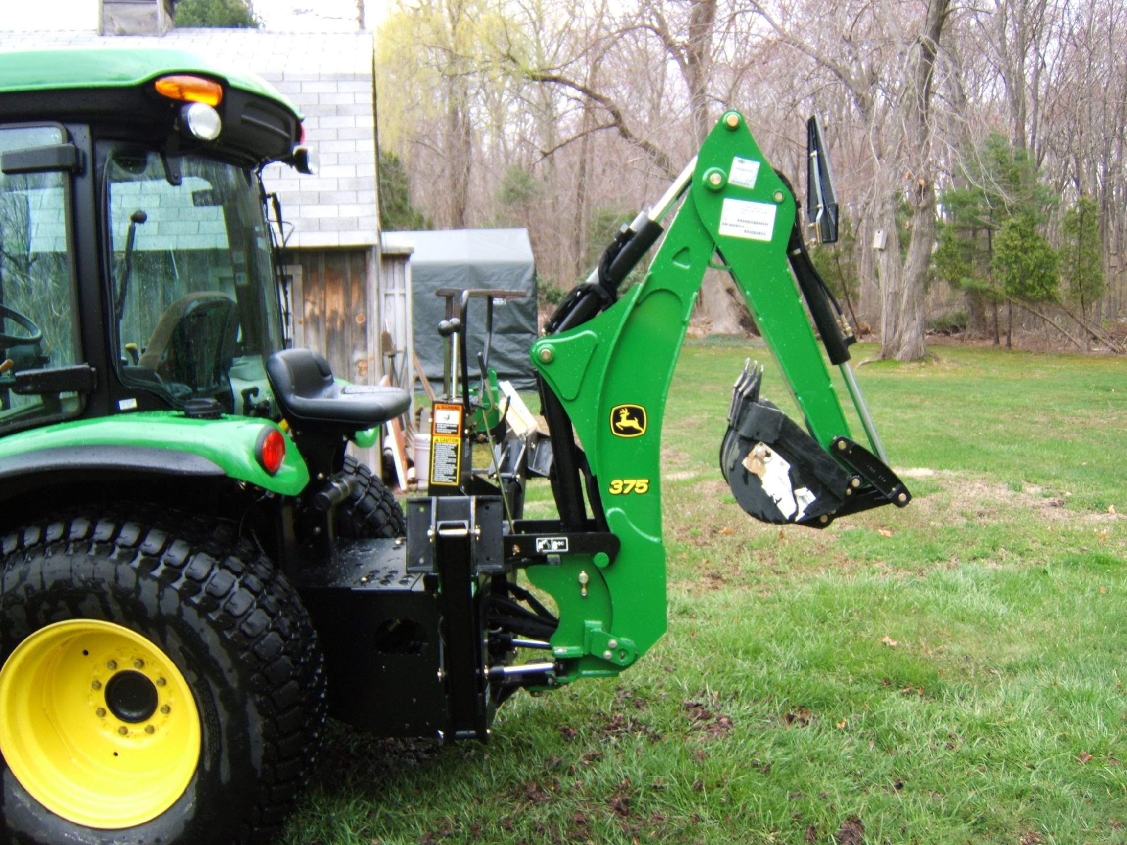

   / 375/485 Backhoe For 3720 Cab Tractor #3
heres the 375 on my 3720 cab

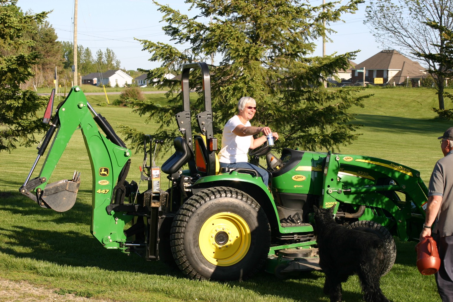

   / 375/485 Backhoe For 3720 Cab Tractor #4
Here is a shot of the 3320 OS with 447. Compare how much closer the stabilizers are to the rear tires. You can see how much the whole BH has been shifted backwards so the operator stations will clear the back glass of the cab.
Thanks for the pictures guys.... so if the mounts are the same etc... why can't a 3000 Cab unit handle a 485? Do you think it is a weight issue?
   / 375/485 Backhoe For 3720 Cab Tractor #6
IMO...Emphasis on the O part :D, the problem isnt weight, or anything like that...the problem is where you gonna sit when on the hoe?
   / 375/485 Backhoe For 3720 Cab Tractor #7
It's a fit issue, the cab frame (not just the glass) is in the way of the larger BH. Cabs are great but sometimes require that compromises be made regarding attachment size/girth compared to open-station CUT's. In searing heat or in the dead of winter you won't care as much about the smaller BH, trust me.
