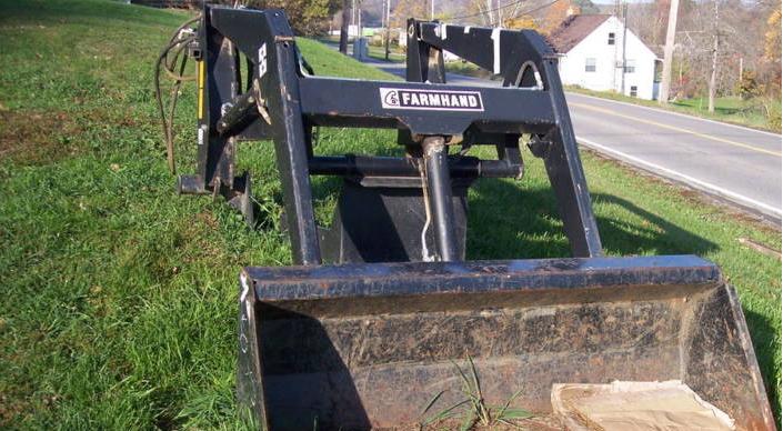

Ok so Dad Just picked up a Agco Farmhand Front End Loader for my 3910
Of course he dont call and ask me if he can put it on my tractor but shows up to my house while im at work puts it on then calls me and tells me i ow him $800 for a loader he bought. And i have to figure out how to hook the hyds up.
So i didnt have a problem with the price nor the shape it was in. So i gladly paid him.
Ok so now to the question do i hook the hyds up to the Rear remotes? Or is there a special place for them on this?
I know a dumb question but i never had to hook up a loader on a farm tractor.

u can hook them up to the remotes or the is a hyd. manifold that bolts on the lift top under the block for the remotes that is the best way to hook them up

This hyd. manifold Do you have a photo of where it is and what it looks like?
   / 3910 loader how is the hyd hooked up #4
you can get the manifold from the dealer and/or find one on the net. it goes below the remote control box that is under the seat. i have one on my 3910, i connected the fel lines to the manifold. this keeps my remotes open so that they can be used with the hay equipment. it was easy to put in. just unbolt the remote control box from the tractor. place/mount the manifold on the tractor, then bolt the remote control box on top of it. hook the fel lines to the manifold. all i had to do was to cut some off the remote control valve handle. with the manifold in place the top of the handle was hitting the bottom of the seat.
