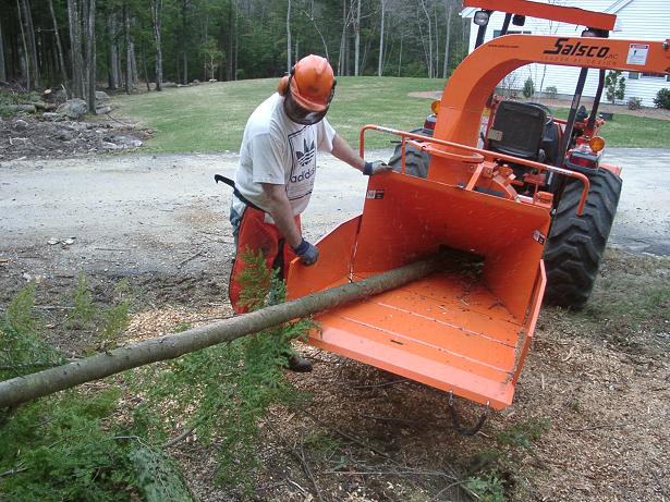

I have a Salsco 826 with hydraulic feed that I /w3tcompact/icons/love.gif. They just came out with a smaller model, the 824 that sounds like a better match for your needs. It seems that everybody on this site that has a chipper is generally happy with their choice, unless they are looking for something bigger or with a feed.
If you are going to use it very much, I strongly recommend a reversible power feed.
-david
