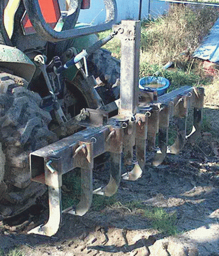

My 4010 3 pt goes down by gravity. When empty, you have to stand on one arm to get it down.
Here's my soil ripper. They're chisel plows, not sub soil rippers. The 4010 pulls it to plow depth, about 6-8", through previously-plowed soil. Dropping it on grass on a hill is a good way to stop it.

   / 3PH Down pressure? #7
Here it is with 2 16" disc hillers mounted on that same 2x2 bar. They worked fine to make raised rows in the garden. The tractor pulled them fine. The last 10 rows out of 20 got a little "S" wave in them from the discs kicking the 1400# tractor about a little (same weight as the 2210).

   / 3PH Down pressure? #9
I have a rotary plow that goes on my Gravely PTO. It's great for turning new ground. That's one of the things that give me reason to keep the Gravely around.
I could probably bolt on one or both of those huge 16" disc hillers at more like twin 30 degree angles instead of the 45 degree opposed angles I used to make the rows on my JD 4010 to break new ground. Think those two discs would give me quite a ride on the 4010 though. I've heard of people using single bottom moldboard or single disc plows on the smaller CUTs and SCUTs. Think they're a tad light for plowing new ground though. Suspect they all will kick around like my Gravely rotary plow does. At least you won't get your hips busted by the handle bars riding on a tractor. Suspect it'll be a thrill ride though.
I've ordered a couple 12" disc hiller blades to bolt onto the axles that the 16" ones are one. I'm hoping with those smaller blades that I can use them for clearing out between the rows and still run 3 or 4 of my chisel plows bolted onto the 2x2 bar to go down the rows. If anyone offers you one of those old implements that "packages" of stuff fit on, take it.

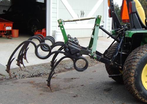

   / 3PH Down pressure? #10
heres a lil project i cobbled together
