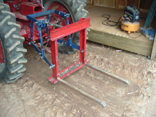

I made me a set of forks for the tractor a while ago and just havn't gotten around to posting it. I used some short pieces of 4" and 5" chanell that was at the shop. All the cuts are square and none were over 32" long. except for the forks which are 2" x2" x1/4" tubing and they are 36" long. It only took about an hour to make and is as handy as having a thumb. I used them yesterday to move a pallet that has bags of cement on it. I keep them in the shed covered in plastic and have some anytime I need it which is pretty often. Here is a pic of the forks, no discription needed as they are pretty simple but they work well

Very nice. I am thinking of building something along the same line to move stacks of firewood to my wood boiler.
