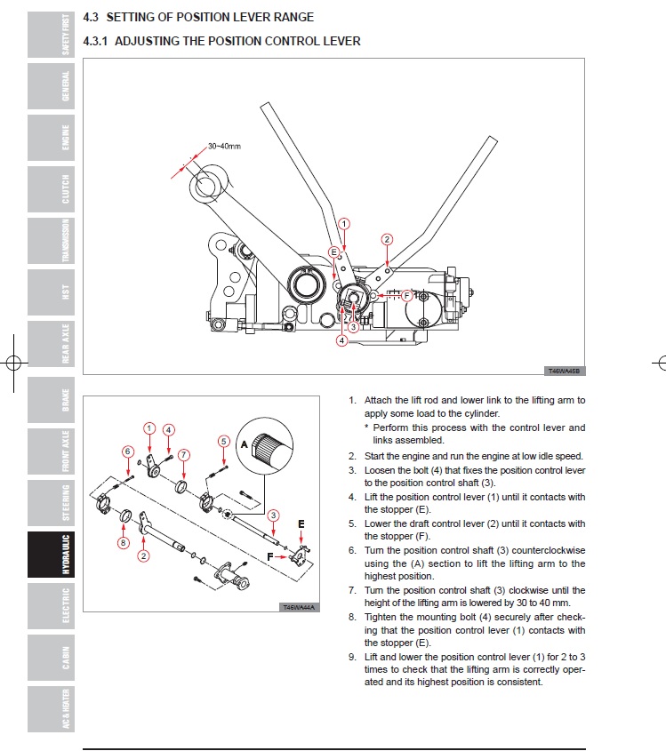

When i move my 3pd lift control all the way up my implement lifts, but not by much. Then when i move my draft control from all the way forward to the rear most position i get a lot more lift on the implement. Does this sound right? I was under the impression the draft control didn't affect lift

in my dk45se, when the 3pt lever is all the way up, I can still gain a few more inches of implement height by also raising the draft control lever all the way up as well. But the 3pt hitch lever makes up most of the height by itself.
How high does the 3pt lever allow, and how much more with the draft control also raised all the way up?

It does NOT sound right.
On my DK45s: With the draft full down/forward the lift lever is a position control that moves the 3-point through nearly the full lift range. I rarely use draft but, with the lift position set, raising the draft control lever (typically part way) will cause the 3-point to lift if it encounters high resistance while moving forward. But this is not a perfect relationship because raising the draft too much will raise the 3-point even without resistance. Unless you are plowing you will probably never need the draft control. But the lift control should position the 3-point wherever you want it and keep it there.
The service manual (hydraulic section) provides detailed description of this system. You probably need an adjustment. Did you buy new or used? Do you have a nearby dealer that will work with you? Are you mechanically inclined?

Purchase used. Dealer relatively close. Yes mechanically inclined

Something fairly easy to check. Have a look at this page from the manual for setting the position lever range.
