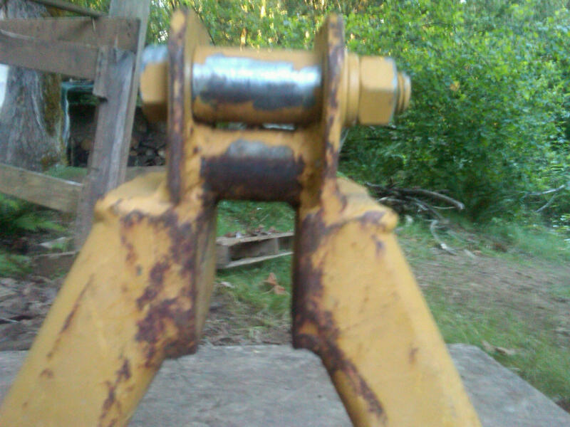

i had to modify the 3ph forks to work with by QuickHitch, had a local welder do it with no problem. My FEL forks go on in place of the bucket, they are from Artillian (sp?)
If you have a chance some time, could you post a photo of the mods you had to do to the forks for the Quick Hitch? I have a Land Pride QH15 quick hitch on order and would like to use it with the forks as well.
Thanks. - John
   / 3ph Pallet Forks vs FEL forks #17
Here are the mods to the top of my Rankin 3ph forks. Rated for a much heavier load than my tractor could handle. It is the lower 'pin' that fits in the hitch, the upper pin is for additional strength. It originally had a full welded plate across the top preventing hookup. Had to be cut off before welding the bushings in place. I don't think just bolting the bushings through would be strong enough.
