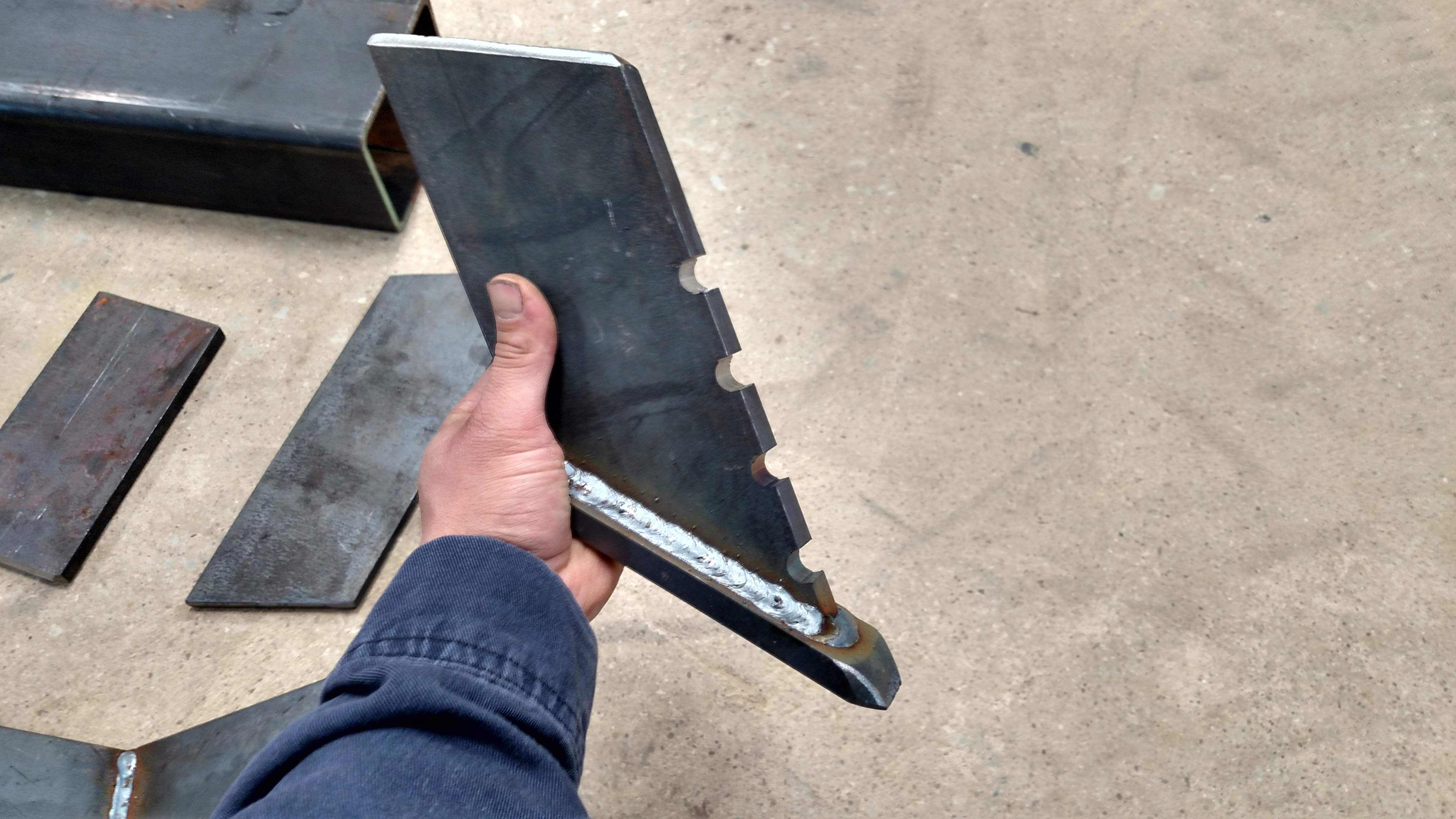

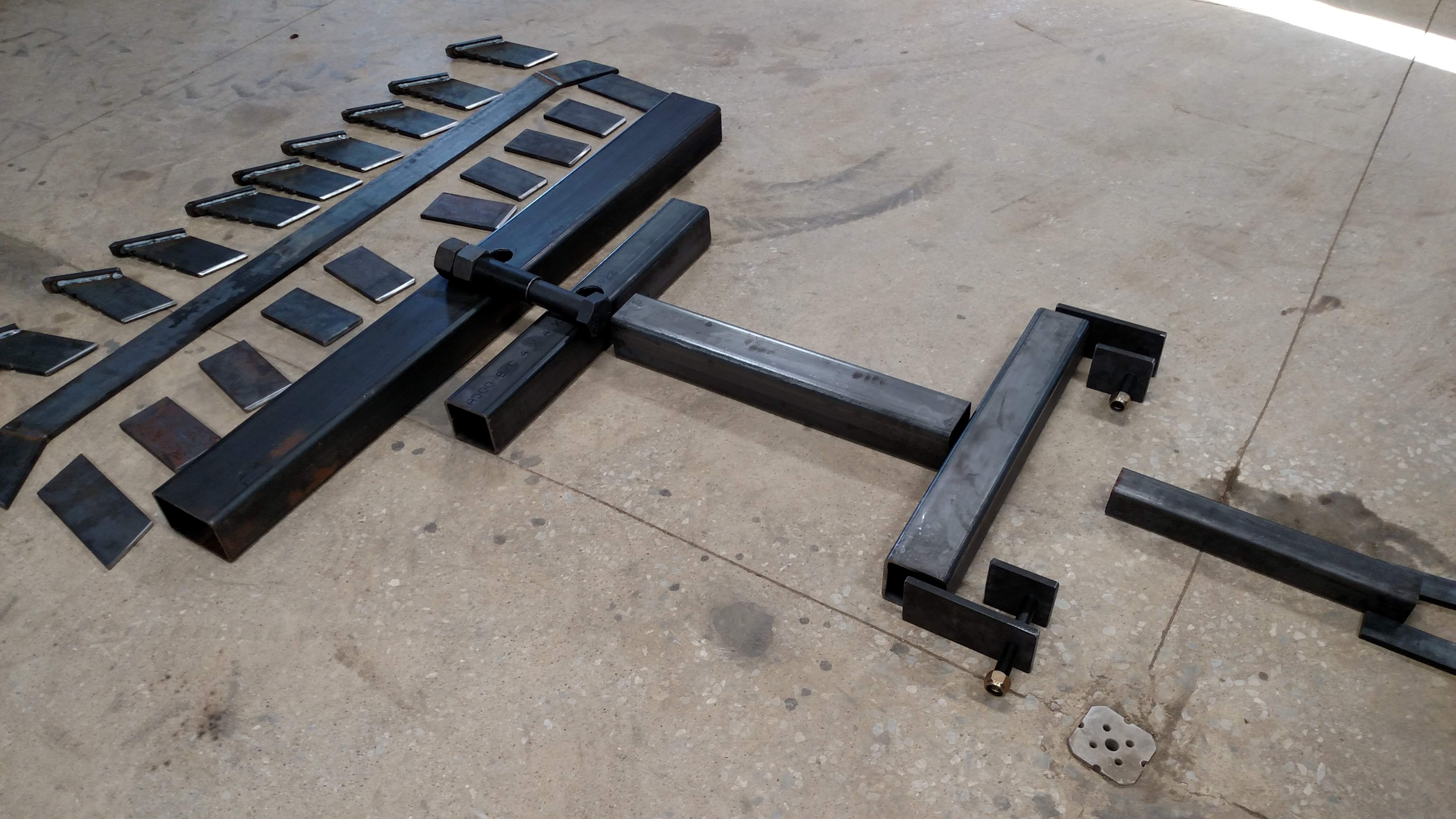

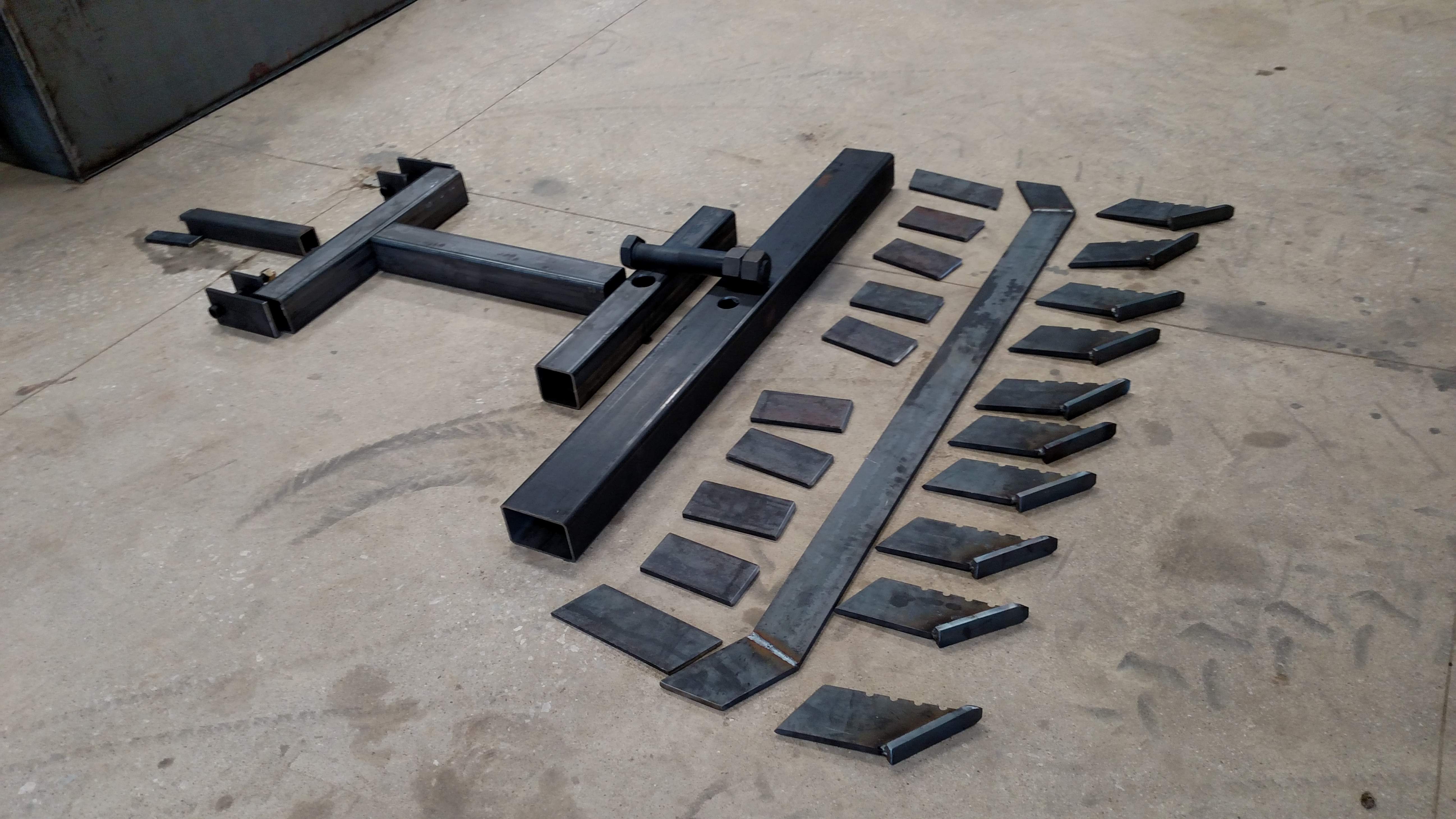

Got alot of welding to do tomorrow. All prices are cut and prepped. Not sure how effective it will be ripping roots outbut its intended to be a multi-purpose attachment to clean up debris from fencerow removal. Uprooting trees with the BH leaves alot of trash behind. Also will be used to bust up ground so the loader and blade can move dirt easier.

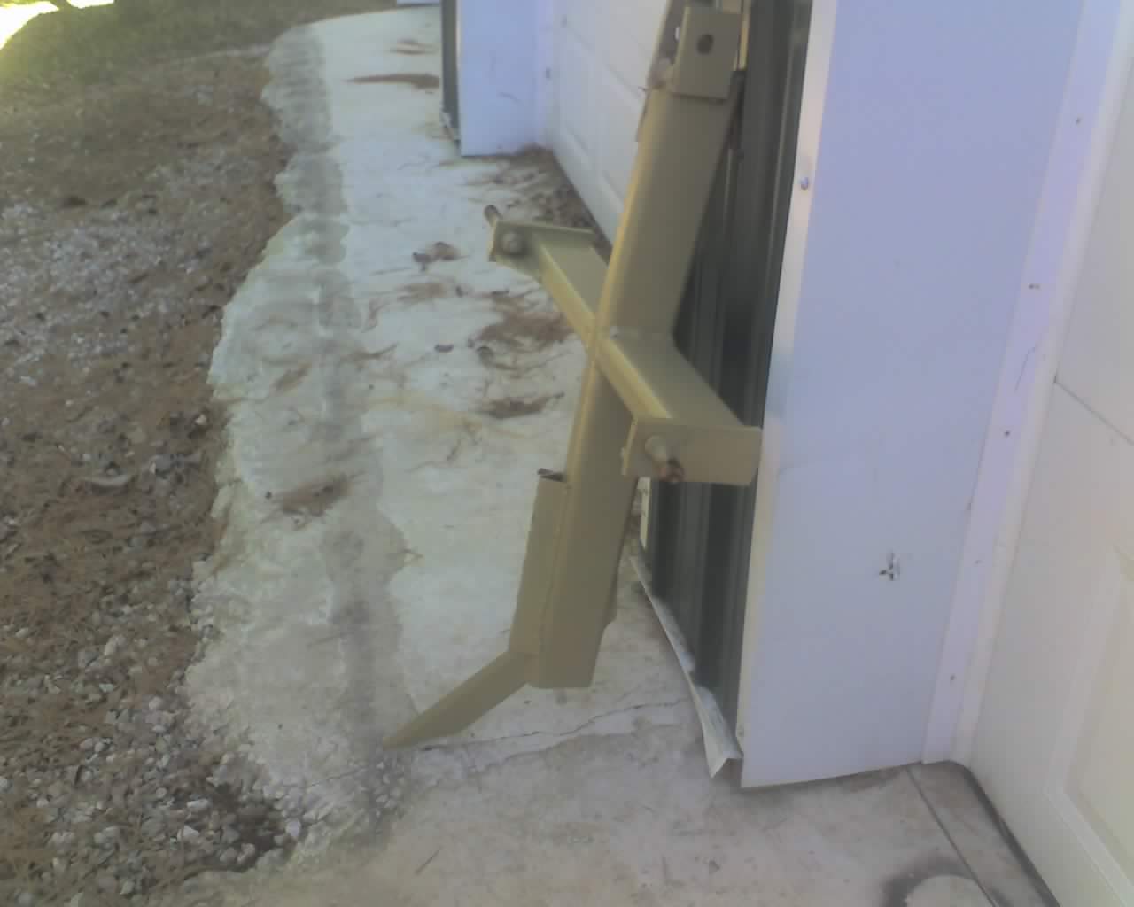

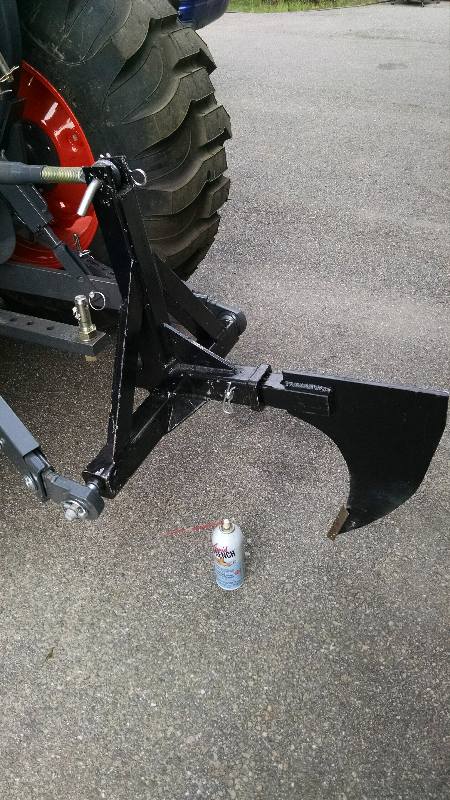

I have a single shank knife edge ripper. Works real well tearing through roots. What you cannot pull through, lifting the hitch usually does the trick. But it cannot get real close to a tree, so I made one for the BH. And. The single shank, while nice for slicing through, don't really unearth or gather debris. That's why I decided to go this route.
The single shank was also nice for doing invisible dog fence through the woods at my last house.

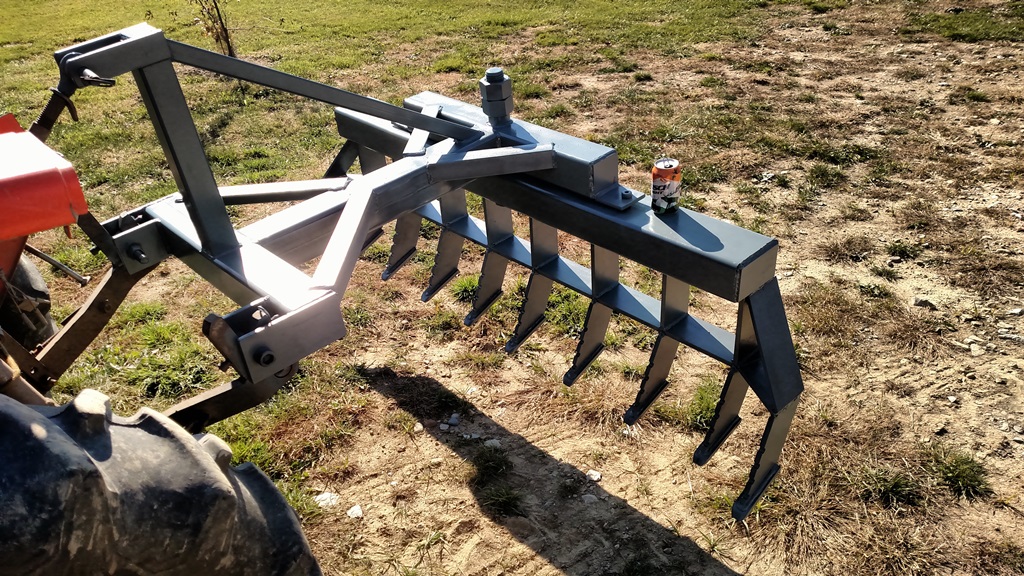

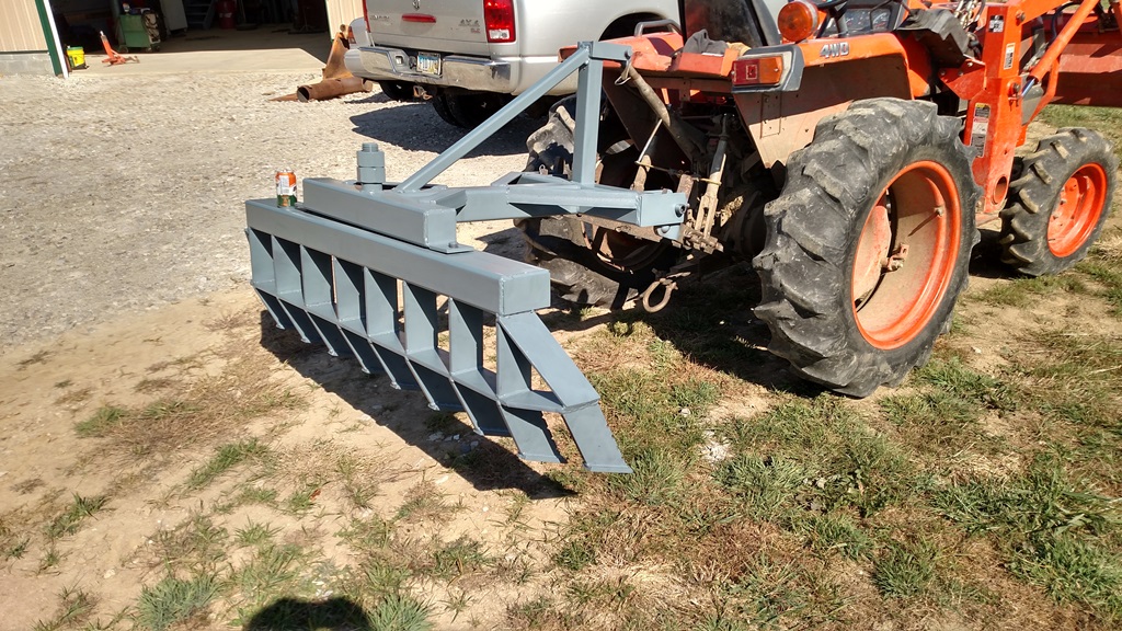

finished product
Tested it out a bit. It dont like heavy sod as it tends to ball up. But dirt it works as expected. Grabs roots nice too. More tractor would be nice, but it does just what I expected it to. Set it to cut about as deep as a disc, and it leaves results that look just like running a disc. Only without the noise and without the disc wanting to throw the back of the tractor around
   / 3ph root ripper build
How did you fab the rippers?
Rippers were just 1/2 x 4" bar, cut with the plasma on the appropriate angles. The notches were done in a mill. And the "tooth" is just a 6.5" long piece of 1/2 x 1-1/2 with a little grinder work.

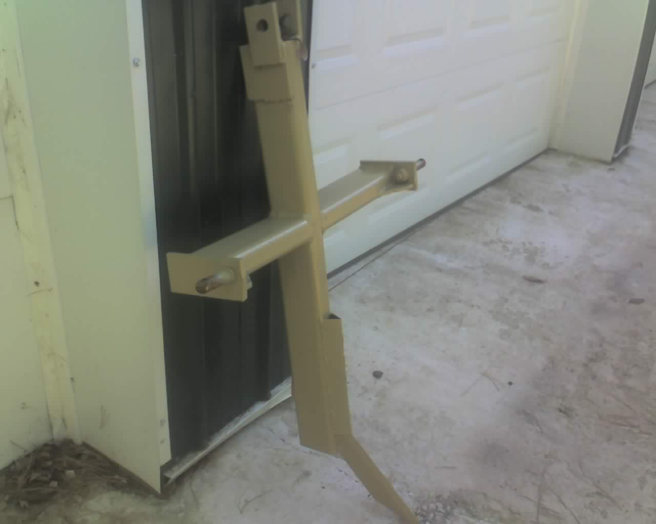

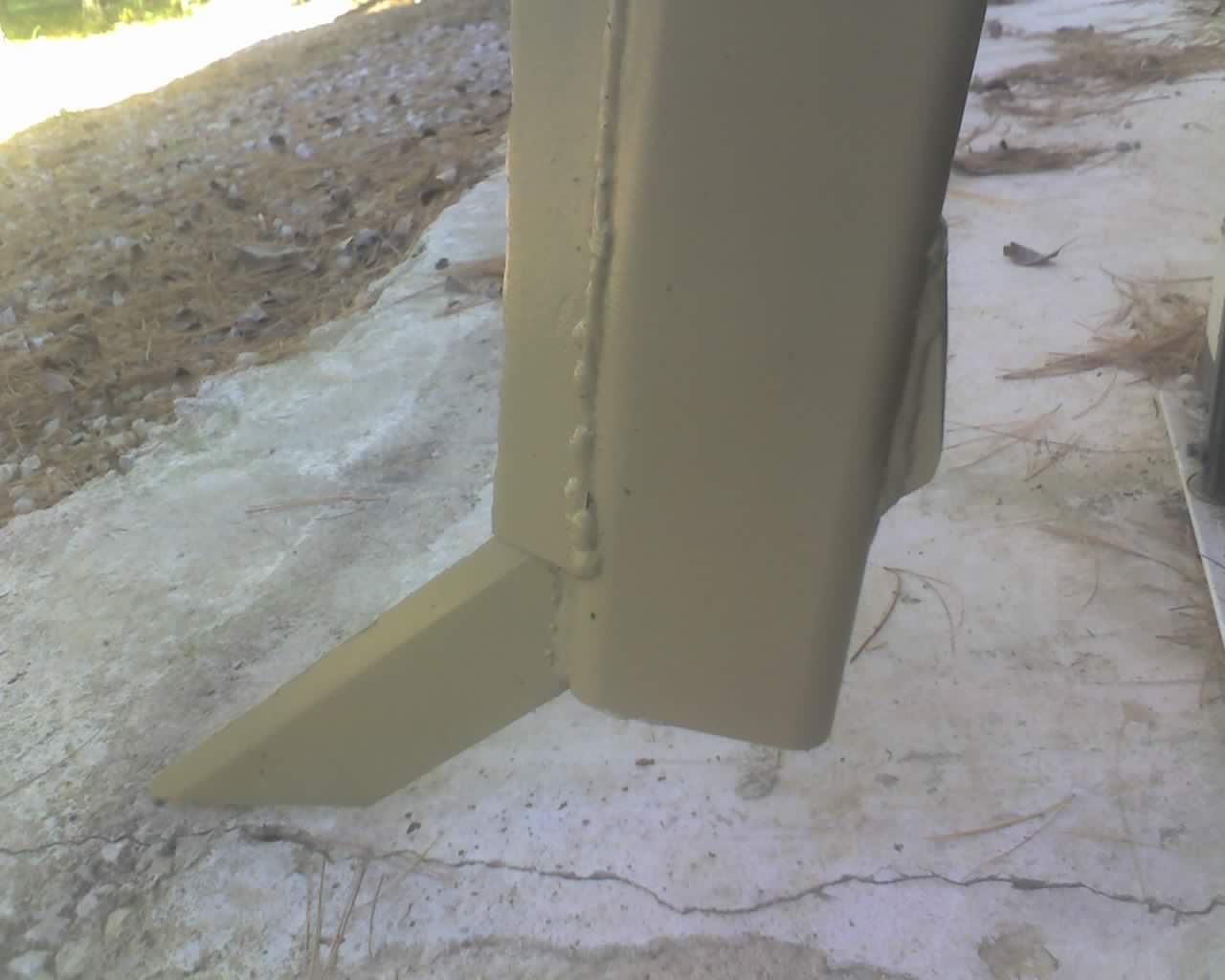

And here is the picture of my single shank ripper:
Its 2x4x1/4 wall tubing. The knife edge is inserted in the tubing on an angle through slots cut in the mill. That knife is 1/2x2 bar that is sharpened. SO if I cannot pull through a root, raising the hitch slices it nicely.

   / 3ph root ripper build #14
I see you put a heavy bolt in the center and a smaller on on each end of the frame. Are you planning on being able to turn it to an angle.
#17
NO angle. wouldnt really work trying to pull the teeth sideways.
ITs made to spin 180 degrees
