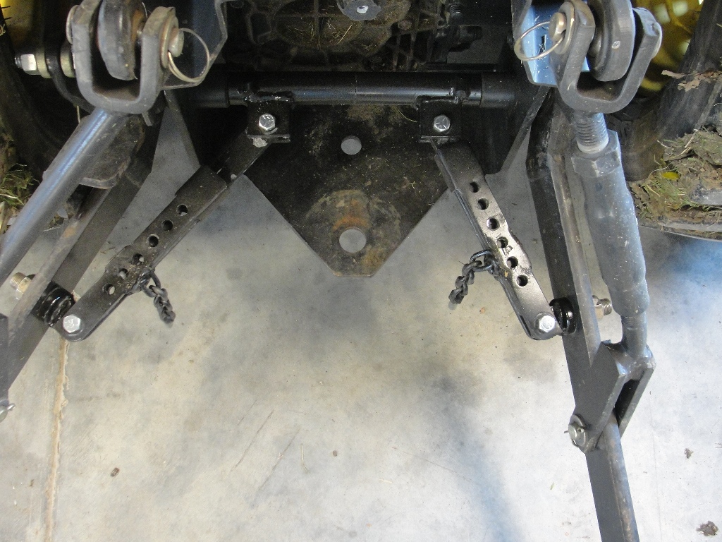

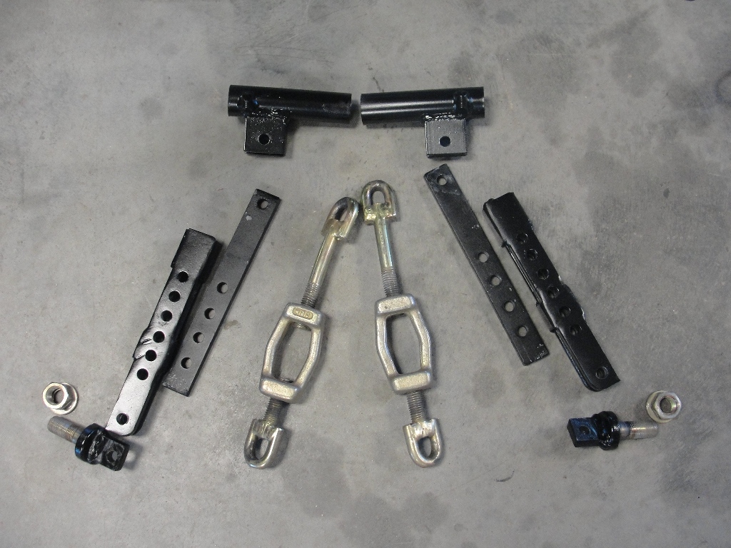

I hated them so bad on my 2210 that I built telescoping pin type. Now life is good.
Might check with your JD dealer parts guy and see if there's some offered that would fit your tractor if you don't have the resources to build your own.
