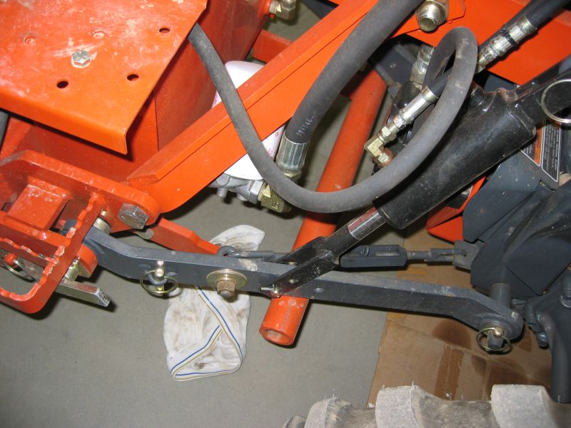

I have a 3pt backhoe question. I have a B4672 backhoe on my B7610.
What position should the 3point lower link arms be in - up or down?
Thanks!
   / 3pt backhoe question #2
The manual for my BL4672A backhoe says down.
The lower link arms should be resting on or near to resting on the pipe/bar from the backhoe like in the attached picture. My BL4672A is also an a B7610.

You may also find that replacing the stabalizer chains with telescoping arms makes general 3 pt implement changes easier and makes it easier to put the backhoe back on. Here is a thread here on TBN where I switched to the telescoping arms.

Hey Dave, did you loose something on the floor, there, in that pic? /forums/images/graemlins/grin.gif /forums/images/graemlins/confused.gif /forums/images/graemlins/blush.gif
   / 3pt backhoe question #6
Yeah, I did. Funny story goes with those rags too. Story is in the 3 pt thread I refer to, but I'll repeat it.
My grandson noticed I had old underware in my tool box and asked why. I told him it was used as a cleaning rag. He said: "ugh, how gross," made a face and walked away. My son-in-law was there and we both had a good laugh over that. A few years have passed now and my grandson is interested in dirt bikes. He'll discover all on his own about rags and how important they are.

</font><font color="blue" class="small">( thanks Dave. I couldn't find that info in my manual. Thanks for the conversion info too. That looks great and I will definitely do that soon. )</font>
That backhoe manual isn't laid out very well. I just went through it this past week looking for hydraulic fluid type and quantity. I just happened to remember seeing the instruction.
   / 3pt backhoe question #8
My B4672/B4690 manual has the note about keeping lever down on page 36. Lower left side.
