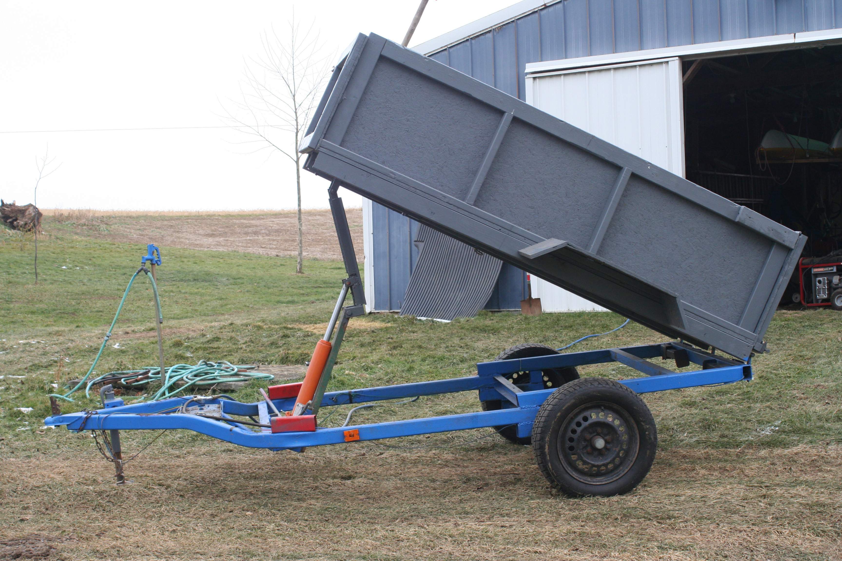

Well folks here is my idea...... I burn coal for heat, I buy about 3/4 ton every couple of weeks, I have a homemade single axle dump trailer that i currently use, but its too low for the coal to flow in the basement window. SOOOOO I am thinking of making a box to go on the FEL or a box on the 3 pt hitch, either way it would have to be like a mini gravity wagon. That way I could pull up to the side of the house, raise to the height I need and ramp it through the basement window.
Open for ideas or suggestions as to if this is feasible. I have a NH TC40 with a 16a loader. I wouldn't get more than 3/4 ton at a time even though the coal bin in the basement holds 2.5 tons, I like to keep it full. I know people put a lot on the carry all's with firewood, but I was thinking more of the quick attachment on the FEL. I buy coal 1/4 mile down the road from my house, too easy to get and gives me tractor seat time.
Any input would be great!

I have a TC40DA w/16A loader. It only gets about 1200 pounds up on a 4' pallet so keep your box as wide as possible and as close to the tractor front end.
Or
I am assuming you have a bucket for your loader? Mine is about 1/2 yard. Why not make a chute through the window and just dump the bucket into it? Then you wouldn't have to worry about your loader capacity

I thought about that too, making a 6' box/chute outside and pouring in, only thoughts would be 2 or 3 trips more seat time though:thumbsup: any ideas on the 3pt end, I should be able to get the height when I raise up.

I'm thinking like a small gravity box 4'wide 4' tall and 2' deep with a pitch at the bottom to a coal chute. that would get me around 30+ square feet, they figure 40 for a ton of coal, but its actually 36 square feet. So in theory I could hold 1 ton, but i know I won't load it that full, do I put it on the FEL or on the 3pt? I scan some sketches tomorrow if I get a chance.

If you put it on 3PH, it would help to have a hydraulic top link, you already have a tilt for FEL.
Just had another idea. If your dump trailer is too low to dump into basement window, how about making a ramp to back trailer onto? One less handliong of the coal?
   / 3pt carry all gravity box? #10
Show a picture of your trailer. That might help, the 3pt with a dump well be low when dumped.
