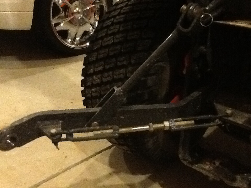

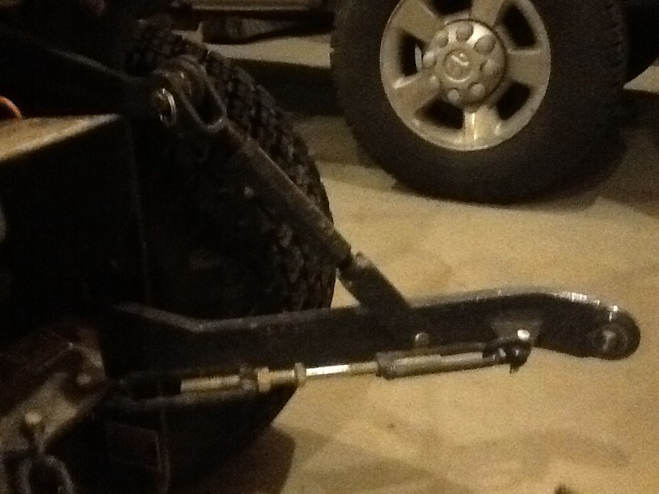

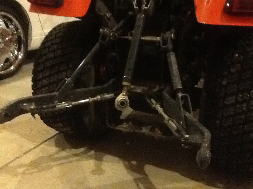

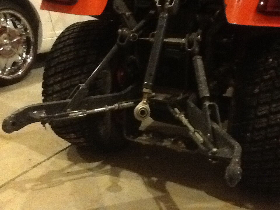

I looked at my 2360, and I don't have the adjustment pins like is shown in the link you posted. The vertical turnbuckle is on the left lift arm as shown, but that only lowered the right side lift arm. The only thing I can see is to remove the upper arms and re-position them on the spline. This may be a warm weather project, since I don't use the 3pt hitch during the winter.
   / 3pt hitch height #9
Maybe post a pic of your 3 pt setup. I have a different tractor but my arms will almost touch the ground when lowered. I have to be mindful of what position the arms are before I run the tractor so I don't hit something low backing up.
As you mentioned, it is possible the arms were installed on the wrong spline at the factory.

Here are a few pics of my hitch.
As you can see there is no adjustment in the lower lift arms. I tried to take a photo of the spline area as well. I opened the flow valve all the way and lowers the hitch to its lowest possible point for the photos.
