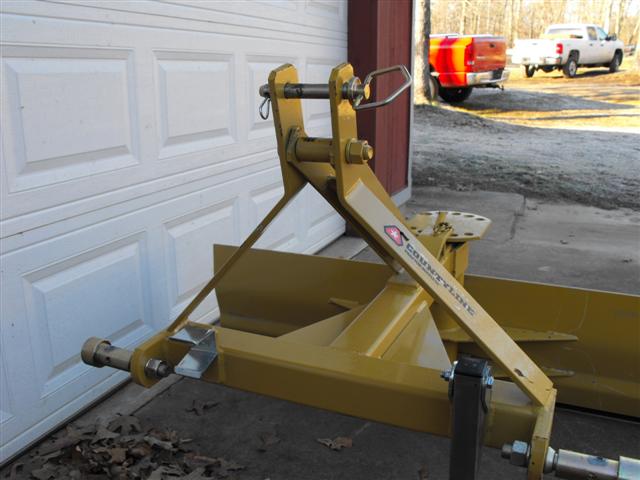

Yesterday I took my gannon box off the back of my tractor, to use the draw bar to pull a trailer. Also, for the first time, I realized that it was connected entirely with quick disconnect pins, EXCEPT for the top connection on the 3pt hitch.
That was a bolt with a nylon locking nut.
While at the local tractor shops, I see the various 3pt items sitting around, for sale, also had the same top bolt setup.
WHY? Why not a pin all around? I don't see there being a need for the bolt, as it would be easier and a wrench free operation without the bolt.

I agree, ditch the bolt.
My Frontier BB has a bolt, but that works fine for me because I have a quick hitch and that may be why your blade was set up that way.
   / 3pt hitch question #7
If your looking at something like this, the lower bolt (or pin) is for a quick attach hitch and is usually a bolt or welded pin. Gives the option to use either the quick attach hitch or the standard top link.

OK, I was wondering if there was a REAL reason. There is no setup on this box for a quick attach, so it must have been what was available at the time.
