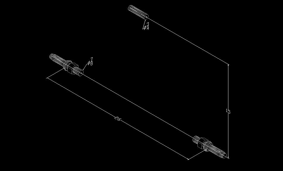

Rozett,
There is an industry spec. I can't remeber if it is an SAE or it might be an ISO one now. I tried doing a search yesterday for it, but came up empty. I'll post if I can dig up something.
/ 3pt hitch #25
Re: 3pt hitch (Specs)
The ASAE spec for cat 1 is 26" horizontal from the inside of 7/8" lower lift pin to inside of 7/8" lower lift pin and on a vertical plane 15" above is a 3/4" top link pin. Check the attachment.
So, if I understand what you are saying in your post, Jim, the height from the lift arm ball ends to the ball end on the center link of the cat. 1 3-pt, should be 15", correct? At the center of the ball ends. So, it should be a 26" bottom width, and then at 13", which would be the middle of the lift arm width, up 15" should be the center link ball end.
The dimensions I gave were for the implement end. The tractor end varies depending on the tractor.
