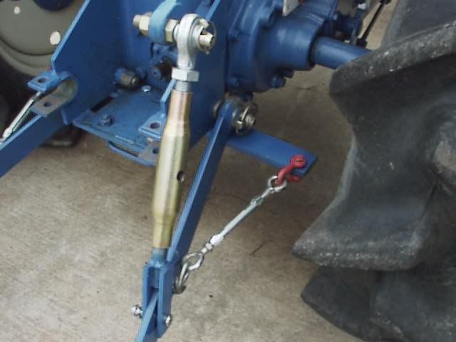

Re: 3pt hitch (Specs)
Nick,
What is the part number for the pin that you have on your 3-pt that connects the lift arm linkage to the actual lift arms of the tractor (the two that stick out the back of the tractor)?
Do you know what pins I mean? They are threaded, and attach to the adjustable linkage that then goes to the lower lift arms.

/ 3pt hitch #30
I am not sure that we are talking about the same thing. If you look at the post on the previous page that says " here is a closer look", and you look at that picture on the left hand side of the the picture at the top, there is a pin that is threaded on one end and then has a smooth pin like look, like a forged 3-pt implement lift pin that you could purchase from ASC or something. I want a pin that has the 1/2" threaded end on it, is what I am saying for that purpose. One, that I can put a lift arm linkage on, that goes downward to the lift arm, from the actual lift arms on the tractor, so that I can put a ball end adjustable lift arm to the actual lift arms on it.
Sorrry for the mis-use of the "jargan", I am just not sure what to call it.
Aric

/ 3pt hitch #32
You may want to look at a Category 0 lift pin like would go on the implement. I used those size pins on a small Satoh tractor for the same thing you are talking about. See the attached picture.
/ 3pt hitch #33
The dimensions I gave were for the implement end. The tractor end varies depending on the tractor.
