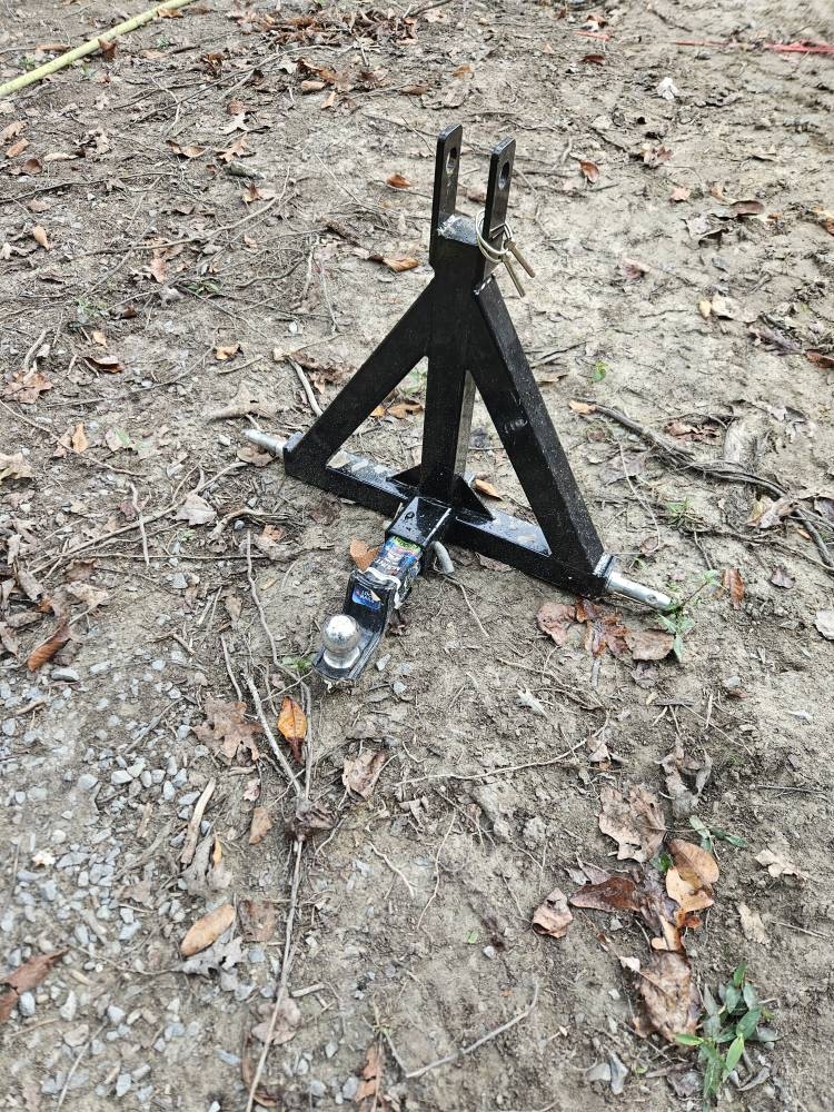

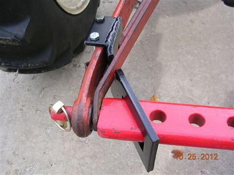

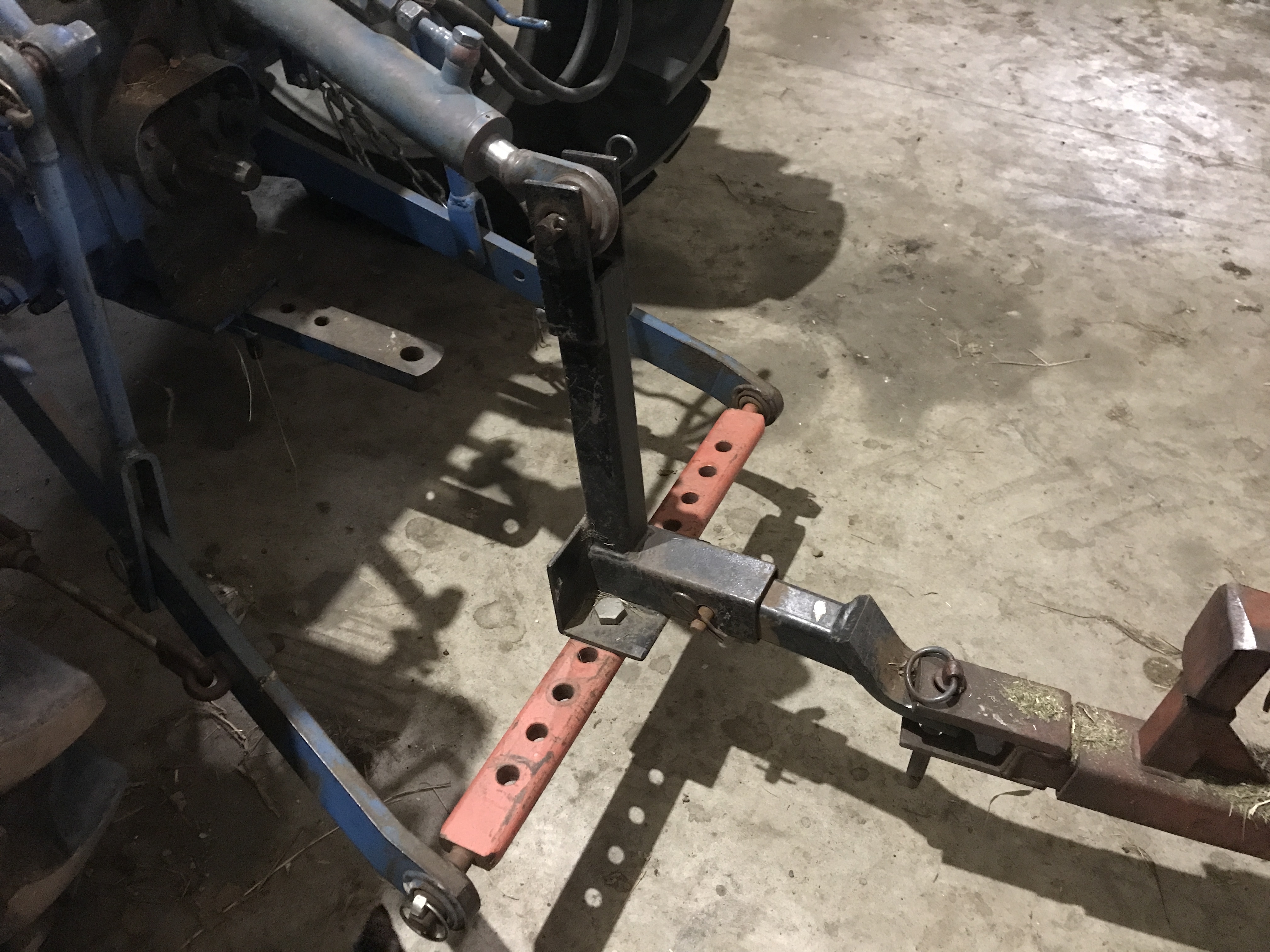

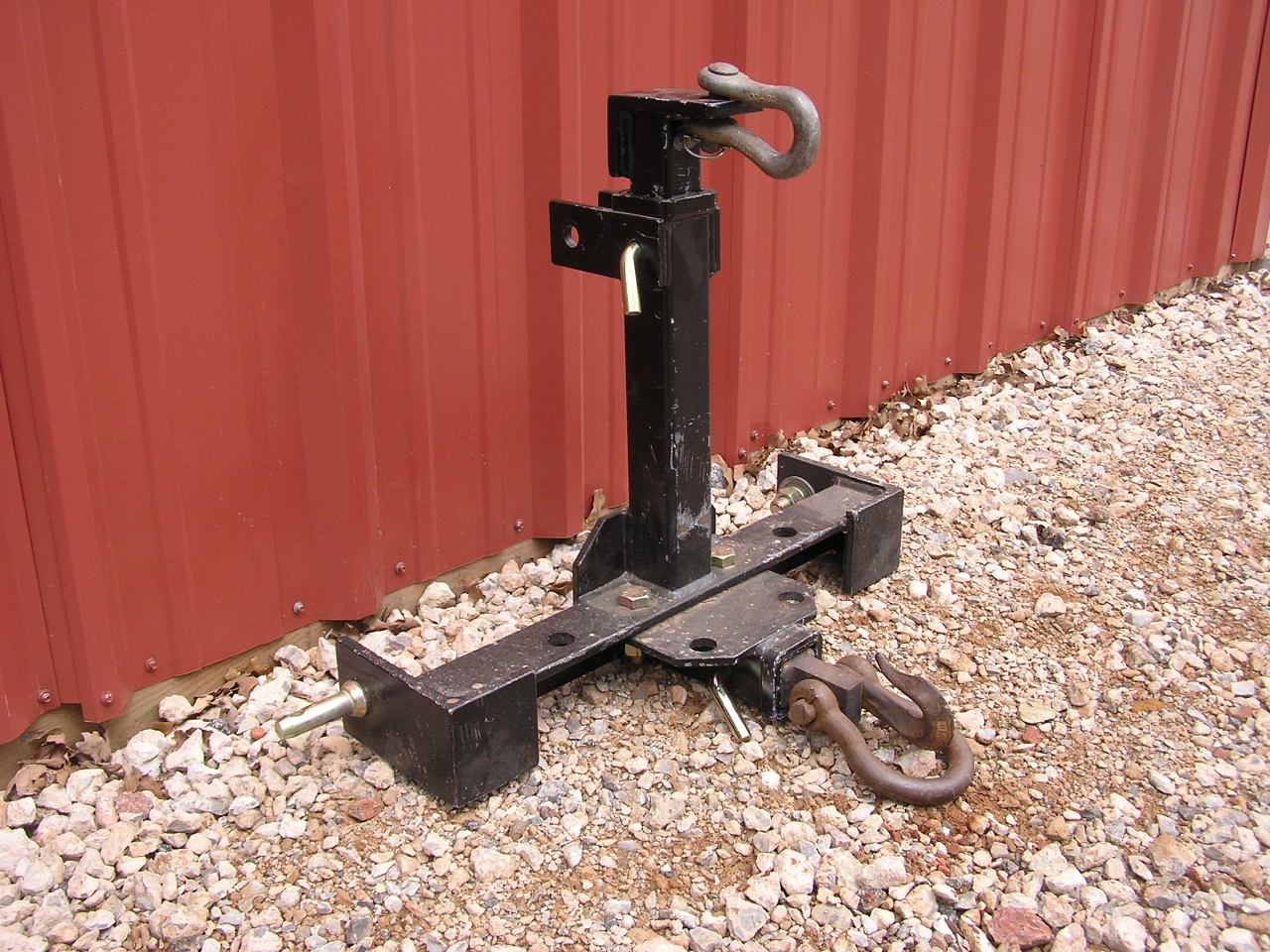

Years ago I bought this 3pt hitch from a vendor that advertised here.
The black part, supplied my own red part.
Is that vendor still around? It had a gold and black sticker on it if I recall, but don’t remember the name and sticker is long gone.
I’d like another.
I can’t weld as good as the vendor could….
Paul

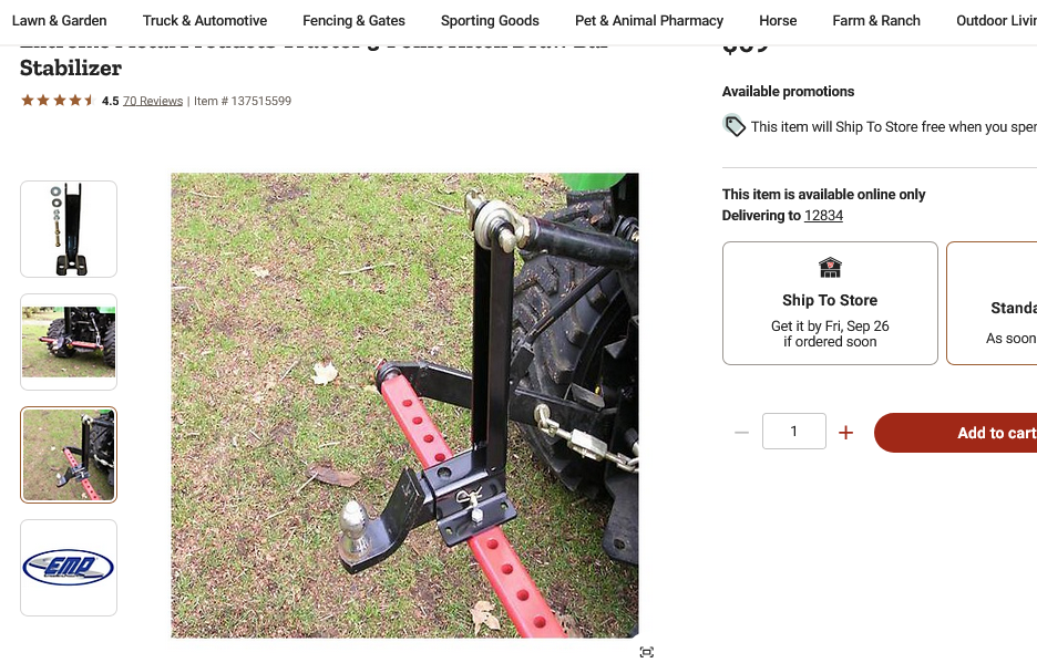

A 3 point drawbar stabilizer;
/ 3pt hitch? #3

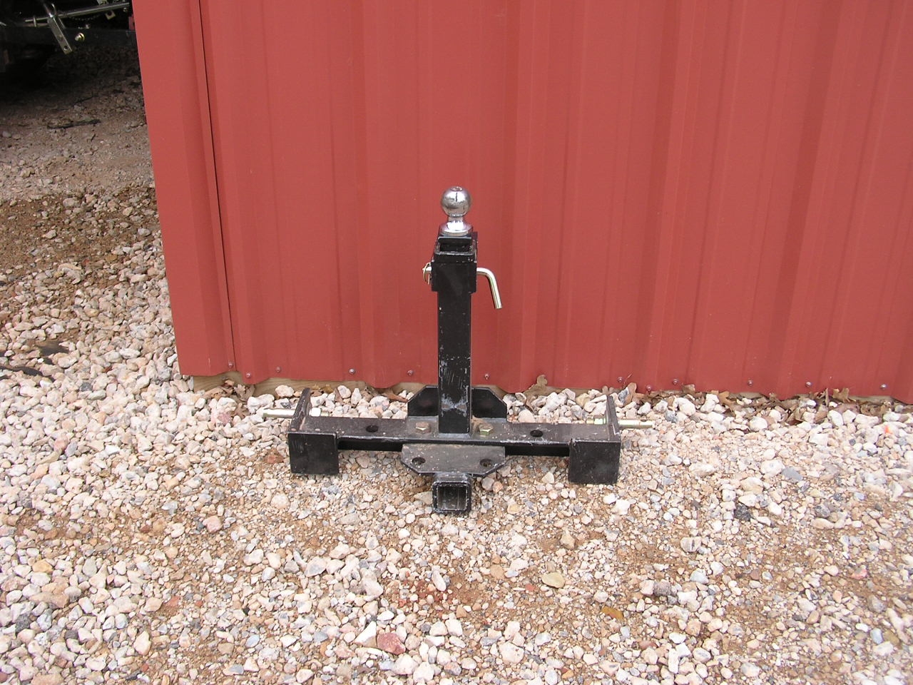

Welded three point hitch receivers are available for around $50 on Amazon... I've got one and its fairly sturdy.
/ 3pt hitch? #5
For towing around the property, I just put a ball into the crossbar, and no stabilizer. As long as the hitch is good, it doesn't seem to roll the ball out of the hitch. But, rather, it tows just fine. Slow speeds, etc.
2 5/16" in an enlarged center hole. 2" on opposite side, and a bit over towards the side so hopefully they don't interfere while turning.

The manufacturer is extrememetalproducts.com (you can buy direct from their site)
Keep in mind that it doesn't include the receiver hitch or the draw bar.
Same here only I use a anti roll fixture that clamps on crossbar and goes to 3PH arm to keep it from rolling...

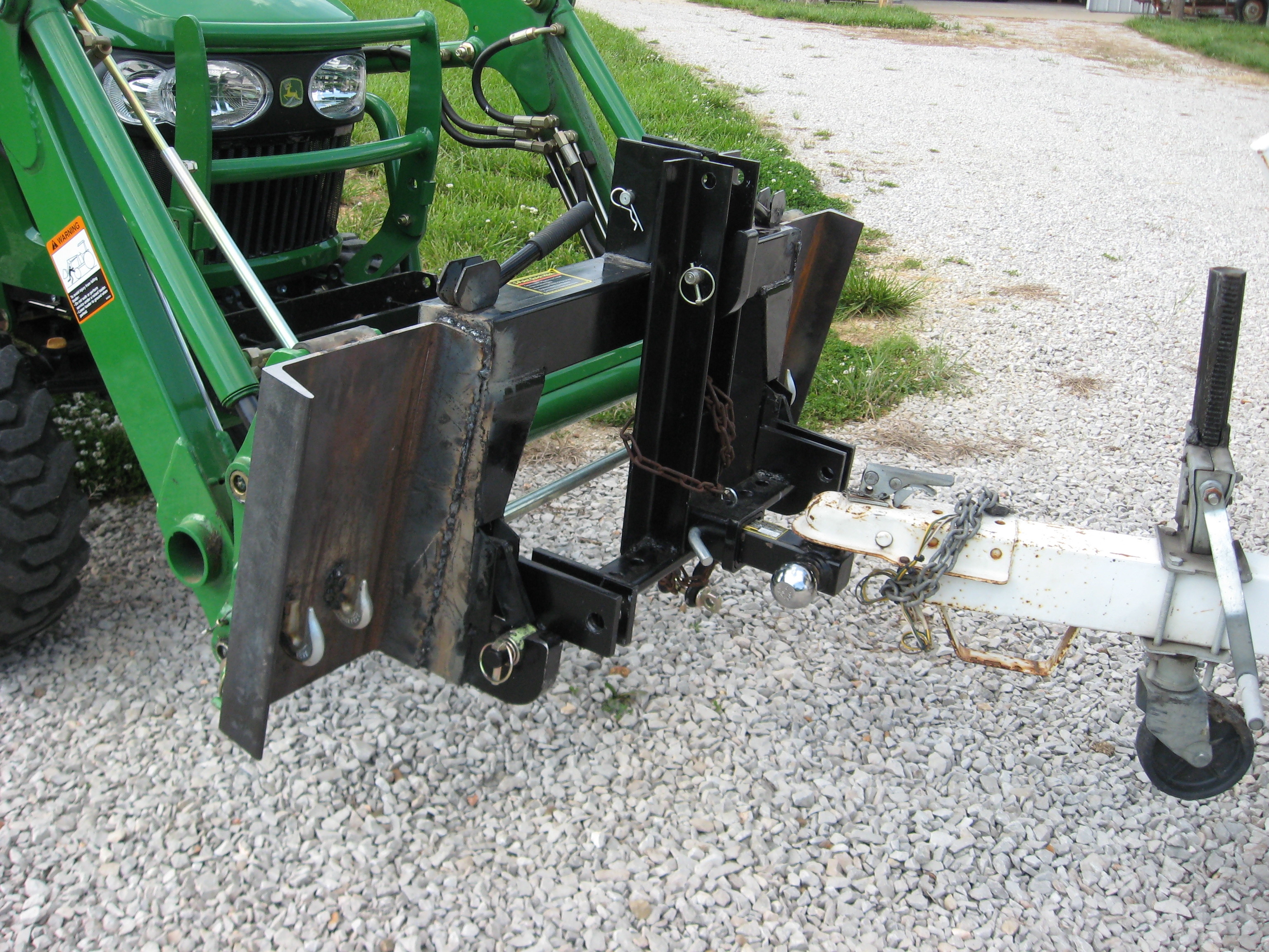

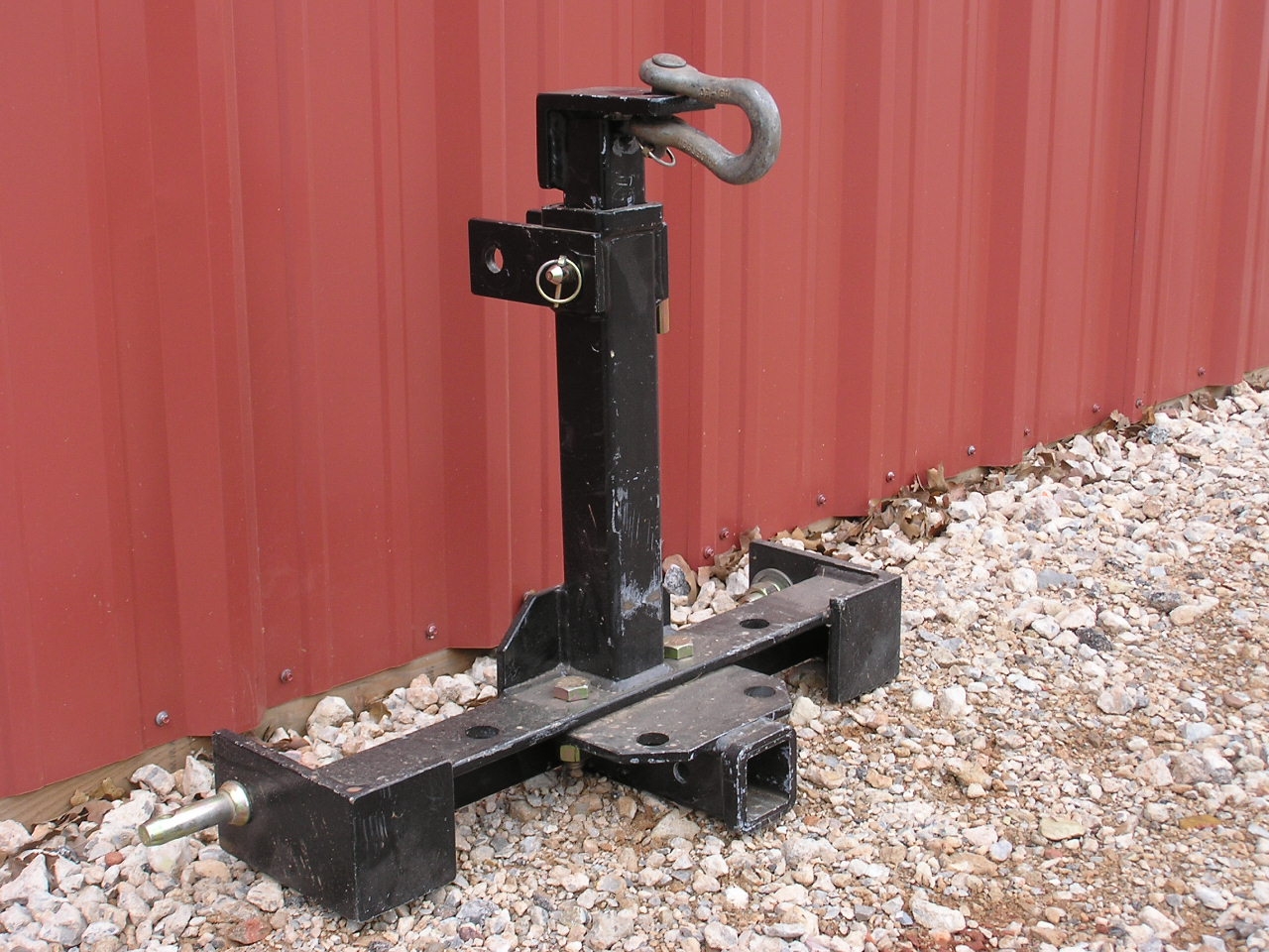

Man, you guys have money. I made one myself but it is twisted in the middle so I can use a 3/4" bolt in the drawbar instead of the rectangle slot.

I should add I use it for moving big farm machinery around in and out of sheds, around the yard, with my small maneuverable tractors. is why I was looking for a good strong one again. Lifting the chisel plow makes the tractor grunt about as much as a 1500# round bale, so some of those lighter welded ones I’m scared of. Need to slip in pin hitch, small ball hitch, and big ball hitch for the different things I move from time to time. I need it heavy duty but light weight, I switch a lot of machinery with crops and livestock and hay….
The cheaper ones seem very light on that vertical connection, or very light pin connections to the hitch ears. The heavy build ones seem - heavy as well as expensive. The one I have seems a good compromise.

Looks like something Saginaw used to sell. They closed down years ago, but you can sometimes find their hitches secondhand on classifieds or auction sites.

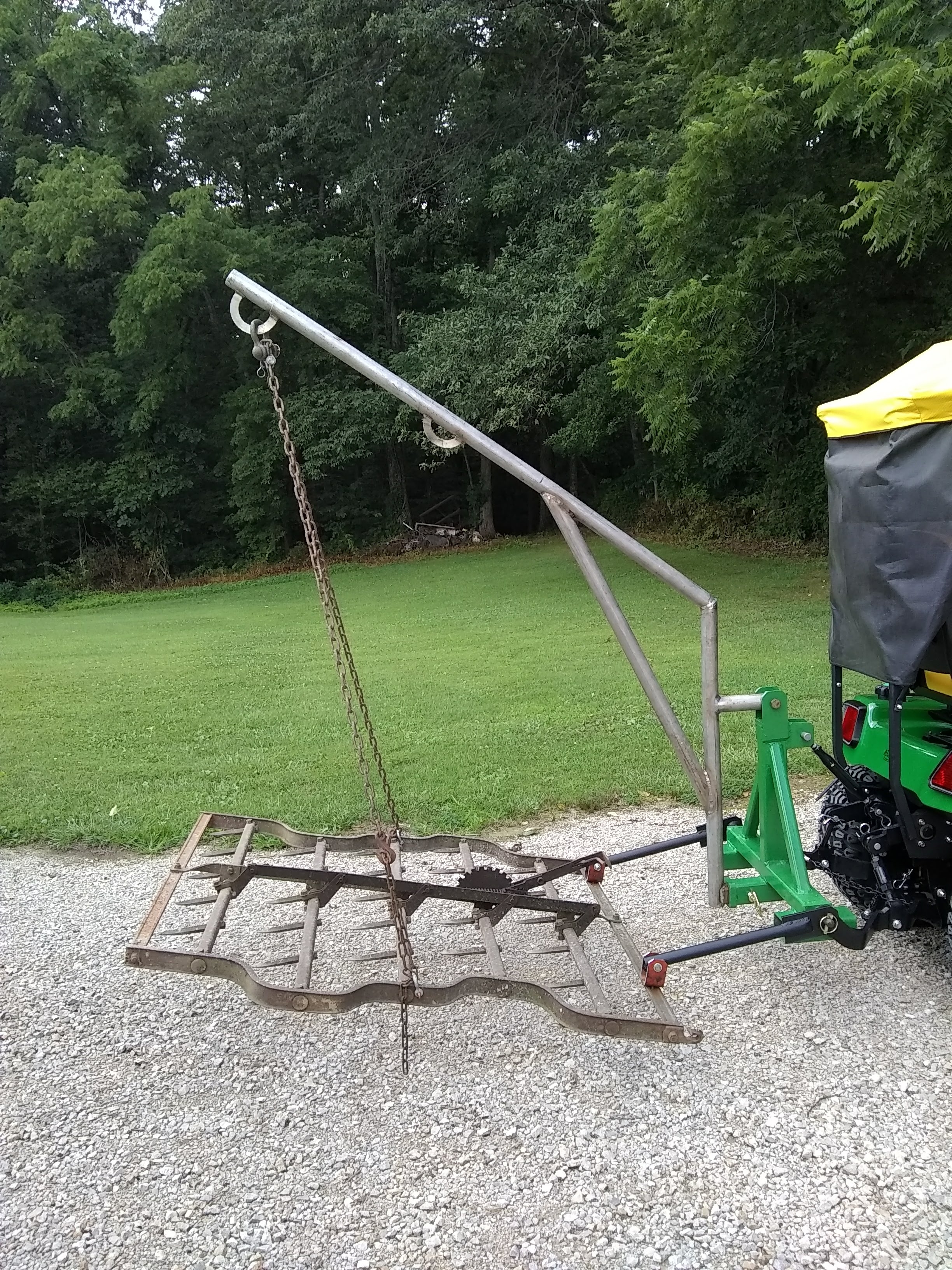

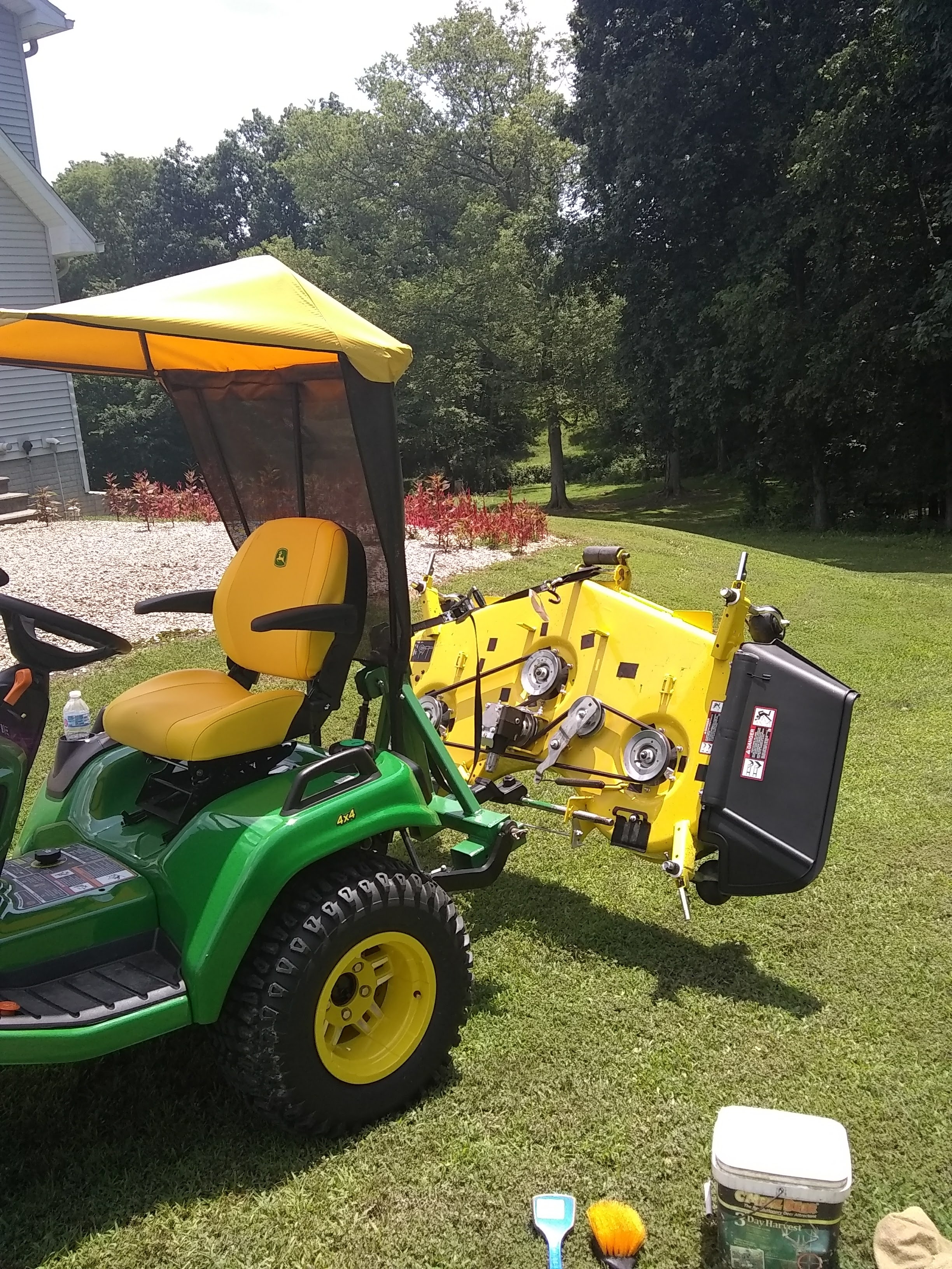

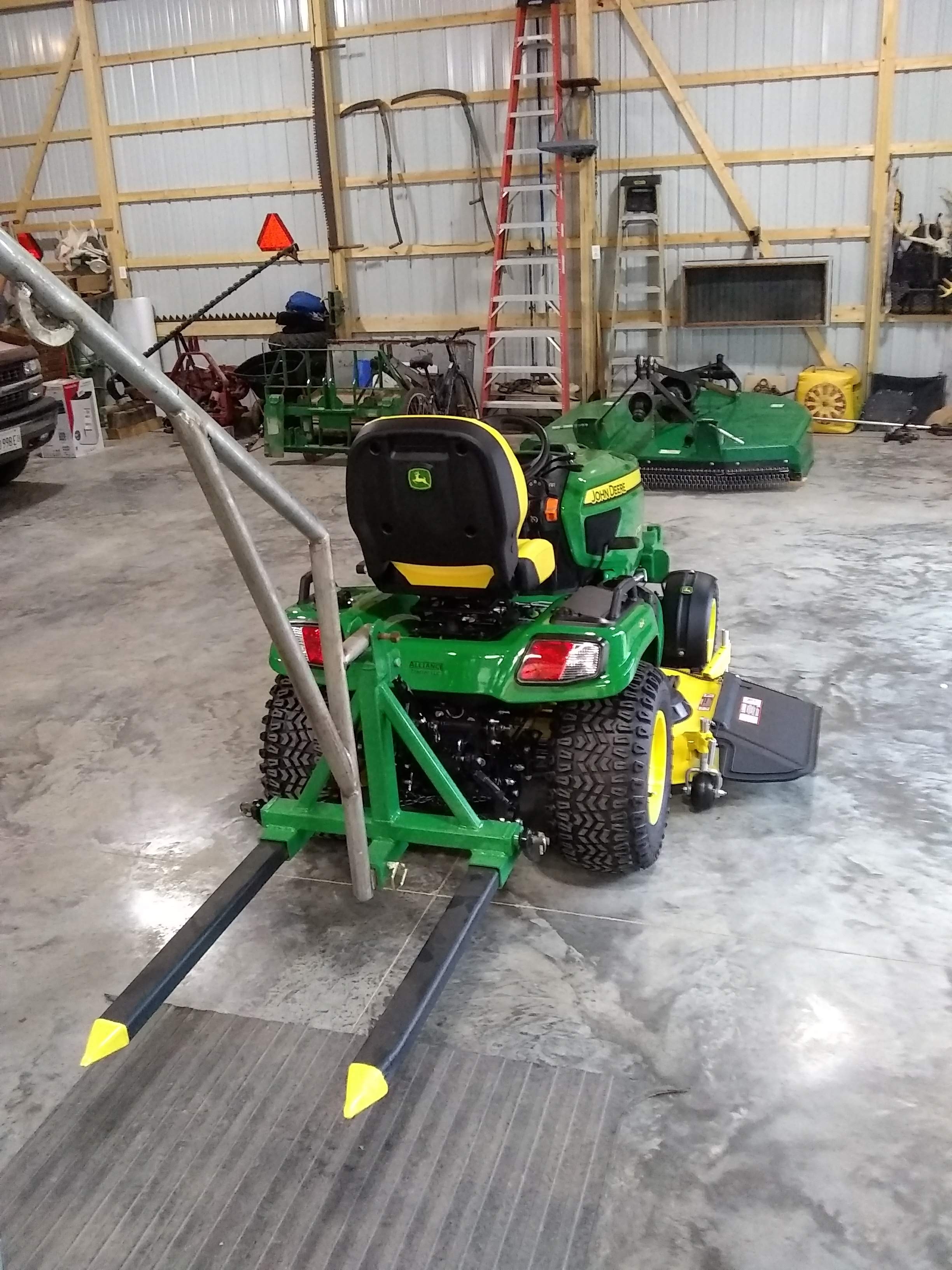

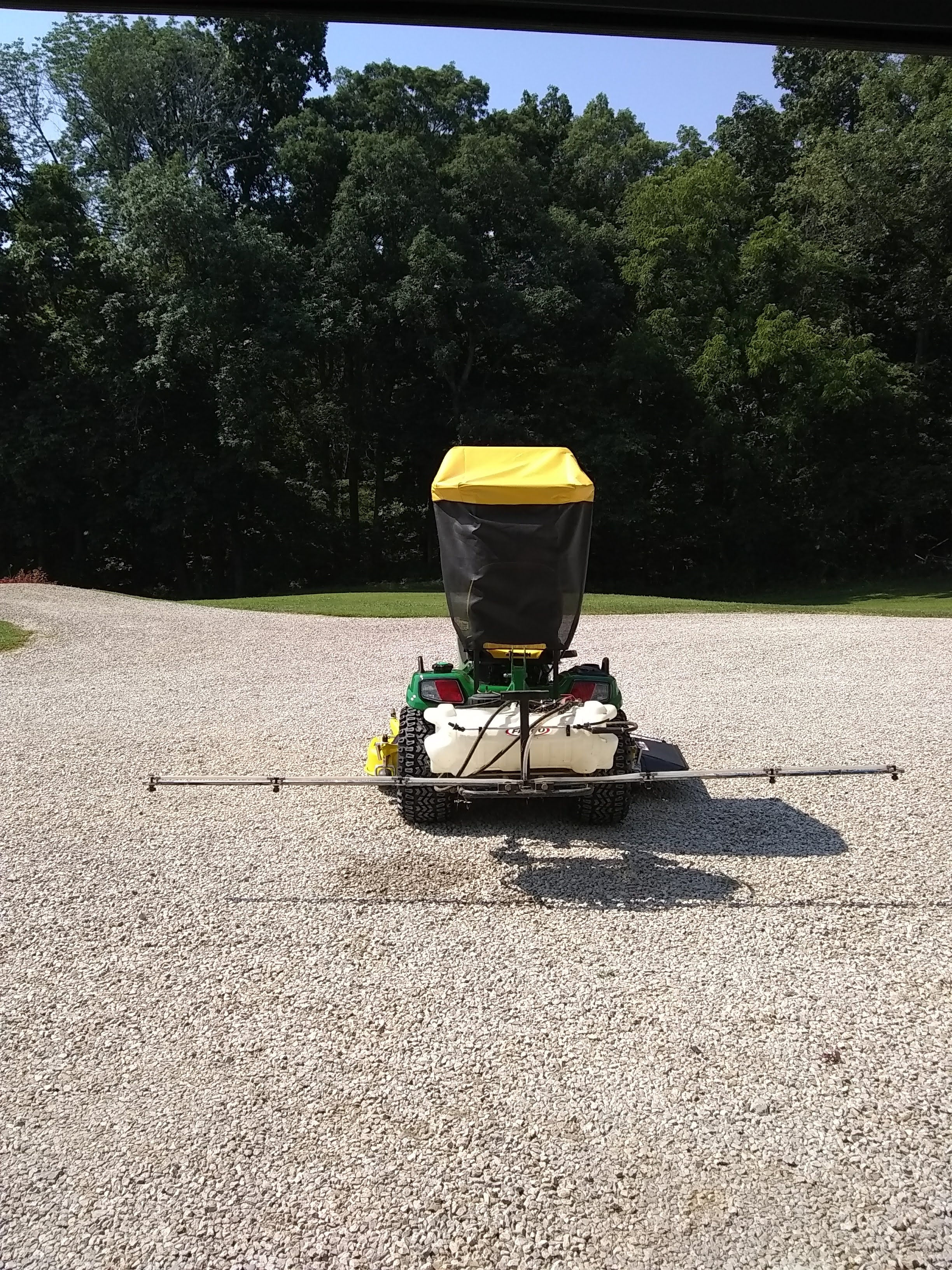

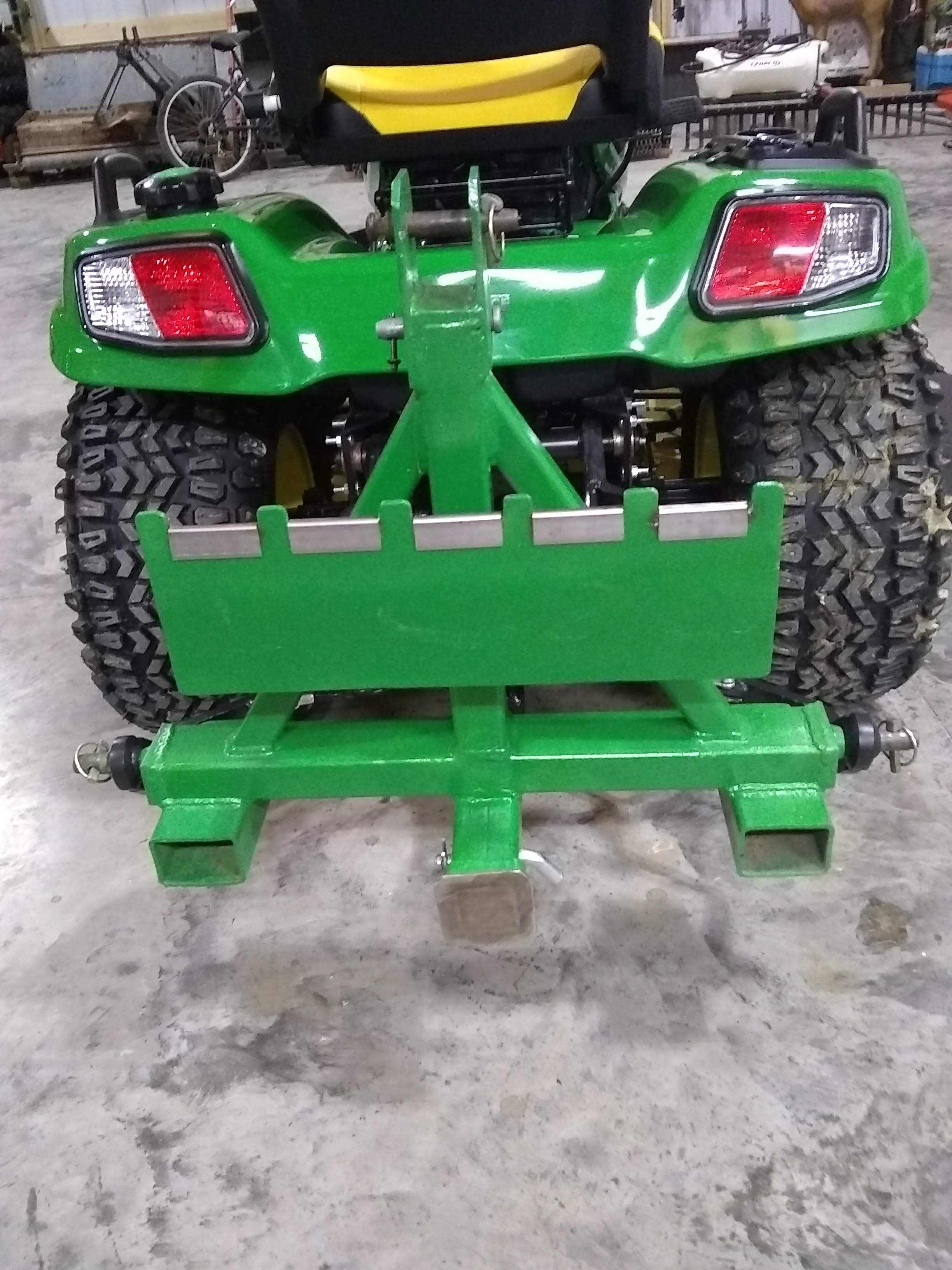

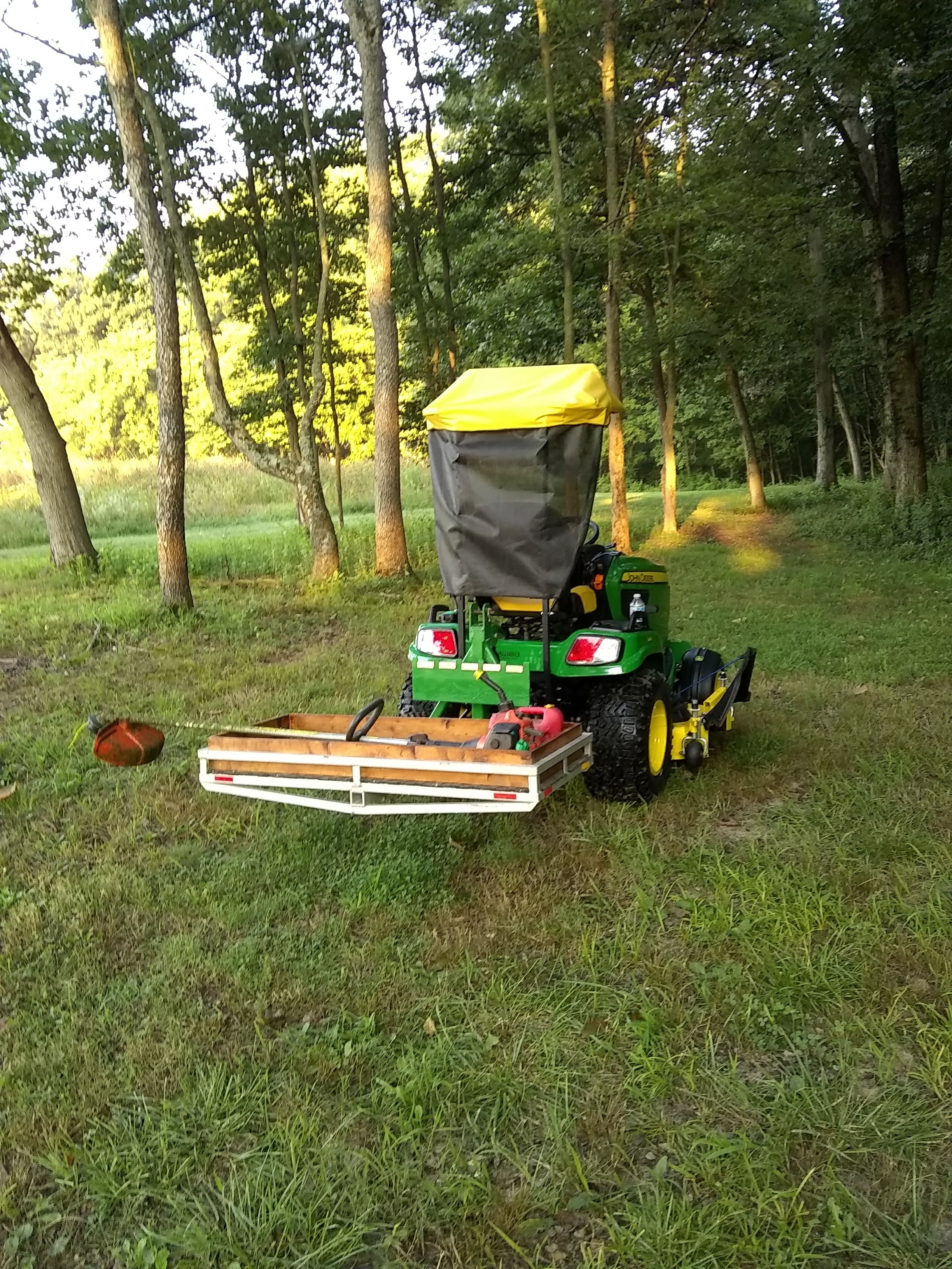

Another one I built which is multi functional. Carry's five John Deere weights, removable forks, removable boom pole, Carry's sprayer, and mid deck for cleaning.

This is the $55 version I bought on Amazopoly. Its moved my utility trailer loaded a few times, and should be able to move my travel trailer (says it can handle 3000 lbs and the tongue weight is under 1000 lbs).
/ 3pt hitch? #16

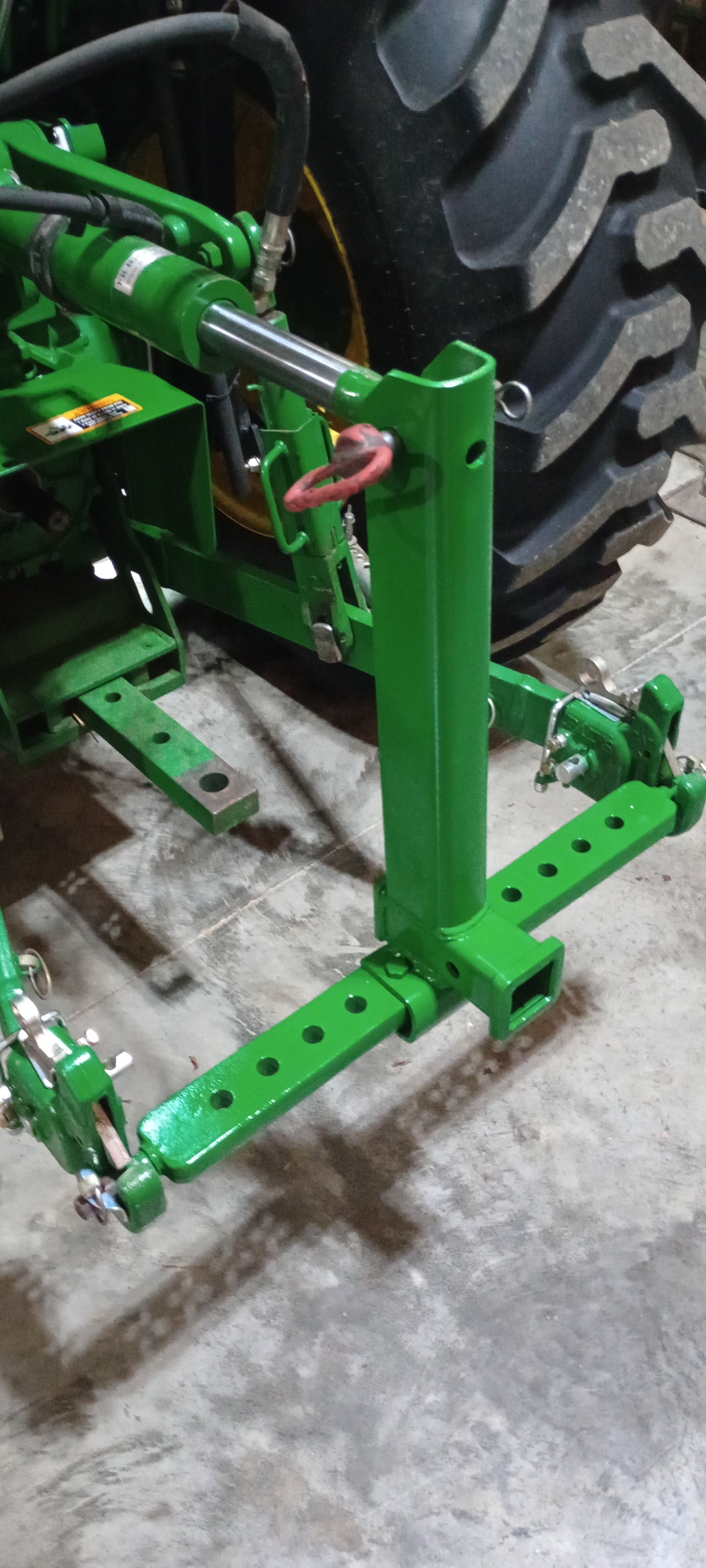

I made this one from a drawbar and some angle iron.

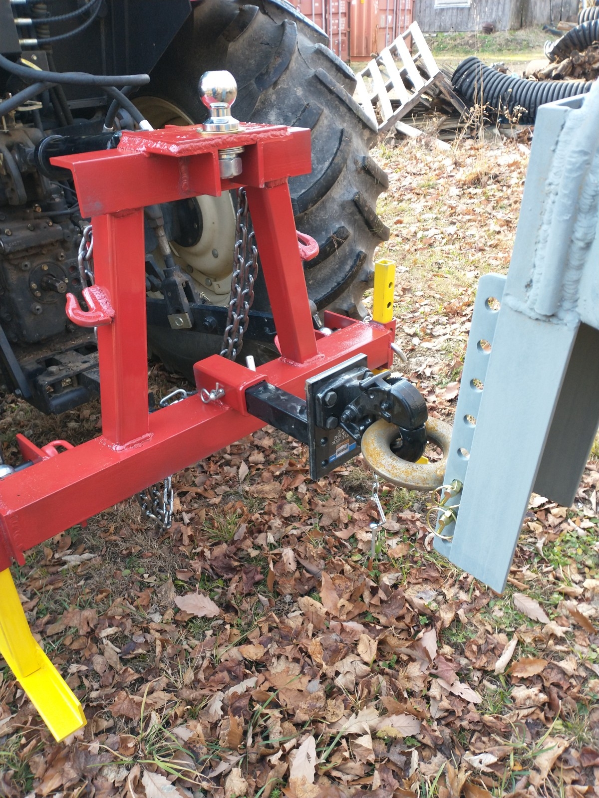

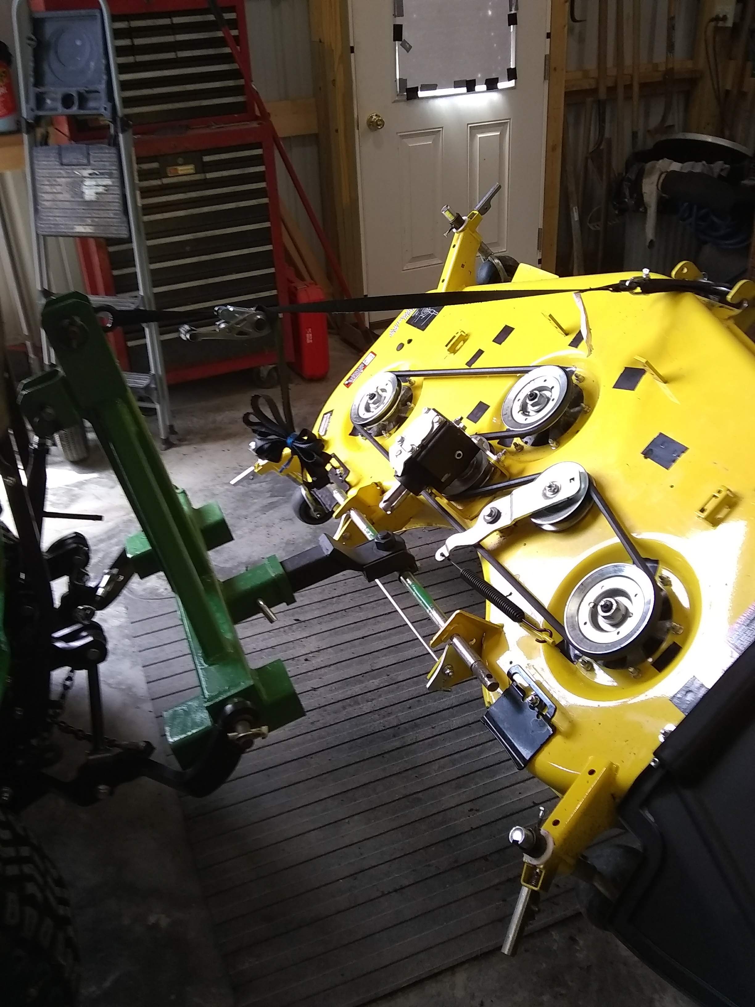

My hitch is abit heavier but quite functional.
I've also set it up with limiter chains so a trailer can lift it to high.
The yellow stands are removable, but make it easy to hookup.
