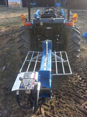

So we just had an Out Door Wood stove put in during December. It works great, but I'm going through a lot of wood with this cold spell. I also wasn't stocked up for this increased demand. Long story short, my wife got tired of me being tired from cutting and splitting wood several times a week. She went online and bought me a wood splitter.
Powerhorse Horizontal Dual Split 3-Pt. Log Splitter — 20-Ton, 4in. x 24in. Cylinder | Log Splitters| Northern Tool + Equipment
I've got it hooked up and when I get home, I will get a good picture.
I thought I would give a review, now that I used it a little.
It is 20 ton and runs on the hydraulics from the tractor. I bought my tractor with the backhoe, so I am using the lines that come from under my right foot to the back of the tractor. I did have to buy lines from the splitter to connect to these lines. (I'll make sure to get pictures).

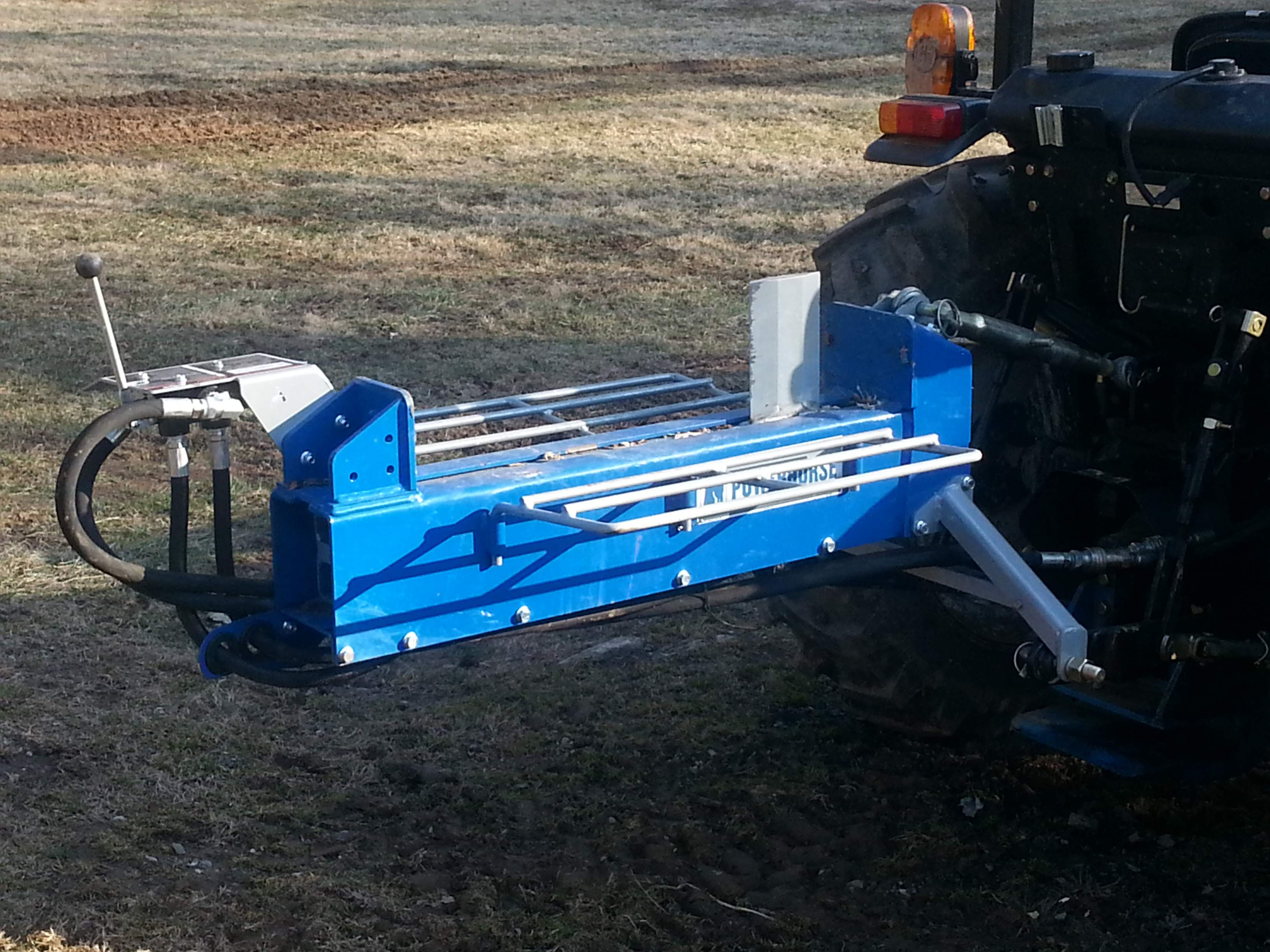

Positives:
* It runs off of the tractor, so 1 engine to maintain
* It is a lot cheaper
* Good quality (Only used over the weekend, so will have to see how it goes)
* Only does 24 inches (Anything bigger and I might not be able to pick up the thicker logs)
* Splits in both directions
* It's a baby blue shade, that almost matches the LS color ;)
Negatives:
* It lays flat instead of up right, so you have to lift the logs on to it (I would not recommend, if you aren't supposed to lift heavy items)
* Only does 24 inches (This is both a + and a - for me, the out door wood stove will handle up to 34 inch logs)
I have a plan to build a box for it. That way I can use the front loader to move it where I'm down trees, but still keep my back hoe attached to dig up the stump. I'll update as I learn more about it.
   / 3pt Log Splitter on L3033 #2
I built two sturdy little saw horses that I store my splitter on, just the right height to hook up to the 3 pt hitch and I use them when the backhoe is on the tractor to hold the splitter for use. Extra length hoses allow the splitter to run five or six feet from the tractor. However, I do not use the backhoe in the winter, so I try to do most of my splitting in the fall after I have taken the backhoe off and before I put on the snow blower. With the splitter mounted on the 3 pt hitch, I can lower it pretty close to the ground for those back breaker logs.

Sorry guys, I just realized that I never posted pictures of the wood splitter. It almost matches the color or the tractor. :)
