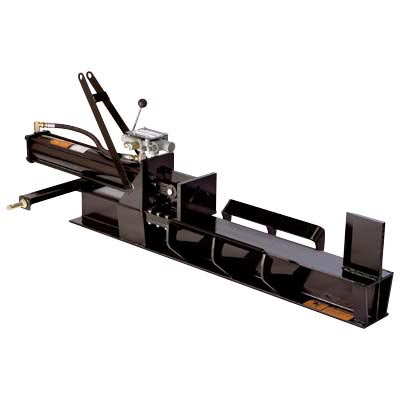

   / 3pt log splitters, What,s a ggood one? #5
Northern TooL makes one.... Northern Tool and here is a place where you can buy a make your own kit MetKit.com

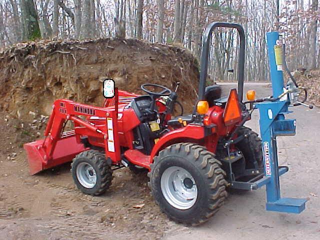

I bought a Wallenstein 3pt. It has long lines that attach to front end loader hyd. works great and is very well built..around $800.00 JohnJ

   / 3pt log splitters, What,s a ggood one? #7
I bought a Wallenstein 3pt as well. It works fine. If I run the tractor at 1500 - 1700 RPM so I can work at a comfortable pace and keep up to the log spitter. I thought of getting a stand alone but didn't want to have one more engine to maintain and service. A couple of my friends have the same unit and are happy with them.

   / 3pt log splitters, What,s a ggood one? #8
The splitter looks great. Do the hoses run to the FEL couplers up front? Yours and another unit on the same string show two variations. A vertical model and a horizontal model. Any comments on which is better? The horizontal model looks slick because you can back the unit right up/into a woodpile and keep the tractor 5' away.
