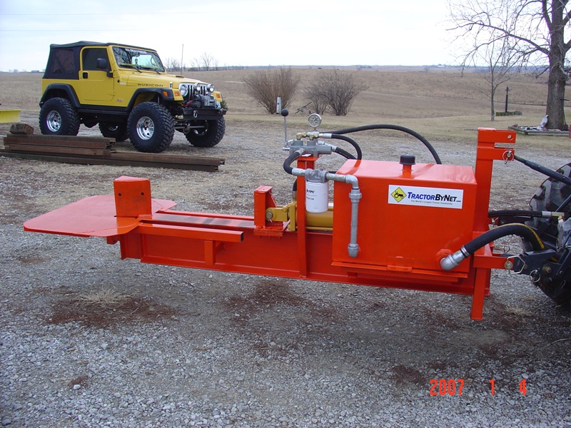

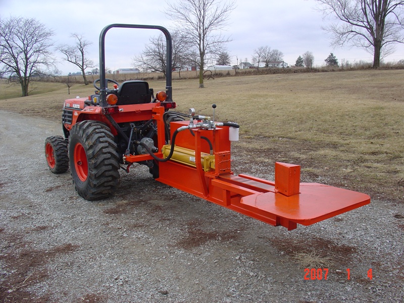

Another option might be a PTO pump and tank. I built one a few years ago using 22 GPM PTO pump. It worked great. I liked the 3pt design but it ties up the tractor when used.
   / 3PT logsplitter #9
That is one nice splitter! I like the table!
   / 3PT logsplitter #10
I later added "wings" to the table with 3/8" rod. got tired of split pieces flopping off the table and having to pick them up off the ground. Thanks.
