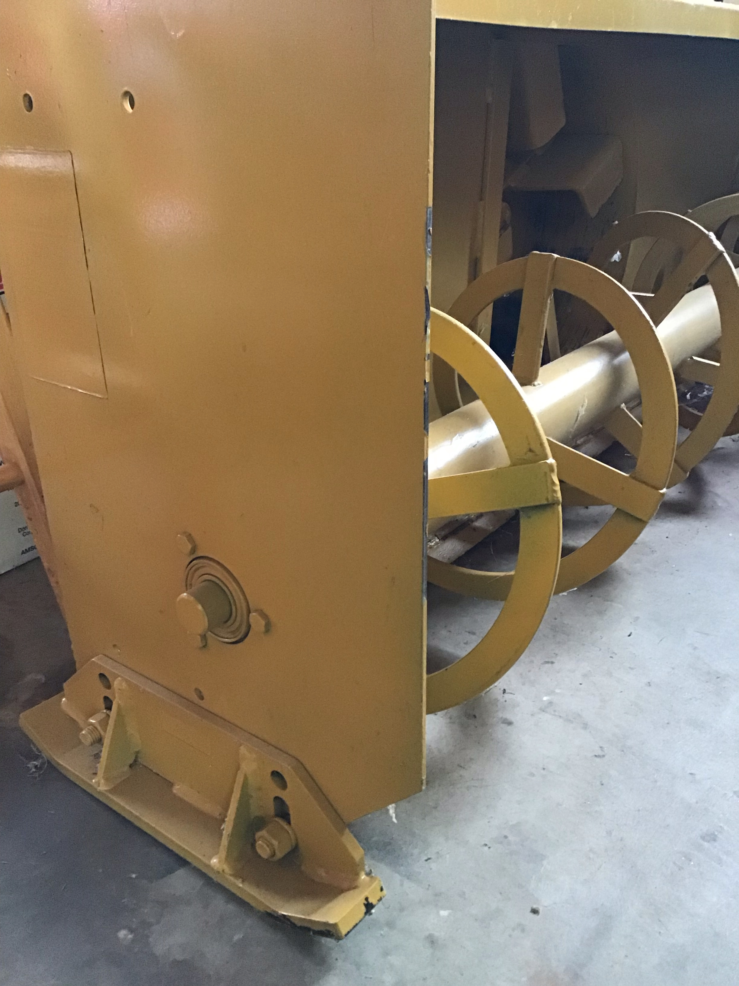

I have a Massey GC1725M. I think this is more general and not related to the make of tractor, but I could be wrong.
When I am using my rear blower and I encounter a rise in the the ground under the blower the blower will be pushed up but only to a point. After this point the arms will not raise further and instead the blower begins to dig into the ground. If it makes any difference I am blowing a stone driveway and areas of my lawn, so the ground is not completely hard and does give a bit. But I don't think this matters because the blower will be pushed up higher in the first place.
I also notice that when I'm attaching the blower what I do is lower the 3pt as low as it can go before backing up to the blower and then I lift the arms up to put the pins in. I can lift them pretty easily to a point and then I see significant resistance to further lifting and I can not lift them any further.
I have my 3pt slow control valve open only 1/4 of a turn to prevent the 450# blower from slamming into the ground when I lower it. I think I can get 2 full turns on it so it is only allowing about 1/8th of the flow that is possible.
I've never really studied how upward pressure from the ground effect 3pt level. I have been was under the impression that there is no downward pressure and that upward force should cause the 3pt to lift. I have actually gotten to the point where the blower is dug in enough that it practically prevents my from backing up and my wheels begin to spin or the tractor bogs down if I try to continue pushing, so I know there is a significant amount of pressure that is being applied that should force the blower higher.
Can the slow control valve being restricted prevent the blower from pushing the 3pt up when it encounters a large rise in ground level or is this just how the 3pt works, that is only allowing it to rise a set amount from where it is set?

After my post I went outside and got to know the 3PT a little better. There is nothing preventing the blower from pushing the 3 point arms up other that the weight of the blower causing it to dig into rises in the ground rather than push it up into the air.
I did get a better set of skid shoes but I switched back to the original ones because I could not get the blower low enough with the new one and I need to make some minor modification to the flared flange on the end of the blower what I was hoping to wait on until it was a little warmer. I'll have to deal with this issue for a while or I'll have to suck it up and do the work that needs to be done in the cold...

Got it. Shortening the toplink may help, or larger shoes as you plan. I put larger shoes on my blower, as the OEM shoes were not much larger than small walk behind blower shoes. I ordered a set of shoes for a much larger blower and bolted them onto the side of the housing.
   / 3PT Operation Question #9
Those are the larger shoes? Gosh, I use shoes at least twice that size on rear implements. Sometimes larger.
What Hub2 describes about the 3pt arms becoming harder to lift as they go higher is common to most 3pts - especially noticible with heavy Cat II 3pt arms. When the arms are level, the amount of force you apply by hand is mostly used to lift them up and so hooking them up is easy. But as the arms go farther up, more and more force is used to rotate the arms - leaving less oomph to lift them with. It's just the way the leverage works. Larger shoes will sure help.

I didn't read the post as manually lifting the arms until later. Yes, they do get harder to manhandle.
The OEM shoes for my blower were ridiculously small. I ordered the larger ones based on a marginal parts picture for a much larger blower size and brand. If I were more of a welder I would have made them slightly longer and 4" wide. I should really get better at welding.
