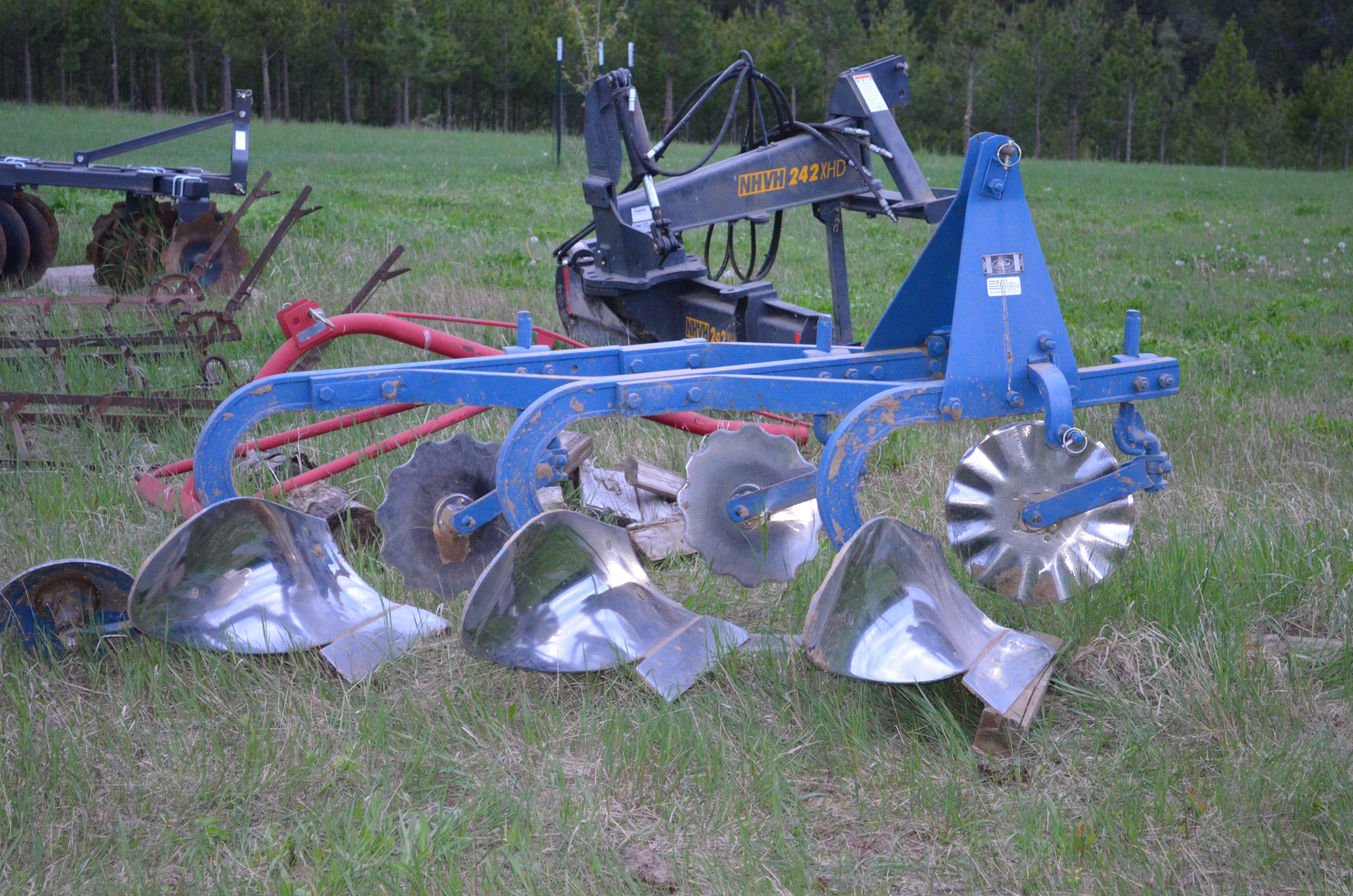

Thanks for input. Went and plowed yesterday. Only about an acre. Sod was a little tough. Should have polished the old plow up. The rust made it stick just a bit. I'll clean up the plow a bit. Need someone to identify this old massey plow as well.

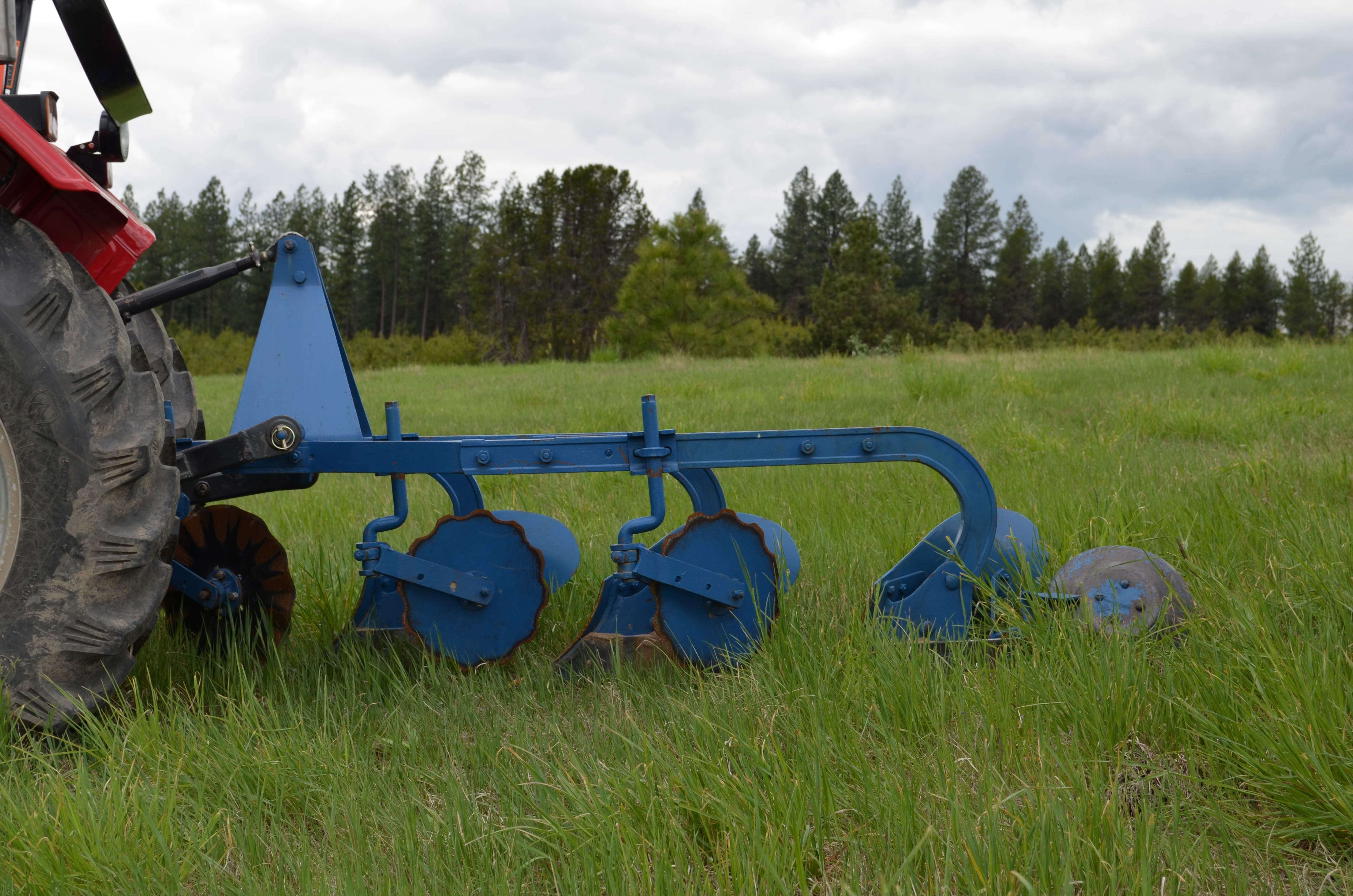

Skyfish,
Here is a photo of my plow and it was all painted blue when I bought it. A plow will scour it's self without you manually laboring to get it to shine.
idaho2

Marine Grease is often recommended for keeping moldboards rust free between work sessions. Marine Grease sacrifices some lube efficiency for increased water resistance.
I spray on a single thin coat of any Rustoleum spray paint. This has worked 100% for me.
