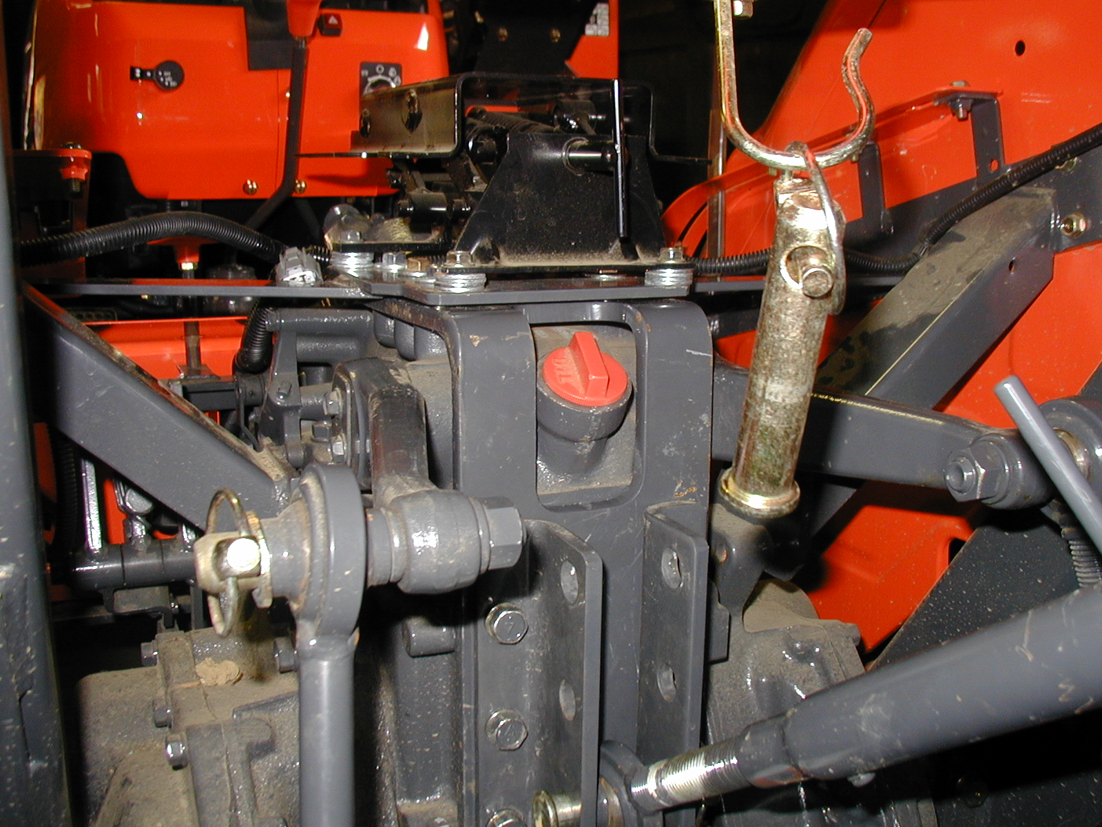

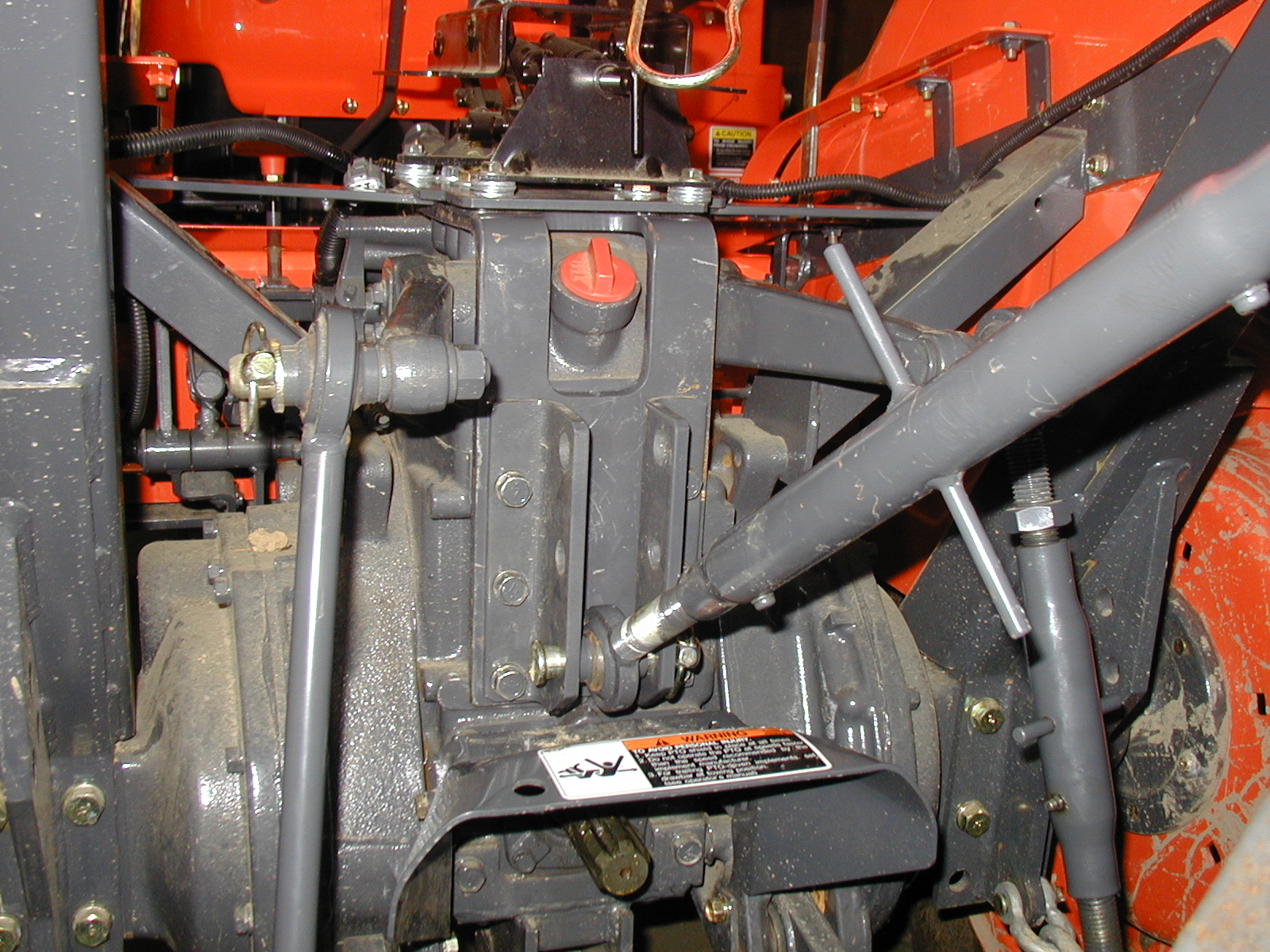

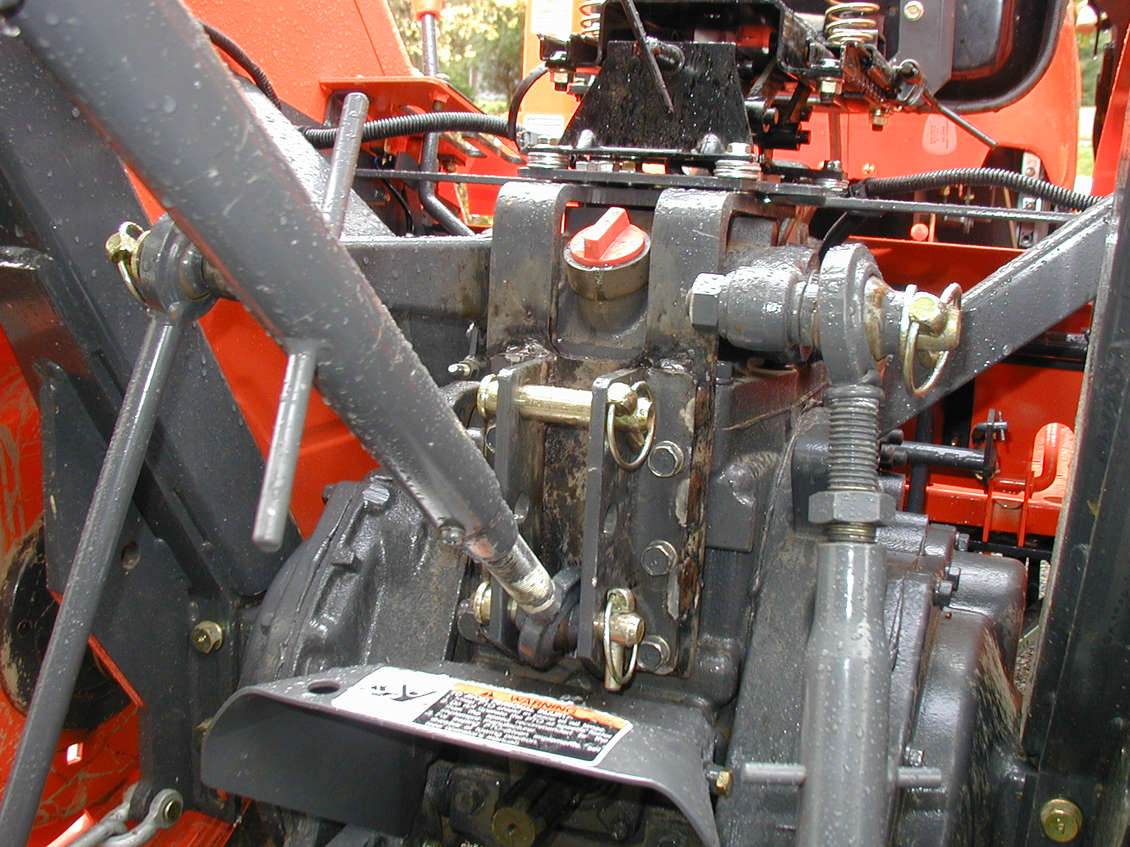

I found this several years ago when pics showed up of tractors having
the top link damaged / housing.
Ask dealer selling backhoe attachment for 4 pt sub frame to make sure
that this is included.
Notice that the top link bracket is welded to the support, so bolt will not pull
through from housing.
Some where I have the part no. for my L3400.
JW5875
