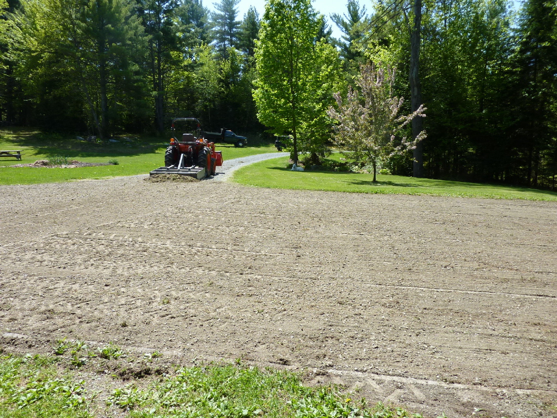

So after months of trying to get my hands on a Land Pride LPGS I finally got my 48'' home today. Eager to try it out, I hooked it up and off I went. It is definitely easier than using my BB to maintain the road...but I think I missed something. When I would use my BB to smooth the road, I would hold the 3pt down to "float" it since I was just trying to smooth it over. Should I still do this with the LPGS? Or should I set it and forget it? If so, where do I determine the height? To me it seemed to be working better if I dropped it all the way down and then lifted it up just a whisker. Also, I am getting windrows, not nearly as bad as with BB but they are still there. As far as road conditions go, dry or damp?? Everything is a little damp right now. Last time I used my BB was in July and the material seemed to move much easier and had a much different look to it. This was the first year in a while that we had the road sanded over winter, so there is some dirt mixed in with it as well. Kinda lost here after reading just about every LPGS post there is on here, I don't think I'm getting the results I should.
Thanks!!

Most of the time running with the 3ph down all the way works best. You may need to adjust the top link to get the best trim between the front and rear blades. Also check to see if it is leveled left to right as this will reduce the skids tracks. Avoid tight turns when attempting finish passes to get the best results.

Maybe I need to adjust top link some then. I was bogging down a little. How about conditions. The druer the better or what?

Damp is okay if not sticky. I prefer slightly damp over dry ground because it holds the shape longer. That said I have had good results with various soil conditions.
LPGS are very handy for smoothing and averaging. I prefer a box blade for leveling and precision grading. I built a 48 inch lpgs several years ago and still use it for tight quarters work on lawn projects. I recently started collecting materials for a new 14ftx8ft lpgs hope to build this late summer.

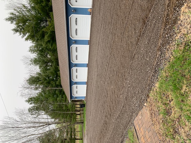

IMG_0257.jpgI lengthened the top link and waited until it got a little wet. I think when my rear blades for it come in it will be a little easier.
