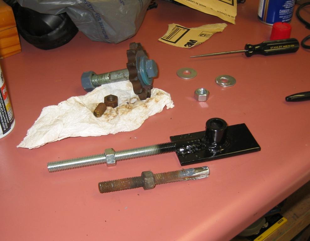

I've been going through my new-to-me Econor 6' 3pt snowblower - it has 4 seasons of use on it. I had to rebuild the tensioner assembly because the adjuster bolt was rusted and seized solid. I made a new adjuster using a sacrificed 8" carriage bolt (pic attached - nifty, eh?). At any rate, I notice that if I twist the auger shaft coming out of the transmission, there is a slight bit of play. It not even enough to see or hear, like shaft play of a fraction of a mm, but I can *feel* the slightest bit of lash when I go back and forth. Is this normal, or should the transmission be absolutely as tight as a drum?
All in all, the blower seems to be in really nice shape, other than a little rust from sitting outside for 5 years. I am a little concerned, however, because the auger chain was completely unadjusted with the tensioner frozen up when I got it - I'm sure that running with slack in the chain beats on everything more than usual, and I can rest assured that it was run that way for a while.
Lastly, I need to lube the chain with something that won't attract sand - what do you think is better for an auger chain - Fluid Film or Motorcycle chain lube?
Thanks - JayC

I like your adjuster - the idler sprocket gets beat up on these things - the chain gets slightly bent and starts chewing on the idler. Agri-supply has them for short money.
