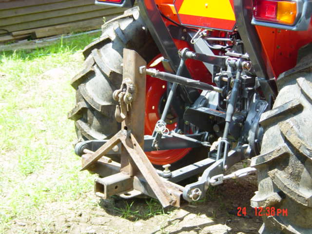

While taking pictures of my top link today I also got a shot of the trailer mover that I made a couple of weeks ago:
http://i43.photobucket.com/albums/e380/Capt-Ron/Tractor/hitch.jpg
Parts in this one are from an engine hoist that I bought from a pawn shop several years ago that was missing the base. Had intended to make the base but bought a new hoist from Harbor Freight for less that the cost to make the base. It is the upright section for the top link. The cross piece is a TSC drawbar with a 1-1/2"X1-1/2" section of 1/4" angle welded to the bottom. A short 2" SQ hitch section to receive the ball mount is welded to the top of the draw bar and the upright is slotted and welded on top of the 2" receiver.
I'm thinking of taking this one step further and adding an articulated boom using the remaining parts of the hoist. BTW, I gave $50 for the hoist and it had a new 6 ton long reach jack with it.

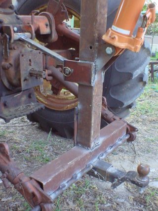

You will get alot of use from that and with added boom even more. I use mine quite often.

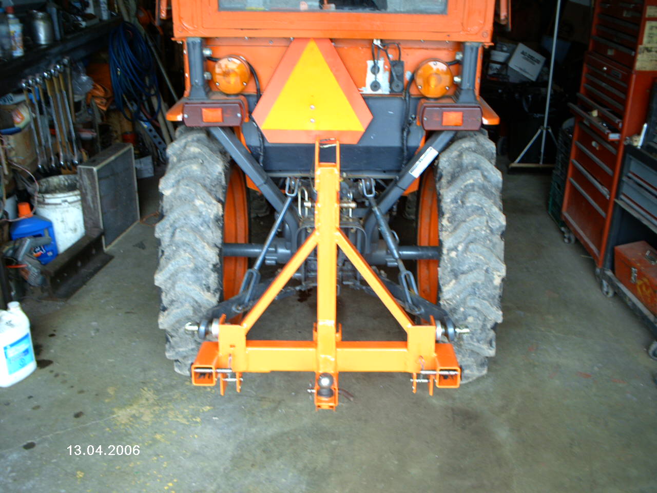

That was the before conversion to 3ph.

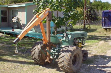

And My version.... I use it to lift logs to skid them out of the woods, move my trailer & my next task.....
I'm making a ballast "rack" that can be used to haul small loads of wood or concrete blocks while I plow this winter. It will just slide into the receiver.
