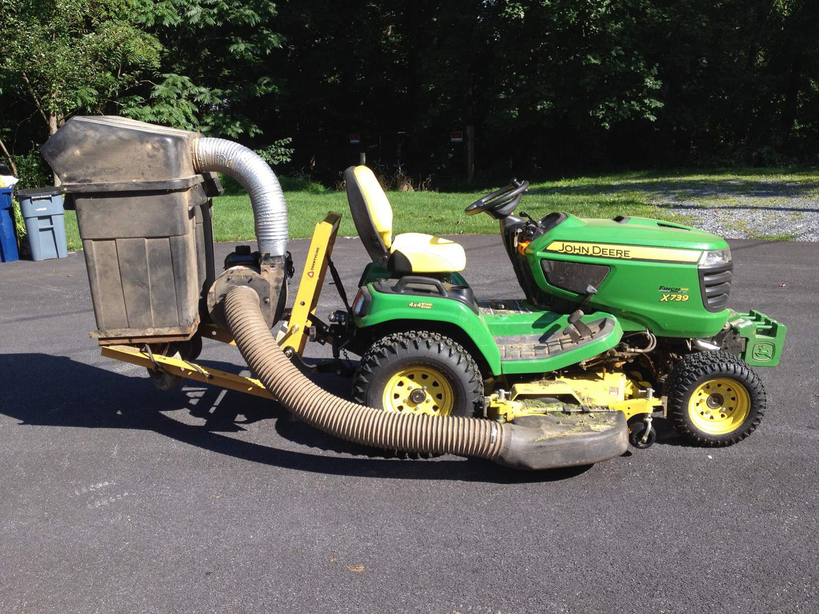

I bought this old Sears vacuum many years back for $30. I used it for about 14 years or so as a tow behind until the motor finally failed. Needless to say I got my $30 worth out of it. I like it because it's small (I don't have huge amounts of leaves) and it fits into tight spaces. But the casters always had a tendency to tear the grass. Now that I have a 3pt hitch on my GT, I decided I wanted a 3pt hitch vacuum. Looked at new ones, but at $2K to $6K, I just couldn't justify it. I then decided to convert the old Sears vacuum to 3pt so that the wheels don't touch the ground when in use. Attached is what I ended up with.
It's a bit of a contraption, but I have a pretty descent vacuum that's easy to haul around for about $330 (motor and carry-all). Ugly, but for $2G's I'll put up with ugly.
New Motor change was easy, once you determine what is compatible. Love the heavy steel impeller in this old sears too.

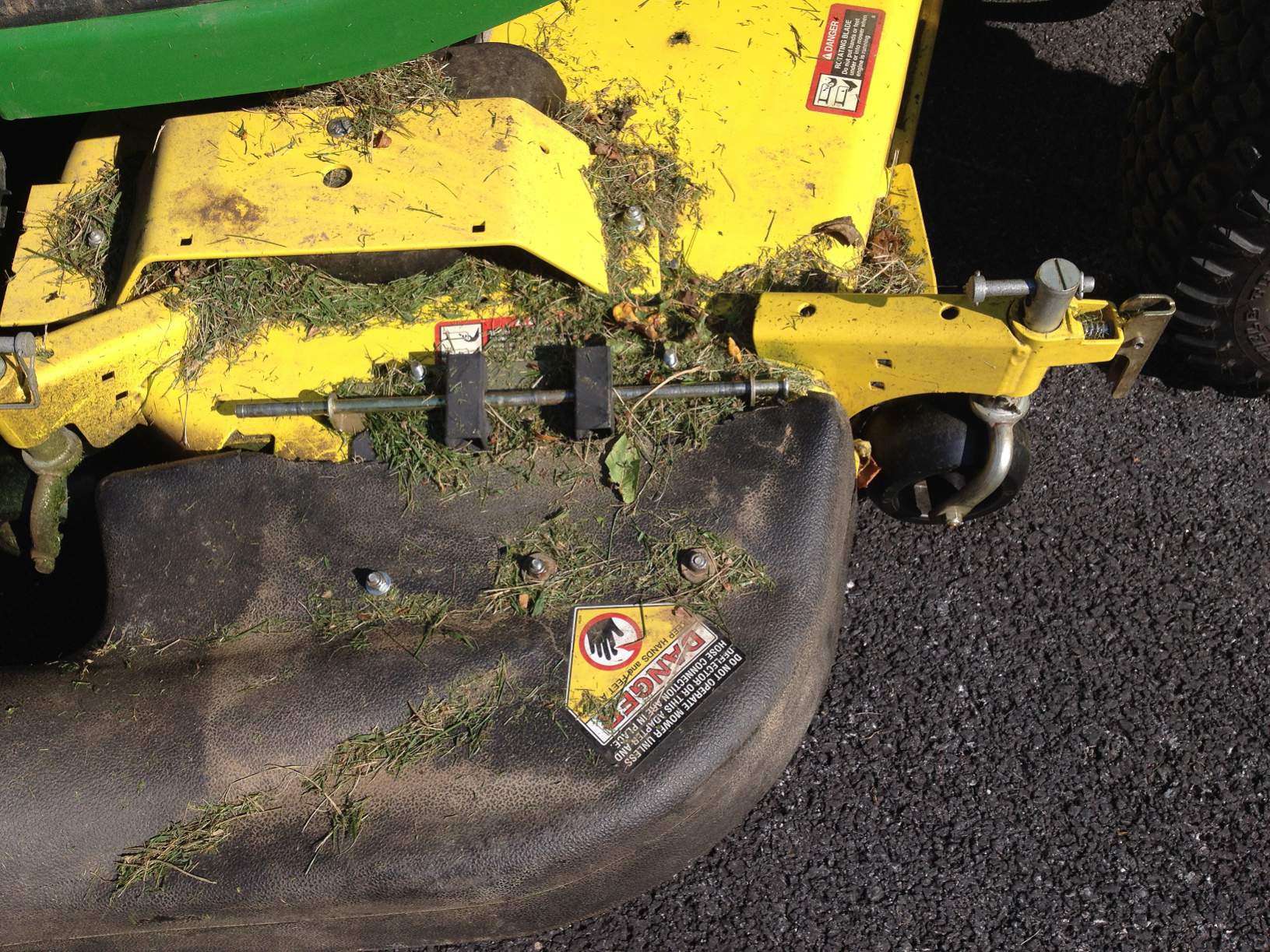

For the chute adapter, I drilled holes in some square tubing and welded to a plate. Then bolted the plate inside my old chute adapter. I used the pin from the original deflector. Fits perfectly. Glad I didn't have to buy a new adapter.

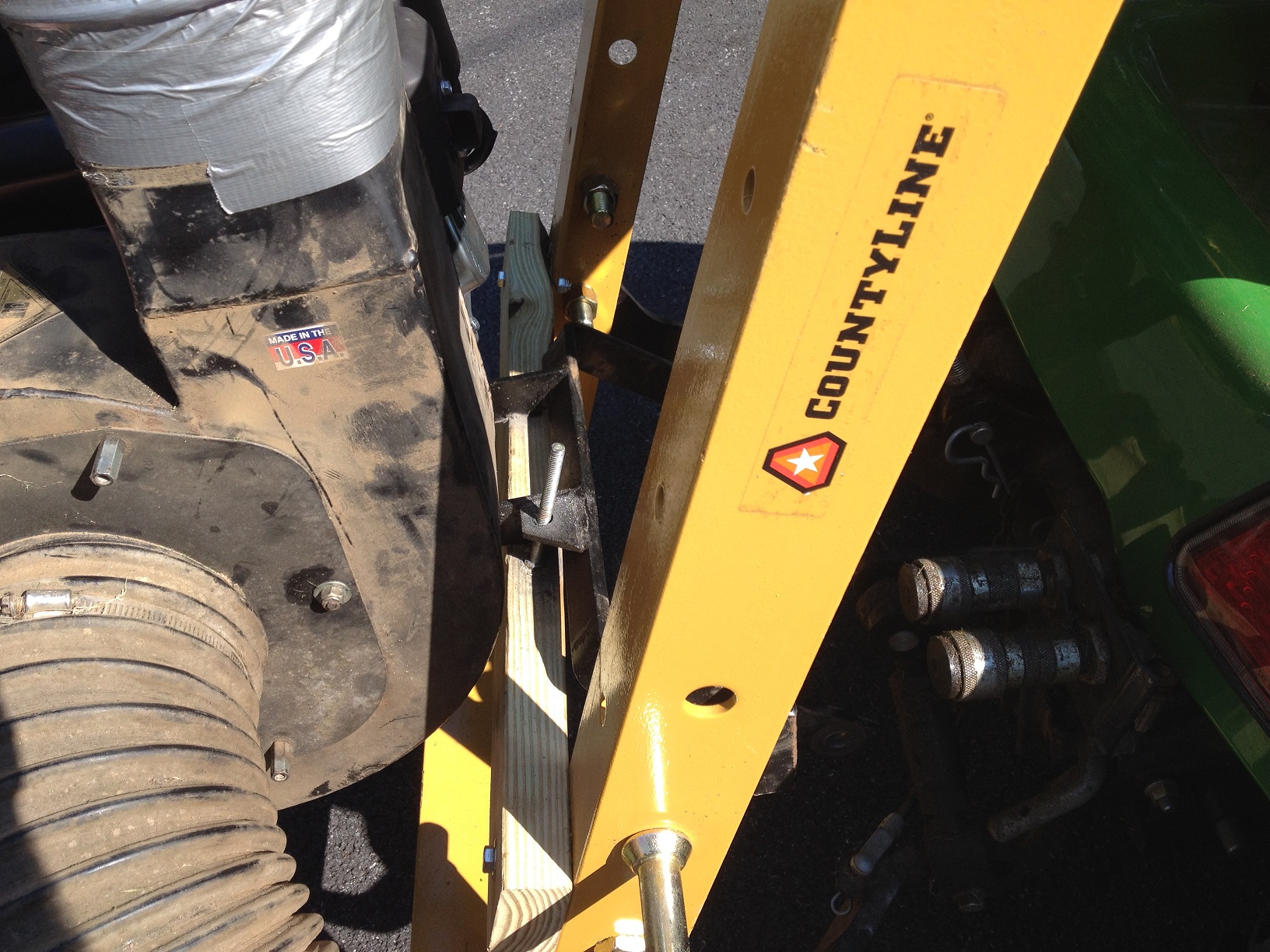

Getting the carry-all to work was quite the chore. I wanted to be able to keep the original vacuum intact, and be able to use the carry-all for other purposes. Keeping the casters on the vacuum makes it easy to move around too. To get everything high enough off the ground so as to avoid digging in on slopes and the like (GT doesn't lift very high), I added a second set of 3-pt mounts as low as I could get them on the carry-all. This worked great. To mount the vacuum I attached some all-thread to a 2x4 on the carry-all and drilled a hole in the fixed hitch of the vacuum. I simply lift the vacuum onto the stud and it stays in place and is pretty level too. The angle and forward leaning nature of the vacuum keep it rock solid.

We had a dealer with the simplicity line of lawn mowers back in the 70's that sold most of his tractors with a set up like yours. When he passed he gave the hardware store to his employees cause they made the buisness what it was. Picked up a bunch of leaves and the lawns always looked freshly mowed.
   / 3pt vacuum rig
The vacuum is a 1993 model. The fixed hitch worked OK, but the casters would catch when turning on hills and such. I have always used with an AWS tractor. The tight turning might have contributed to the wheels dragging. They pivot freely; so that is the only explanation I have for it. Maybe a different tire design that doesn't have such a sharp transition from tread to sidewall would've helped. Anyway, I really like not having it on the ground at all :)
   / 3pt vacuum rig #4
Like the ingenuity, especially since you can use the carry-all for other purposes. Good job!
