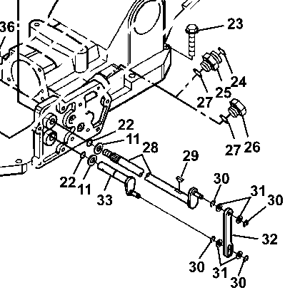

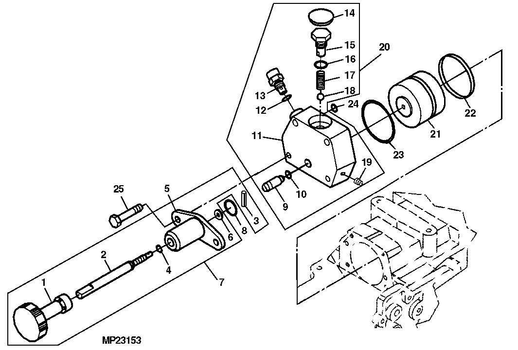

Stopped by the dealer. They suggest 2 things... there is a pin in the knob that controls the up/down [Part #3 in the Cylinder Head picture]
(it was fine), there is woodruff (sp) key on the shaft that in the cover on the left side that contains the valve so if you move the lever the valve will not open [Part #29 in the small picture](it was fine and the valve moved). Next I checked the hyd line that feeds the valve as suggested in the prior post. I didn't find any screen or filter. I did start up the tractor and hyd fluid came out the line. I wasn't able to undo the fitting (don't have the right wrench). So, now I am a bit stuck... You can't fix the valve (you have to replace it) but I don't want to do that until I can show it doesn't work. Somewhere, I read that the check valve [Part #13 in the Cylinder Head Picture] might be open. I am off to see if I can find a wrench to remove it. I figure if I don't see fluid out of the relief valve then the valve must not be working.
