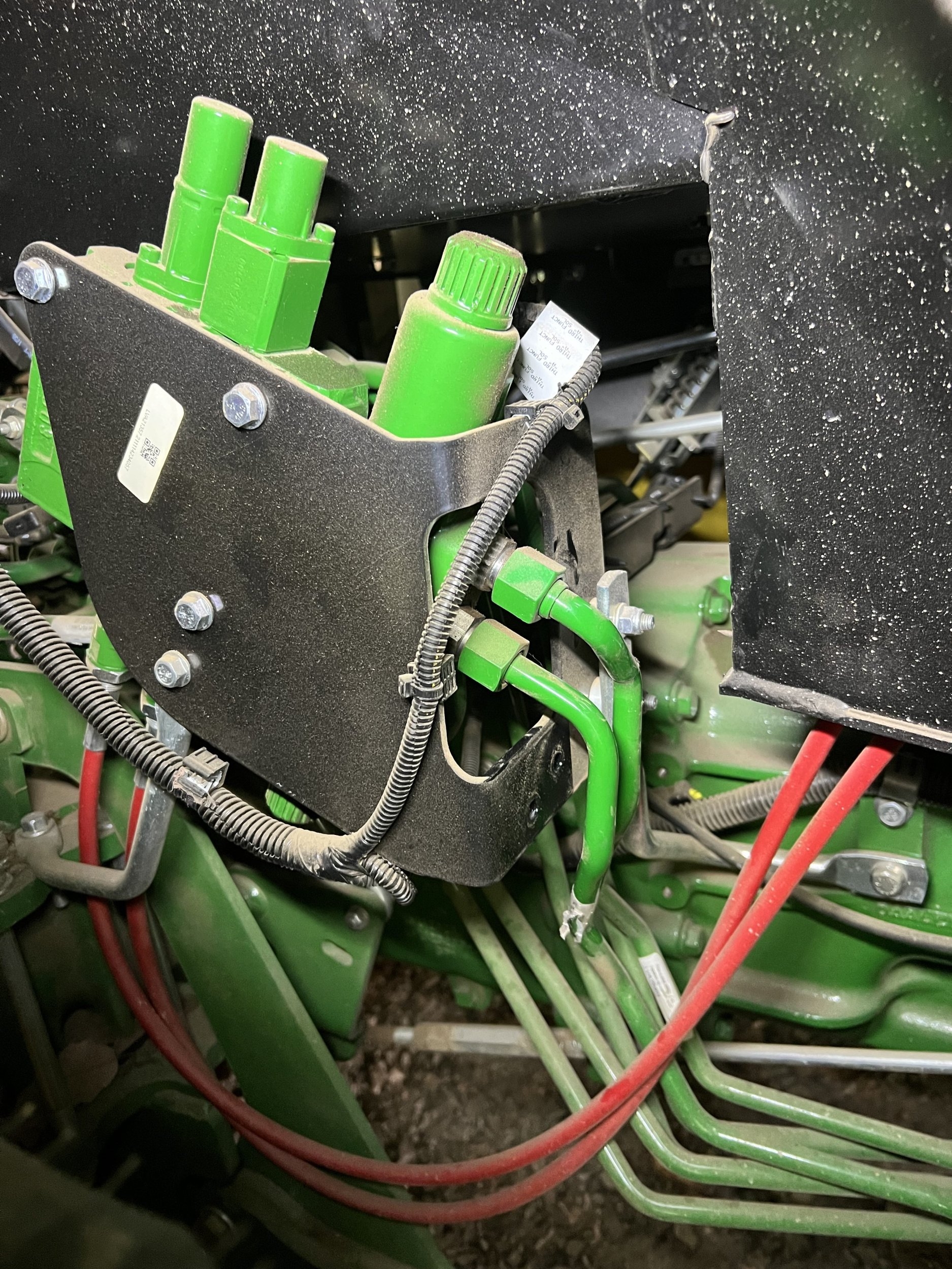

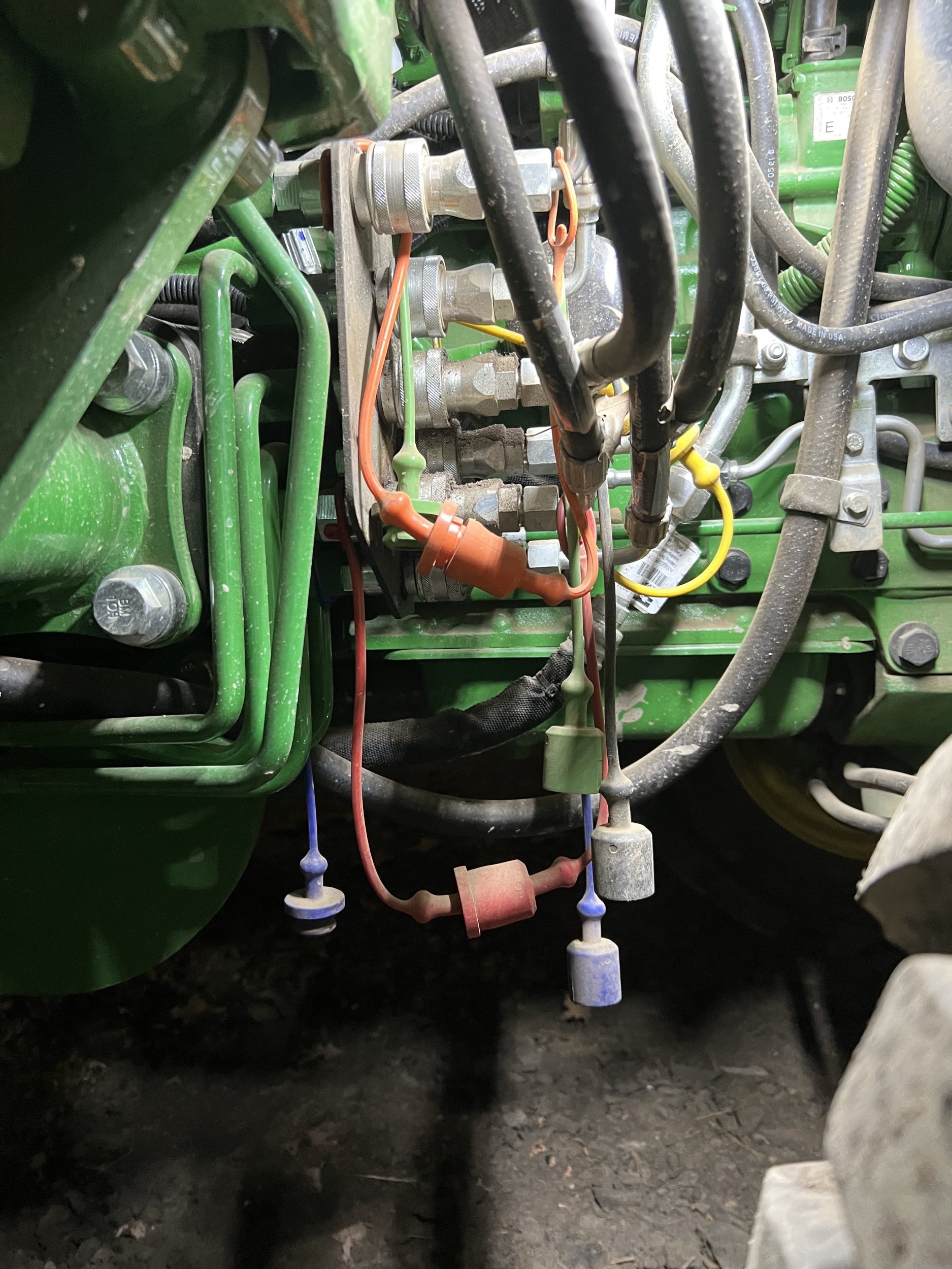

I have a John Deere 4052R that has the Power Beyond Kit and the 3rd SCV running to the front to run a grapple. I'm trying to run lines to the rear for the 4th and 5th SCV (kit BLV10045), but the instructions don't seem to take into account the Power Beyond and 3rd SCV to the front. Lines to the front are already connected where the kit I purchased says to hook things up. Can anyone provide guidance? Thank you!
