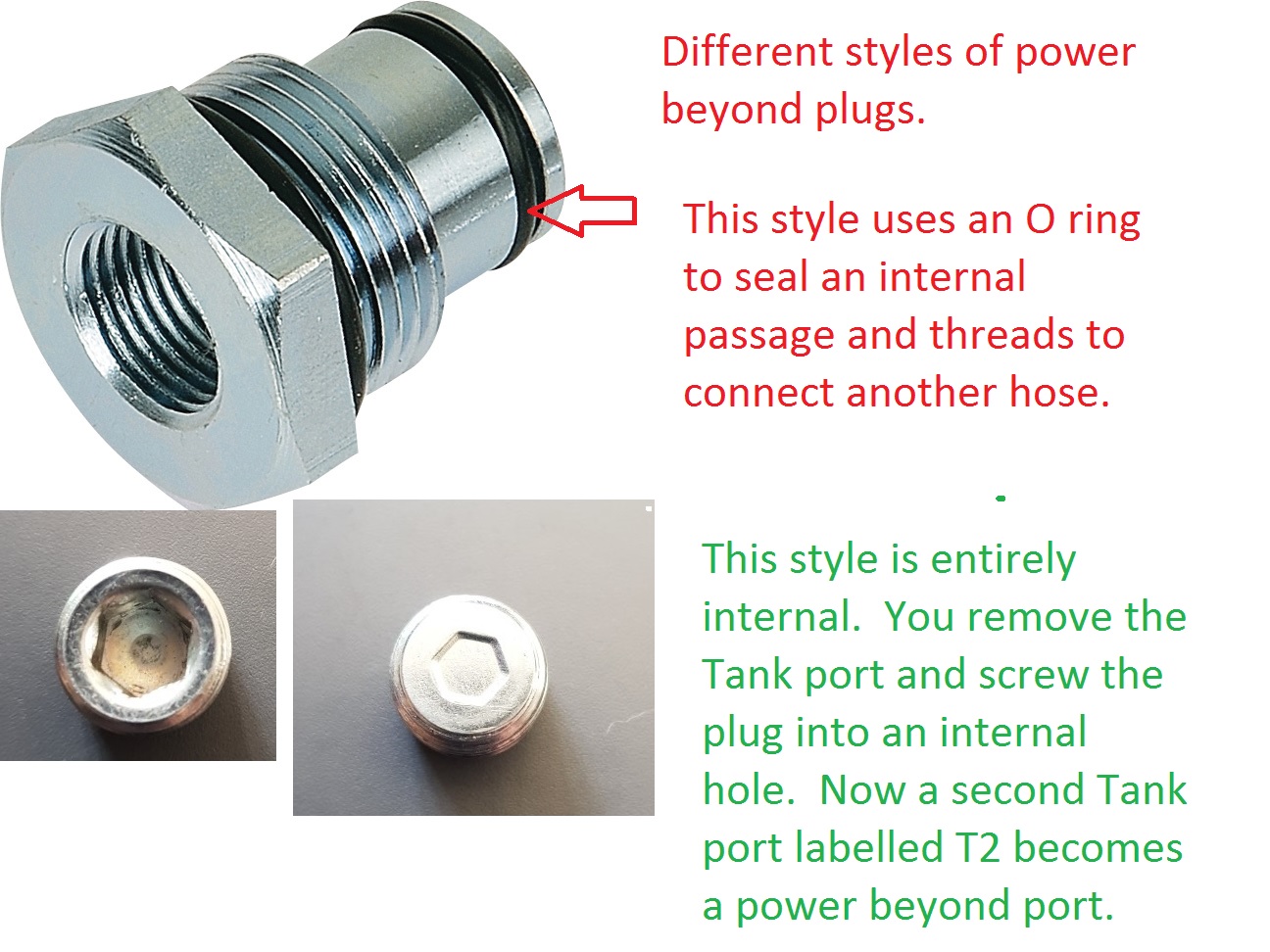

I havev a Massey 4243, 4x4, with 1038 loader. I'm trying to add a 3rd function to it. I'm trying to run a Danuser T3 post driver. I'm looking at a Summit kit to accomplish this.
The tractor has a NIMCO valve body mounted near the loader. I'm not terribly sure which line to plumb into it. I think its the return line. Going into port marked P2.
Regardless, I'd love some input on how to accomplish this in the most practical way. If there is a different kit then I'm all ears. Just need the guidance I know resides here. Thank you in advance!

6 lines. Supply, return, 4 to current loader function. There are, what appears, to be 4 open ports on the under side. Looks like plugs in them. So picture 2 rows of 4 with supply on one side and return on the other.
   / 3rd function add to Massey 4243 #5
To have an additional hydraulic circuit/valve you need your loader valve to have a power beyond feature. Valves with 7 lines already have the power beyond feature.
Often it is a cheap option consisting of a plug or sleeve that goes in the body of the FEL valve.
I suggest you try and find a model number on your valve and then contact a NIMCO distributor to see if PB can be added.
If it can then the PB line would feed another valve supplying a rear remote.
Dave M7040
