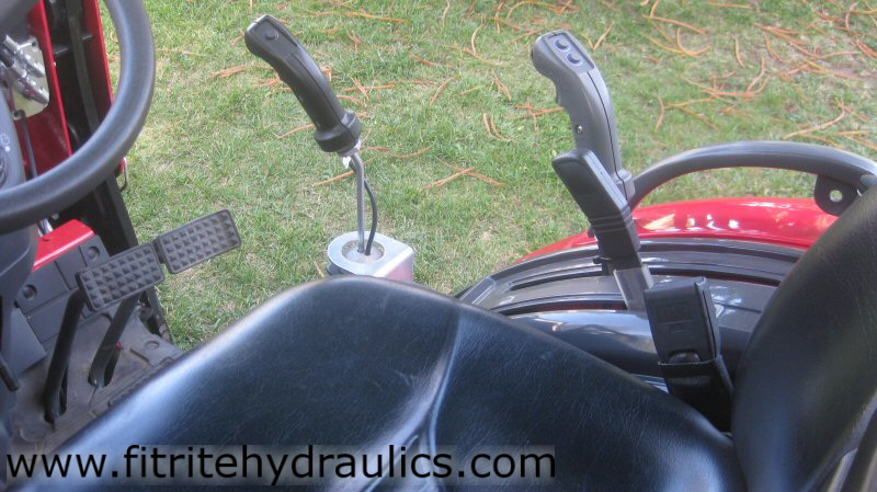

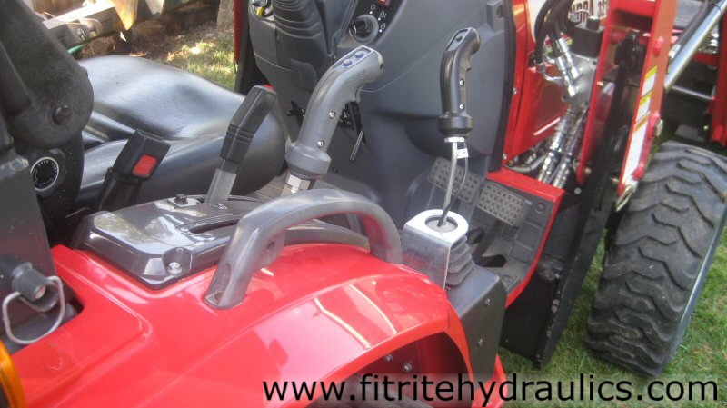

$535 for a diverter kit and $570 for a true 3rd function. Take a look here to see if you will like this control grip. Email me if your interested. ;)

In my pics, the grip for the rear remotes has 2 buttons and a trigger. There are 3 diverter valves to operate. The trigger operates one of the diverter valves. If you go with a diverter setup, the grip will have a single button, or just the trigger. If you go with the true 3rd function, then there will be 2 buttons. ;)
