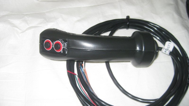

I would like to see some 3rd function handles pics, and if I use a DA valve I guess I need a rocker switch? Or 2 switches, one to close and one to open... The cost plus the hunt for handles is irritating... Any ideas or pics would be helpful...
   / 3rd function handle #2
Single switch grip runs $165. Double switch grip runs $200. That includes bushing rod adaptor and 10' of wire.

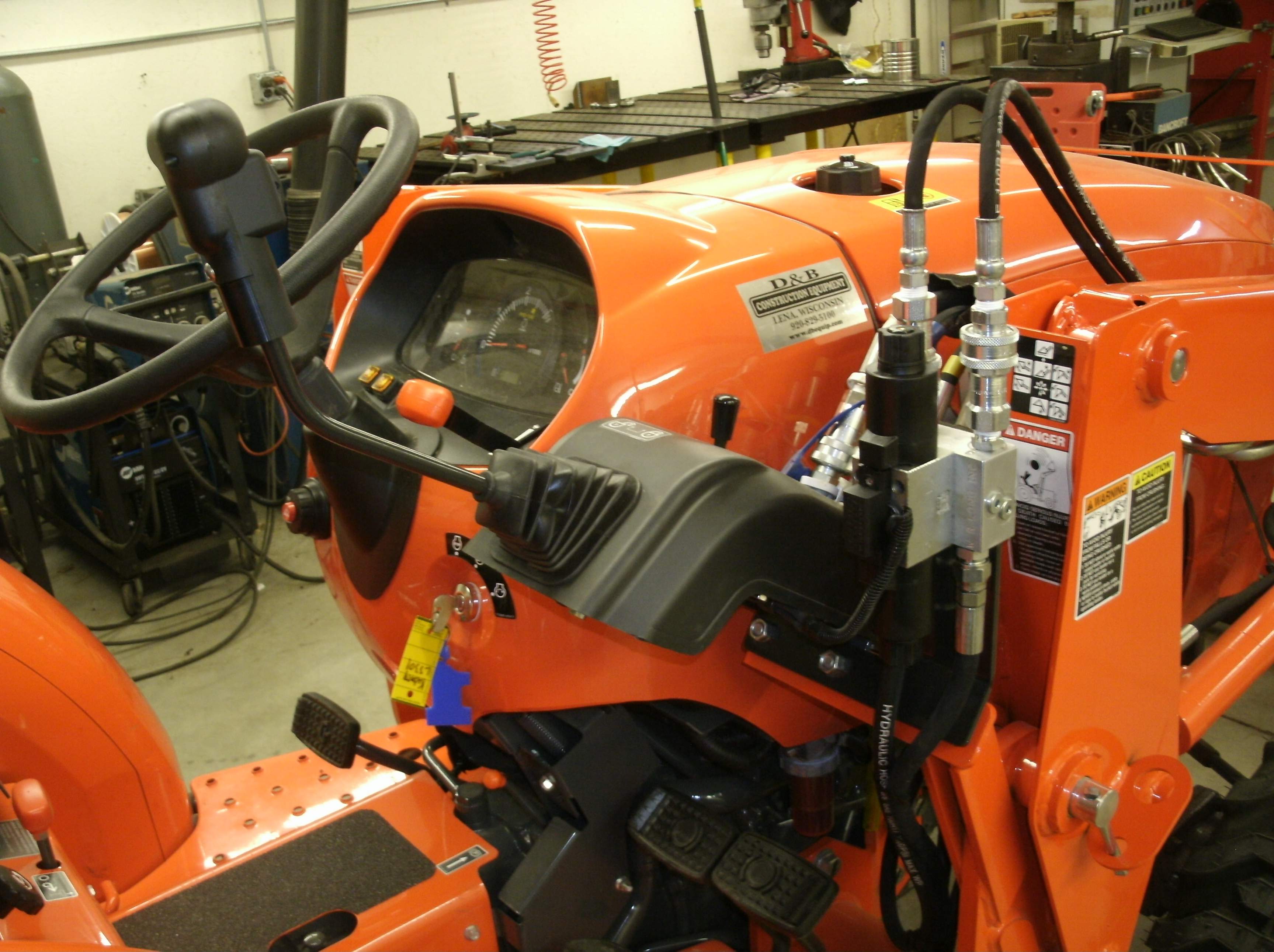

   / 3rd function handle #3
Here's what I made for my tractor. Kit came with a rocker switch, which I really like.

   / 3rd function handle #4
I went the John Deer route and bought all the parts for the grip assembly "piece mill" and put it together myself.
Here's the write-up of my entire 3rd function project. Has pictures, links to parts lists and prices.
http://www.tractorbynet.com/forums/customization/358086-kioti-ck-35-3rd-function.html
The one issue w/ the JD solution is the buttons are not made for the current draw a solenoid will pull and you'll have to put some type of relays in the mix. Not a real big deal but another thing to tackle.
As a side note I put about 8-10 hours on this weekend doing nothing but loader/grapple and landscape rake work and I absolutely love this grip. Fit, feel, and function are great.
