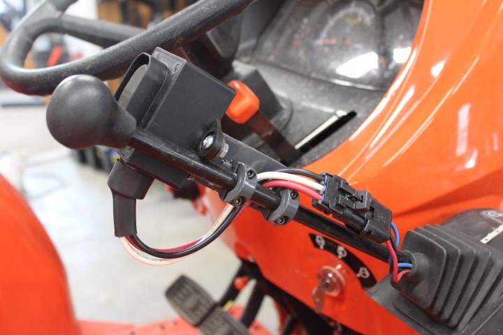

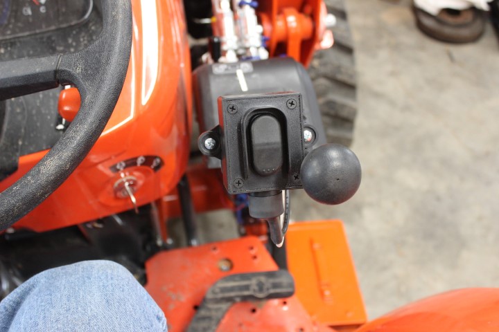

I bought all the pieces to the John Deer grip for my build.
Some (like myself) put relays between the control grip & the solenoid and others have used it without and report no problems. Choice is yours.
My personal implementation of relays was probably a little over kill for most folks but I'm a techno-nerd sometimes and it seemed like the thing to do at the time.
All the parts & part numbers should be in my write-up.

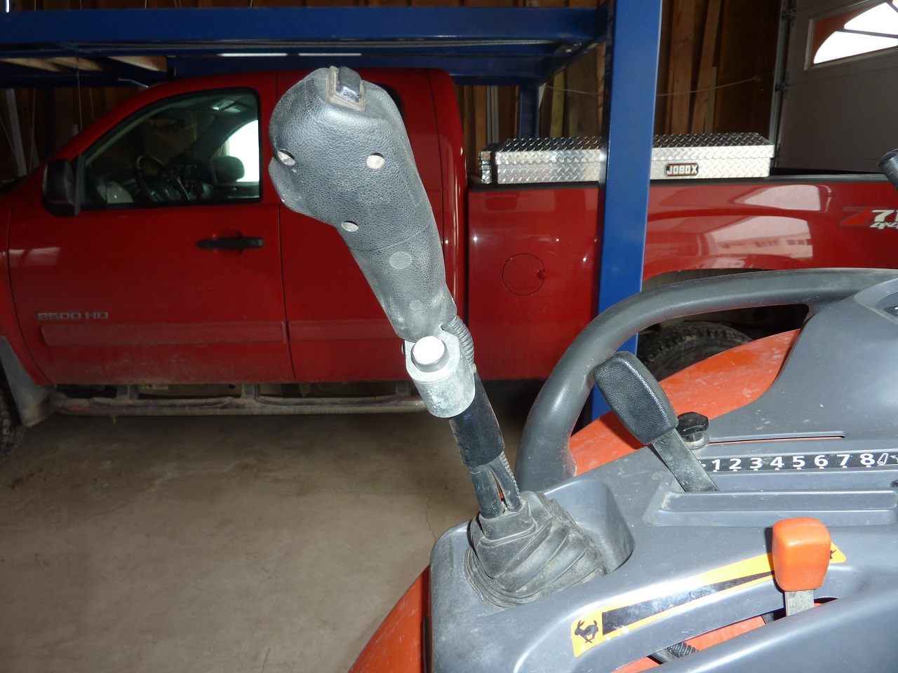

Going to try moulding a micro switch into existing loader knob. Black urethane adhesive (Sticks anything to anything and dries like rubber). I'll run wires down the lever. Use a solenoid if needed. Hopefully look OEM.

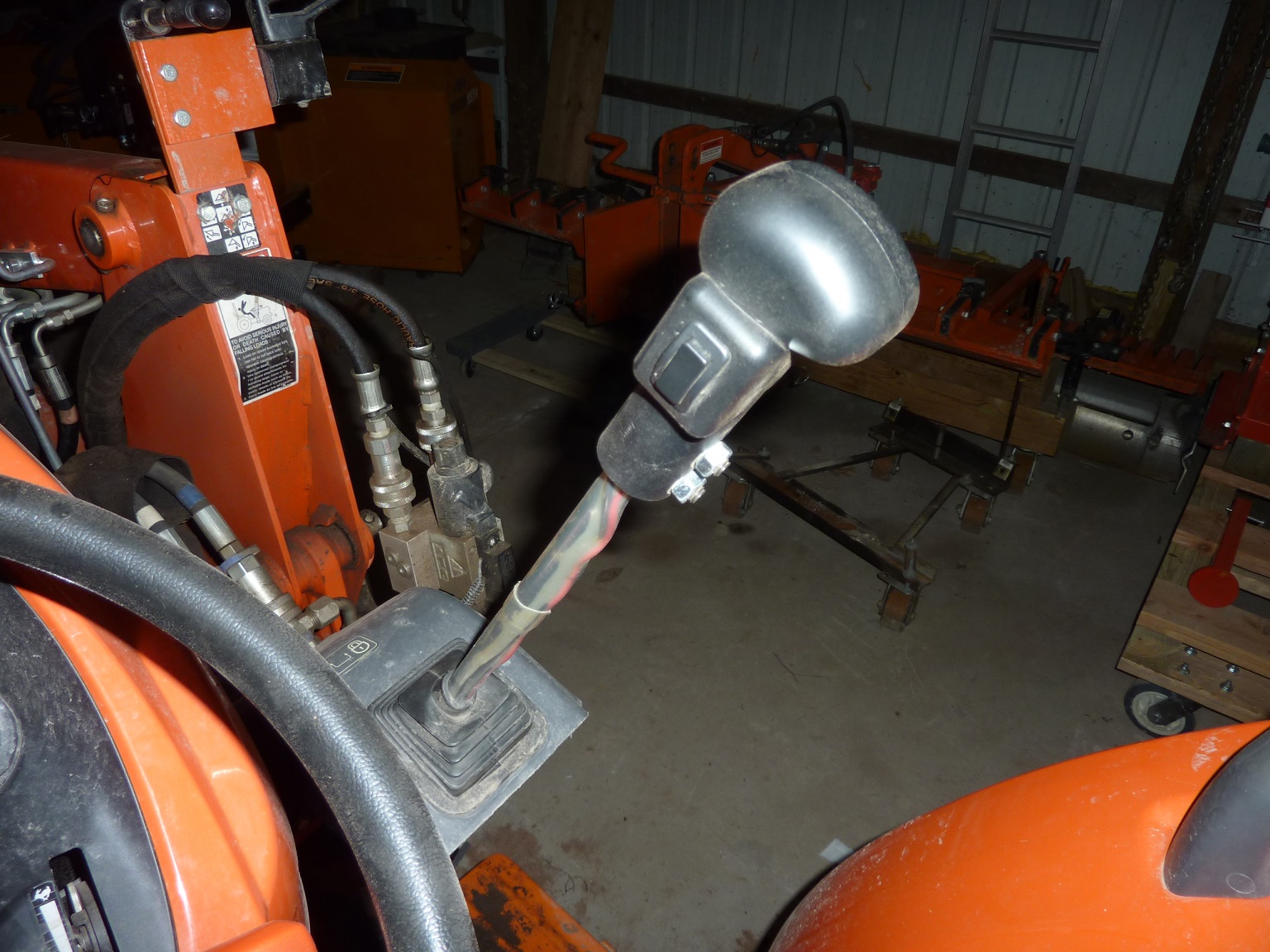

The W&R Long 3rd function kit for my Kubota L6060 came with a replacement joystick knob. It has a rocker switch and an unused push button switch molded in. The illuminated on/off switch is mounter on the shaft.
The W&R Long kit for my Kubota MX5800 is similar with shrink tubing holding the wires against the joystick.
Both work well and have a solid feel. They should be available from W&R Long as replacement parts.

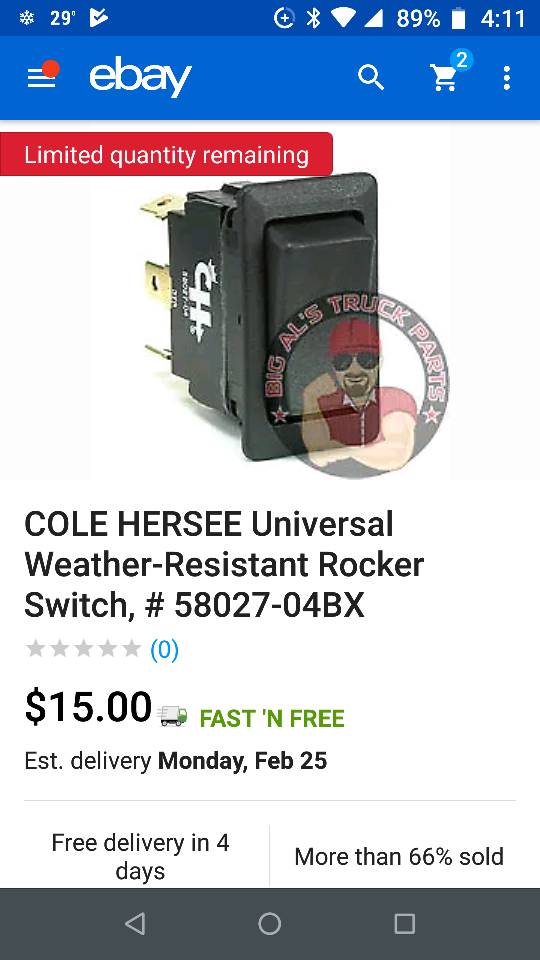

They have them but $$$. I'm going to make my switched knob for backhoe joystick. I'd like to keep them looking the same. Loader switched knob will come in the kit. Summit Hydraulics. $339. For up to 13gpm. Hope I'm not making mistake buying less $$$ components. WR long is 2x price. Screenshot_20190220-161153.jpeg

I went with a switch on the side of my joystick. Thread here: https://www.tractorbynet.com/forums/hydraulics/408000-diy-kubota-3rd-function-mx4800.html?highlight=
I looked at the ATV gearshift handle and didn't want to risk it not fitting well. If also is not waterproof. The Polaris shift shaft is not just a plain round shaft.
I did the same and did a write up on it for my Bobcat. Has workes flawlessly and is very easy on the hands
