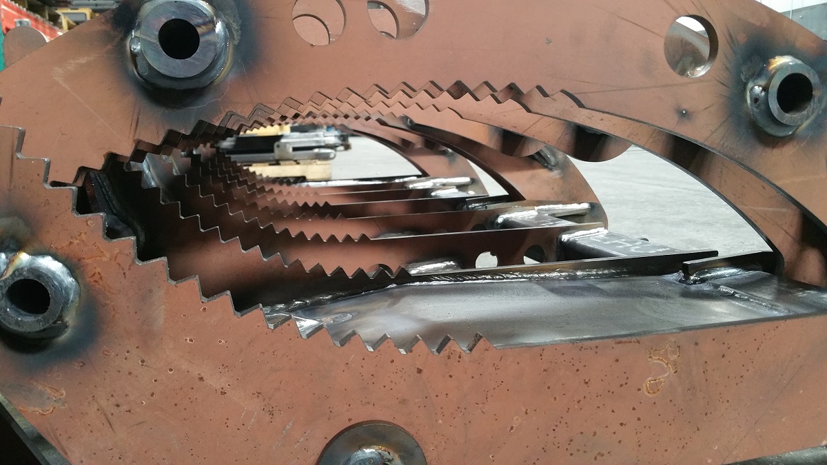

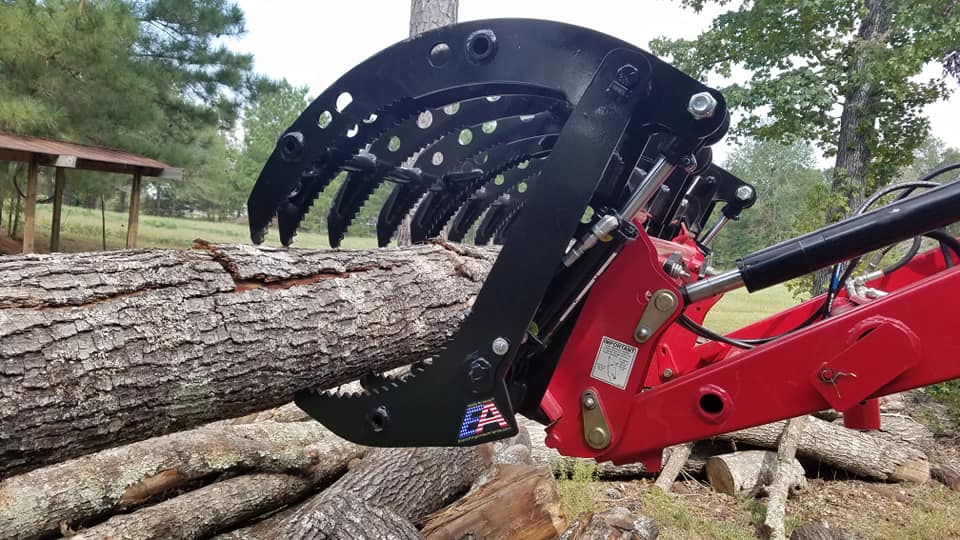

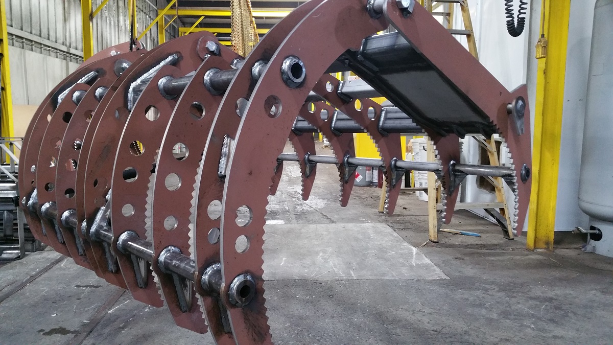

We've sold several custom WR Long true 3rd function kits for YT359 tractors and the install, according to most, is a piece of cake! There are over 300 customer reviews and a few videos at the link above.
This video shows how easy the install is. It's a Kubota, but the basic concept of installation is the same.
The price is $837 and you get $50 off when you order with the best grapple to ever touch a YT359. 400 pound Wicked 60.

Did not realize I had not posted here I did buy Everything Attachment and very pleased with it. Ended up with Kubota tractor and not Yanmar. One thing I am yet going to do to the EA grapple is protect the tractor by using heavy expanded metal to prevent limb coming through the EA grapple. It is very open and they say to allow best vision which I fully agree it gives. HOWEVER, my was very fortunate to not damage the radiator and coolers right behind the grill as I had a limb some through the grapple. Did have grill made for my tractor to prevent it happening again but the grill is issue on checking engine fluids.
Limbs and small trees can be pulled into the back of the grapple and through it with both driving into that material and the closing of the grapple itself.
Grapple is great! EA was very good to work with.
