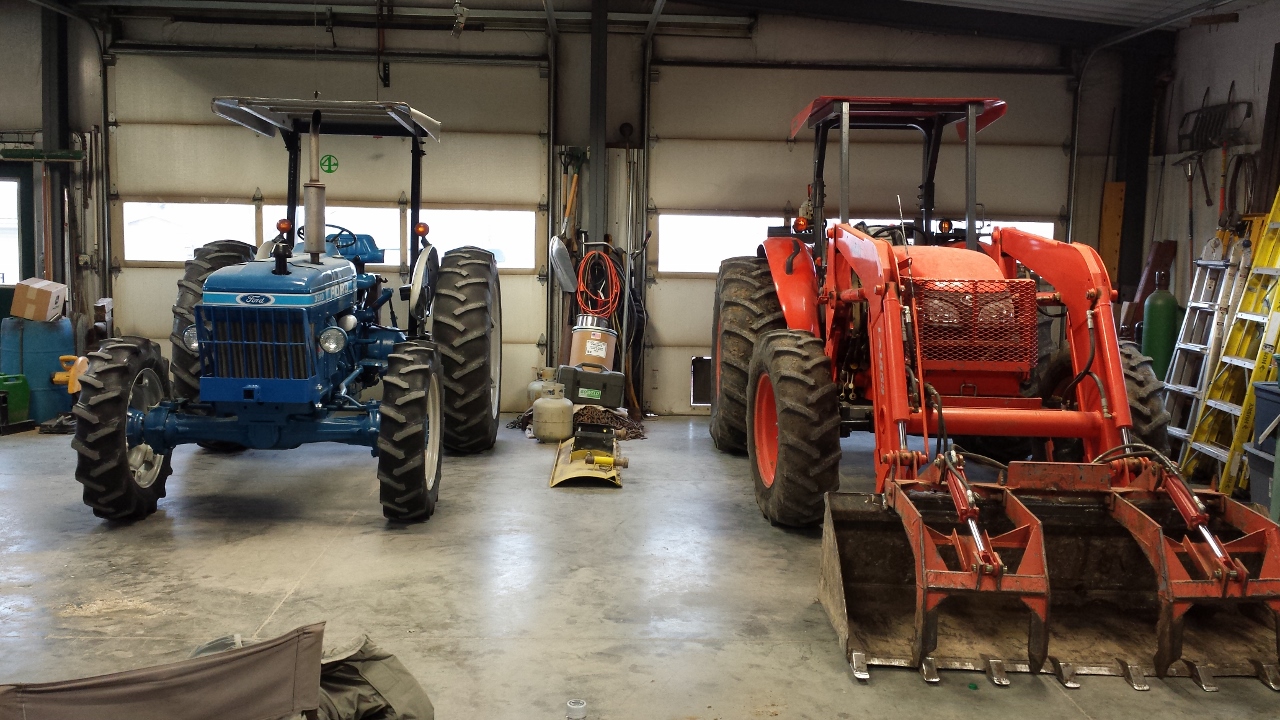

The hose length is critical. Takes wayyyyy more hose than it appears when rolling the Grapple forward (dump position).
The hose ends on my Grapple are in the center, high on the Grapple structure. My tractor couplers are on top of the FEL cross tube toward the right side.
My hoses are "just" long enough to allow the Grapple to dump completely. When the Grapple is sitting on the ground flat my hoses are just touching the ground.
The farther you place the tractor couplers from the Grapple connections the more hose you are going to have to deal with in various positions.
Sorry I don't have better pics that I can find. This pic shows the location of my tractor couplers.

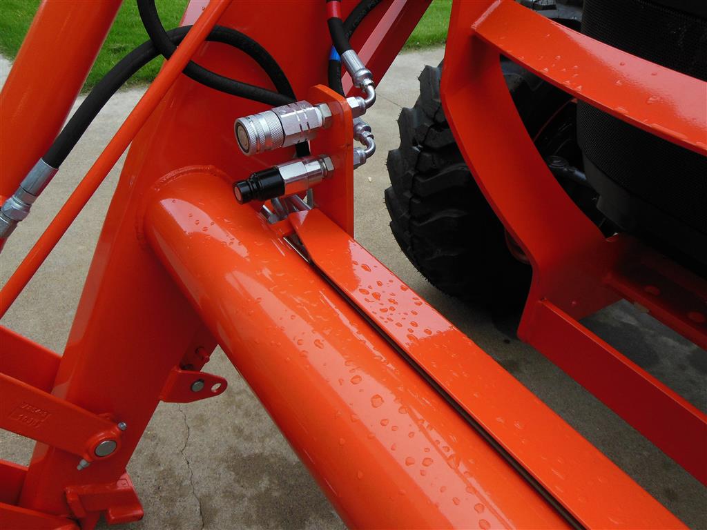

   / 3rd function/remote ? #8

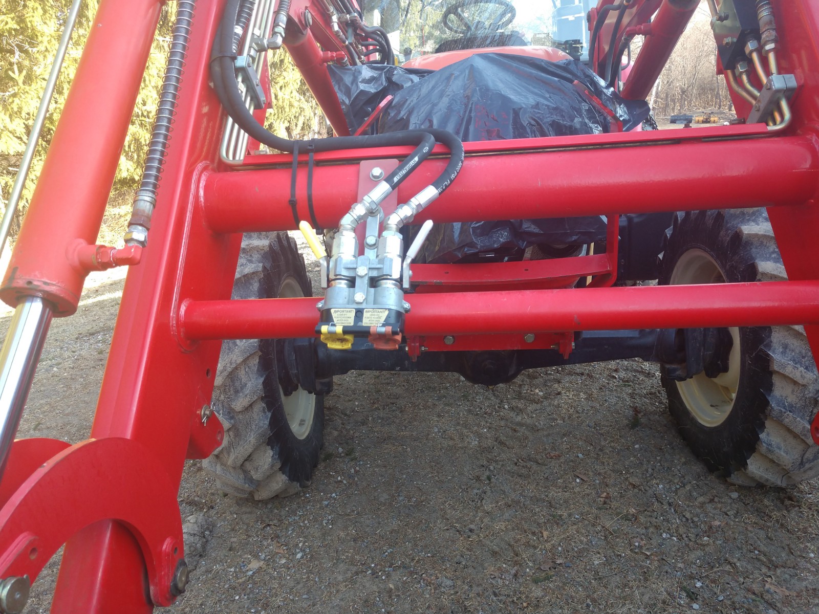

This is were I have mine mounted;

If they are pointed down roughly parallel to the loader arms like LouNY did, then when the grapple is curled down the hoses run more or less straight towards the grapple.
I originally had mine closer to perpendicular to the loader arms. That was great until I curled the grapple down. I had to make another bracket that went closer to parallel.
