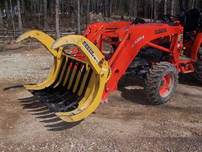

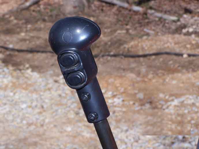

I have Kubota's 3rd function kit on my L3240.
Two non-locking pushbutton switches control opening and closing of my grapple claw.
Like JMC says, you can tap the switch to walk the claw shut/open, and you can vary the speed on the claw action by raising or lowering the RPMs on you engine.
