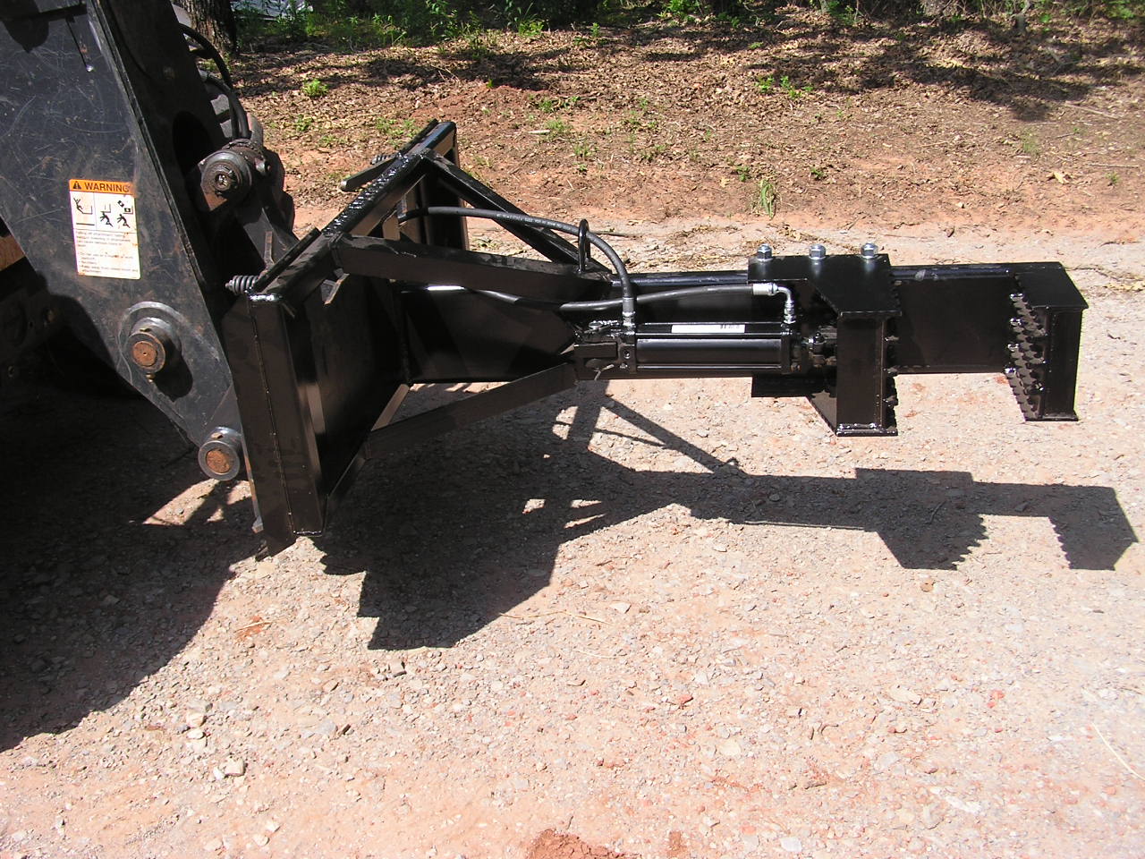

The Long Arm Tree puller and a 7' brush hog:
