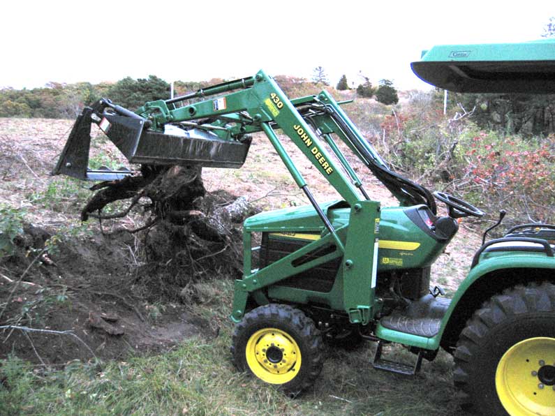

I wouldn't be without it! The FEL is on almost all the time, and there isn't a day that goes by it seems without using it. Attached is a picture worth a thousand words.

Still great, and use it all the time to scrape, pick up small piles of brush/logs/dirt/gravel, etc. (though I admit a grapple would be better for brush and logs).
